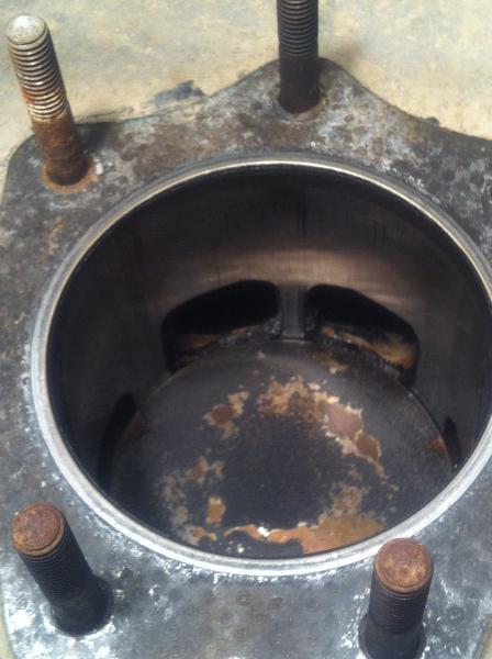

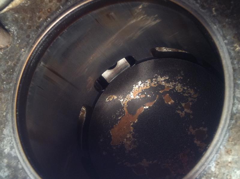

Removed the cylinder head and here are the pictures.
Are the rings gone? piston around didnt show anything moving and looking through exhaust, only the top is burnt

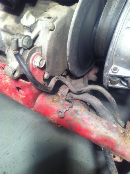

Also picture of a wire not connected? whats this for?
Lower intake boot had gas in and around that area...?
Measured bore with my vernier its almost 3.215 - 3.225 if so damn them cause I don't have much piston choice left, but I'll buy a feeler gauge to be more precise.
Now... What do I have to do? I was hoping to enjoy this for a month cause Im leaving for the summer till aug.

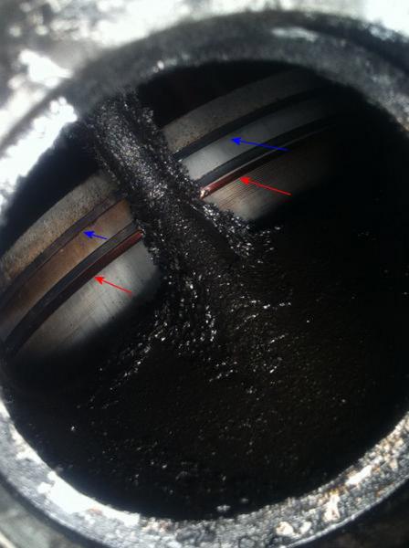

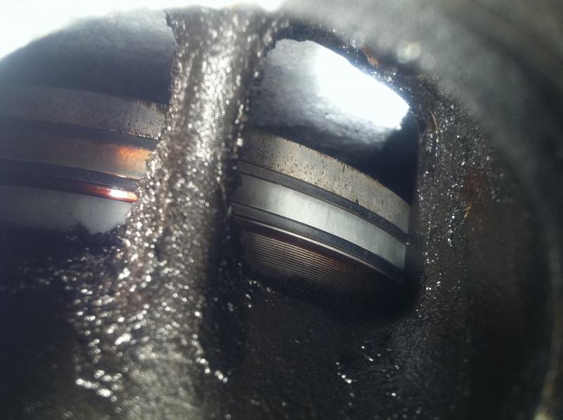

PostPosted: Sun May 06, 2012 6:38 pm
Interesting see how the second ring is sticking out of the groove in the piston but the top ring is not or is this a optical illusion?
If its not a optical illusion why is the lower ring sticking out so far and the top ring is not?
Does the exhaust bridge have that much more clearance where the bottom ring is currently parked than where the top ring is currently parked?
Better pictures of the Engine internals are needed taken in better lighting and not over cropped.

Here is another pic... Im a newbie so... be nice... lol
im not sure the top doesnt have that ring... bottom one has that red burnt around... put my finger nail in there and its definetly a groove.

The pics of the piston thru the ex port tells a great stroy fo the piston life inside the cylinder. Good shot.Look close right to left above and below each ring on each side and compare. I bet "H" will get his arrow machine out and mark it up as it's a good depication of life. It also shows why being a little rich is good and why to rich ( carbon Build up and low grade of oil) is bad. Not to mention why gaskets are cheap to keep a desent top end good. Your taking a good approach on your new ride, good for you.
