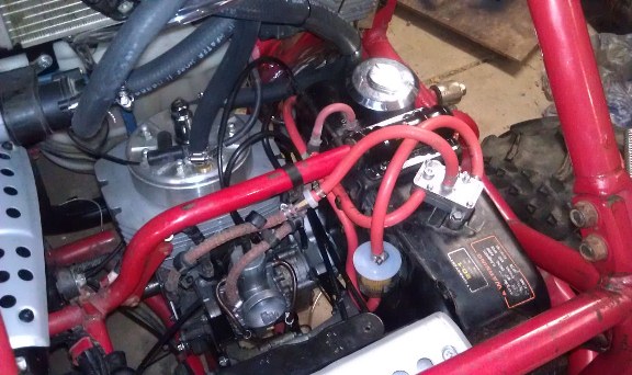

May need help with a diagram or pic, etc. All I have found so far as a fuel pump is: Mikuni Rectangular Fuel Pump, I believe it's a pulse pump. lay-out wise, all I have seen, is this octopus looking setup in the Honda Manual for a Keihin and stock tank. kind of gives me a ideal of were stuff goes.
So basically I'll drill and tap for a brass fitting in the filler neck of the tank. run the gas feed line at the bottom of the tank to a fuel filter and then to the pump. from pump to a y-fitting. one line of from the y fitting goes to Carb the other line from the y fitting goes back to the tank bung. I see this pump has three connections to it, I'm not sure where the pulse line on top of the pump goes too. Is this the line that the diagram shows to go to the crankcase? the actually pictures that show how its hooked up in the Manual are really bad, and I can't see where they are going/connecting things too.
Do I need to change the gas cap from a vented to a non-vented cap?
Thanks for the help. :)
 Post subject: Re: Newbie From Texas
PostPosted: Tue Oct 15, 2013 11:03 am
Yes, you will still need to use a vented fuel cap.
Plumbing is actually simple.
Here is the layout if you are using a Mikuni (aftermarket square) fuel pump.....
1.) The pulse line (from the crankcase) goes to the top of the pump.
2.) If you look at the picture below, the nipple that is closest to the center of the Ody is the line the runs to the carburetor and is also "T"d to the fitting you are going to put in the neck of the gas tank.
3.) The line that is pointing towards the fender of the Ody is the intake line from the fuel tank.
Now you will either need to obtain a Odyssey fuel "T" or you will need to put a .190 jet in the fuel line returning to your fuel neck. Without this restriction, you will get fuel starvation at full throttle.
Thanks go to DMoneyAllstar for the picture!

ah-ha, cool, this helps out a lot. I just need to figure out how/where to mount it. it doesn't have to sit flat like that dose it? I have a couple of ideals that may work, we'll see.

If you use a stock Honda "T" with a check ball, you will not need a main jet in the return line. Just make sure to attach the return line on the side of the "T" with the check ball.
PostPosted: Tue Oct 15, 2013 1:08 pm
Thanks Nick. For you nipifiles.....Normal nipple, Flat nipple, puffy nipple, Short nipple, long nipple, Inverted grade 1 nipple, Inverted grade 2 nipple, Inverted grade 3 nipple.....there that just about covers it! HA HA HA! :shock:
Anyway, the fuel pump can be mounted in any configuration you like and doesn't have to be oriented in the horizontal position.
