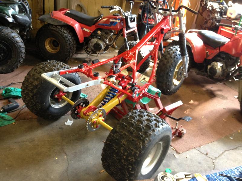

hey hows it going guys, I am new to this forum and do not currently have a odyssey or pilot but have always wanted one since i saw the movie "heavyweights" back in the day when i was little lol. Anyways i am currently rebuilding a 1984 ATC300R and was pointed to this direction from fellow members on 3wheeler.org and Airfoolers.com. As many of you know dealing with your odysseys and pilots sourcing parts can be a real hassle, and i am having one heck of a time trying to source parts for the 300R top end and threw out my time spent working / learning about this Engine i have heard about people re sleeving the 300 top end with a fl350 sleeve. I thought i would come and join up on your forum to see if i could learn some more about this modification if my Engine down the road becomes in need of the modification. currently my cylinder is at 76.50MM, i found myself a NOS 76.50 piston and rings only to find out that my cylinder was already at that size needless to say i was thrilled to hear that lol. but i recently found myself a NOS set of 76.75 rings so now i am in need of the matching piston. my search continues........

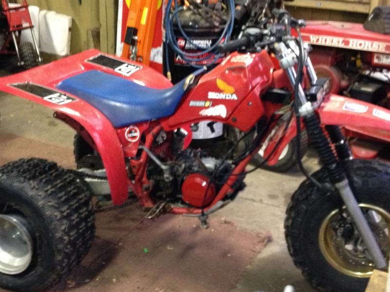

anyways here are some pictures of my progress of my 84 atc300R build.
this is when i first got the trike.

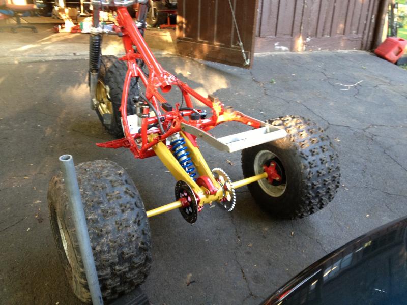

this is how it sits now, i sent the rear shock to suspension 101 out in Cali for a rebuild and to have it re valved for 360 lbs with a new Eibach spring to match (im a big boy at 300lbs)

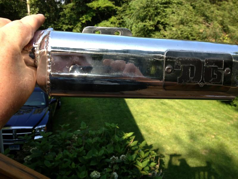

its been a long process and i have been slowly working on it since this past April, when i first purchased the trike i did not even no that the 300R kit was included (it was my first 2 stroke) so needless to say i had alot to learn.... it came with a full DG exhaust which i have since cleaned up and i also polished the silencer to a mirror finish.

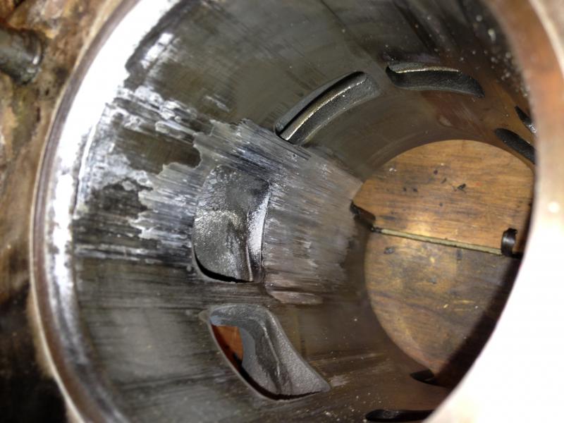

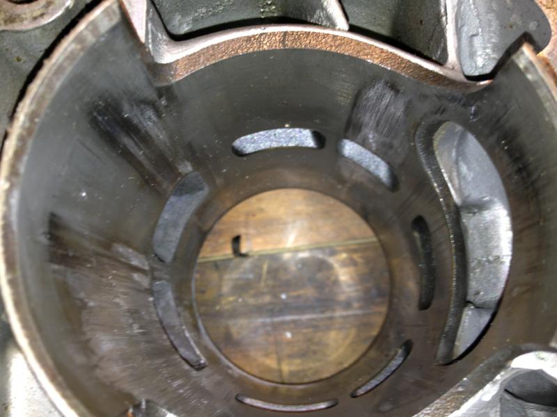

On the topic of your piston and cylinder, have you checked the clearance between the piston to cylinder wall? If it is within spec (someone please chyme in on what air cooled clearance should be), then you will not need to bore, just make sure the current bore is nice and straight with a ridgid hone, not a flex hone.
Nice lookin ATC, my first "fast bike" was a 1985 250R ATC I Called it the Widow Maker. Had a friend end up in the hospital with broken ribs, collapsed lung, and all kinds of other goodies after riding it, so I sold it. I currently have a 1983 Honda 70 ATC as a pit bike.
PostPosted: Sat Oct 19, 2013 10:24 pm
Joined: Thu Oct 17, 2013 8:35 pm
Posts: 35
Location: Seymour CT

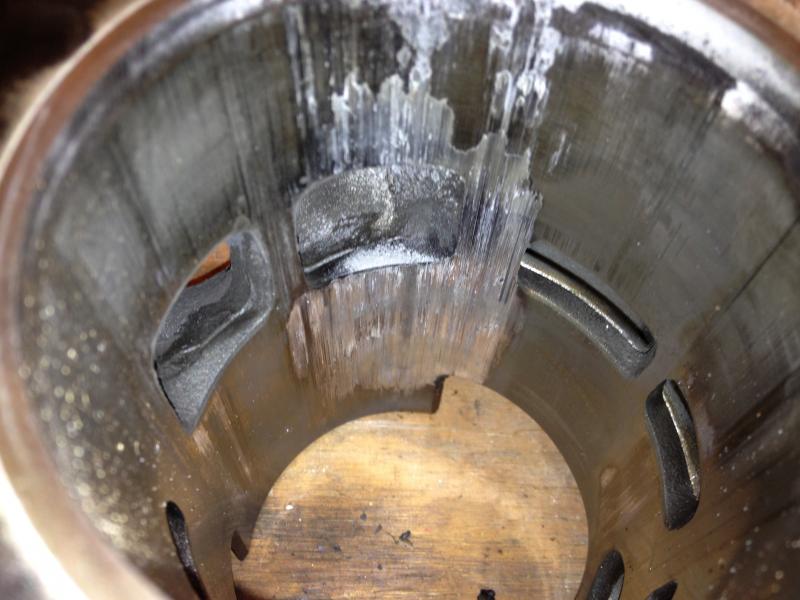

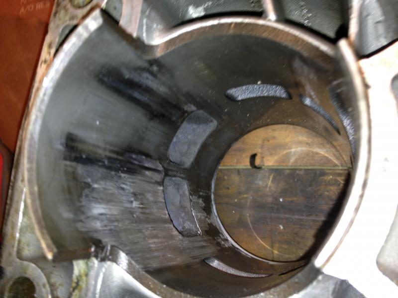

i have not checked the clearance between the piston and cylinder wall as i do not know what the exact clearance is. My clymer manual does not cover the 300R kit so i am shooting blind. although i did bring my cylinder to a local machine shop (not that the machines't has ever worked on this Engine before anyways) but he said that alot of the scoring that is in the cylinder wall seemed to be fragments of the piston impacted into the cylinder wall but there are also scratches none the less.....
i wish there was a machine shop here in CT that has experience with this kit as i would be more than willing to bring it to them and have them tell me what exactly kind of shape it is in, but i am aware of such shops as racers toy store and Flotek. and i am not exactly thrilled to send my cylinder multiple states away just to get a diagnosis, but at the end of the day it is more than likely what i will have to do since i do want someone who has experience working with this kit to perform the machining process on it and not a shop that has never worked with one before.
here are some pictures of the cylinder

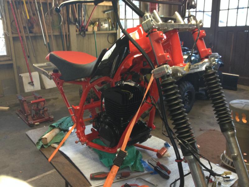

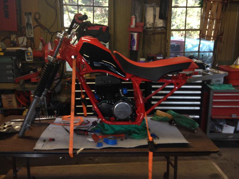

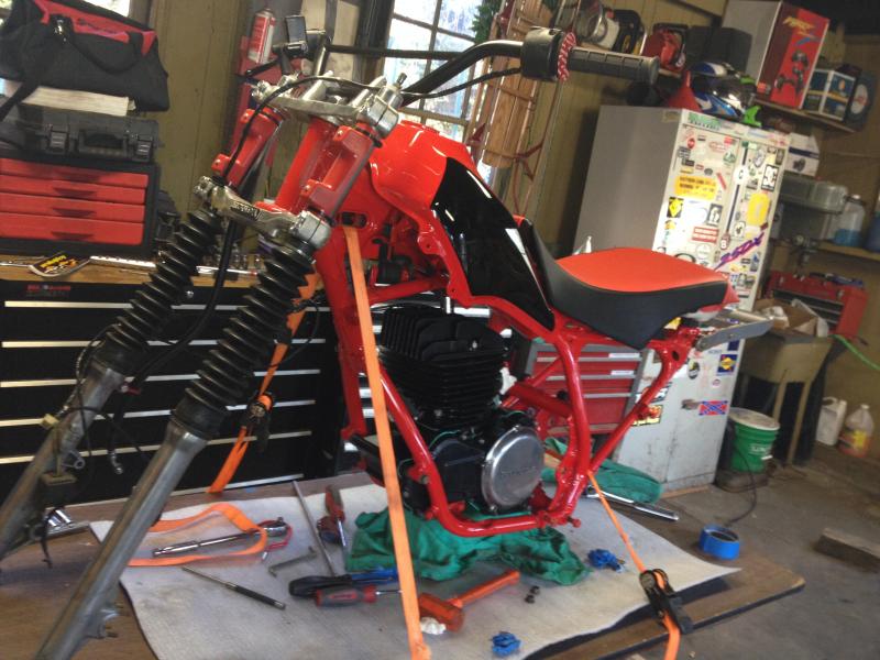

Well thanks to Pilotpete1 supplying me with some much needed 300 top end parts i am making some serious progress with the 300R build.
I just picked up the Engine from Ken O'conner racing here in CT yesterday. I gave it to ken and had him perform a full tear down / inspection, rebuild the crank shaft with a hot rods connecting rod kit, install CR500 crankshaft bearings (direct fit by the way and have 8 rollers instead of 7), perform the power player 300R modifications from the May of 1984's Issue of 3 wheeling magazine, and also perform a mild trail port job to the cylinder.
i was thrilled when i walked into his shop and saw it assembled for the first time yesterday!. I got right down to business and installed it into the chassis this afternoon. its been quite a long process and difficult process sourcing all of these parts but it is finally coming together. i still have to decide on what carburetor i am going to use, cannot make up my mind between a 35MM PWK quad vent air striker or a 38MM qaud vent air striker. tho since it is primarily going to be ridden on trails and not raced i am leaning towards the 35mm
anyways here is a couple pics of the progress
