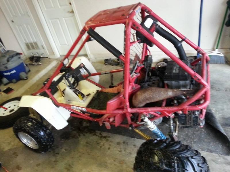

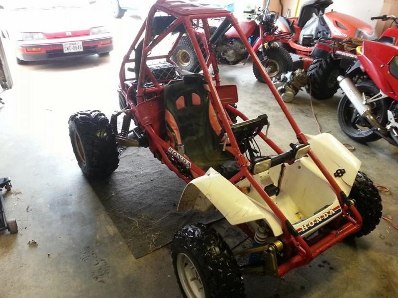

Howdy! New Odyssey owner here.
During my daily Craigslist browsing I found an ad for an '85 Odyssey in town. Ad said it ran great but it was short on details. I disappear from work and go look at it, and it's not too bad. Runs and drives, but electric start isn't working, and it's badly sun faded. Rear fenders are gone, front fenders/foot area/seat are badly sun damaged. It has Works brand shocks on 3 corners, but what looks to be an OE shock on the RR, and an aftermarket pipe. I bought it for $1000, which I thought was a pretty good deal. He said he had several other people ready go come look at it.
After getting it home it appears to be in pretty decent mechanical shape. The wiring issue is related to no power getting to ignition switch, but I didn't get any further than that. I'm going to get some better pictures this weekend when the rain stops.

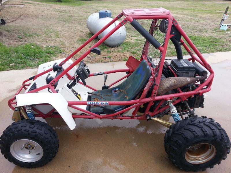

I got some good work done this week. I finally traced down the ignition power wiring problem. Someone has clearly been in that wiring before. There were not one but TWO splices in the red/white wire that goes from the battery, to the rectifier, up to the ignition switch, but both of them were good. At one point that particular wire came out of the loom, and went in between the frame and skid plate instead of above the frame like the rest of them. I found a spot where the insulation was good but you could feel the cooper inside was broken. I re-loomed all the wires properly and now all the electronics are working: starter, headlights, tail light, and the stator is charging.
I pulled the front drums and the shoes looked OK. I made a minor adjustment to the front cable and the front brakes seem to be working properly. I also went ahead and bled the front and rear brakes. I haven't looked at the parking brake yet. I opened the air box and of course there is no trace of an air filter.

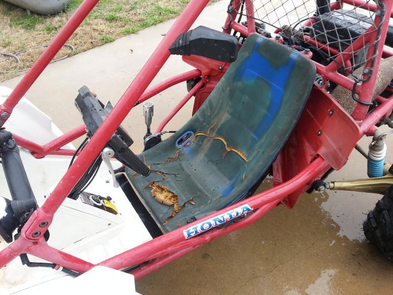

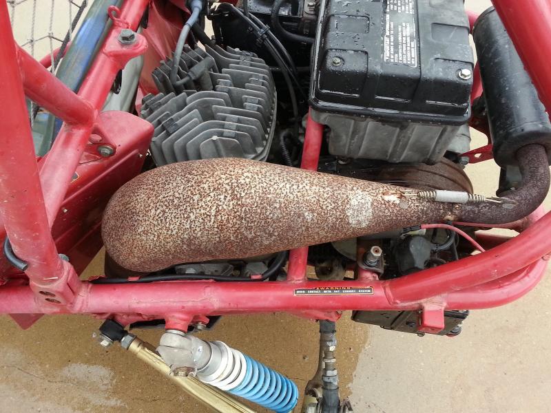

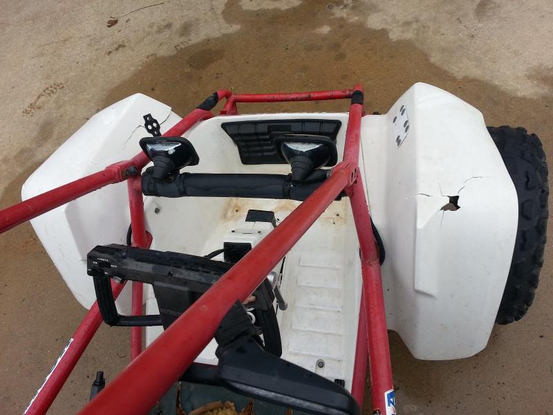

Here are some better pictures. I pulled off the nasty seat cover. It sucks how much damage the sun has done to the plastics and seat. You can see where the harness was sitting on the seat. The tub is brittle but not too broken up. There is some damage to the column cover but it's holding together. The fenders are rough, with a few holes and several home made braces. You can see the outline of a "Works Shock" sticker that must have been on there for years.

Got a great deal their looks straight,I'm guessing if their was no air filter they didn't change much oil, them trans's arnt cheap so change the oil in that bad boy soon.you sure did come to the right place many people here will give a lot of helpful advice on just about everything, good luck with your new toy and welcome

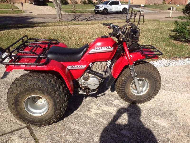

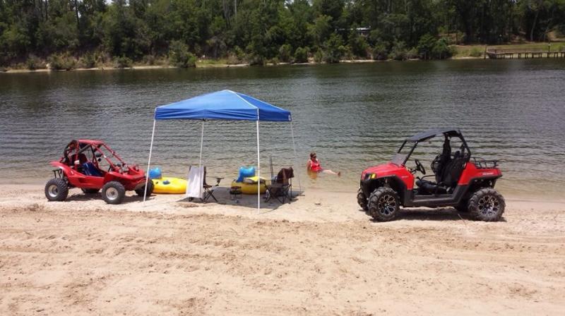

Nice collection of 3 wheelers! I just got into three wheelers and couple years ago,fun to ride
I have been wanting a water cooled 250 R but just never had the bucks to get one.
I had an air cooled 250 or but not anymore. Sold my big red not too long ago when I bought the razor
If you wanna check out down south let me know
File comment: From down south

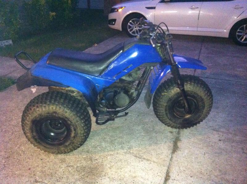

File comment: Old yamaha
