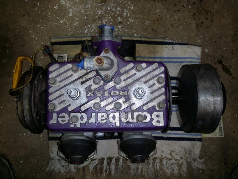

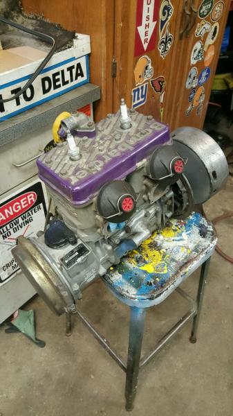

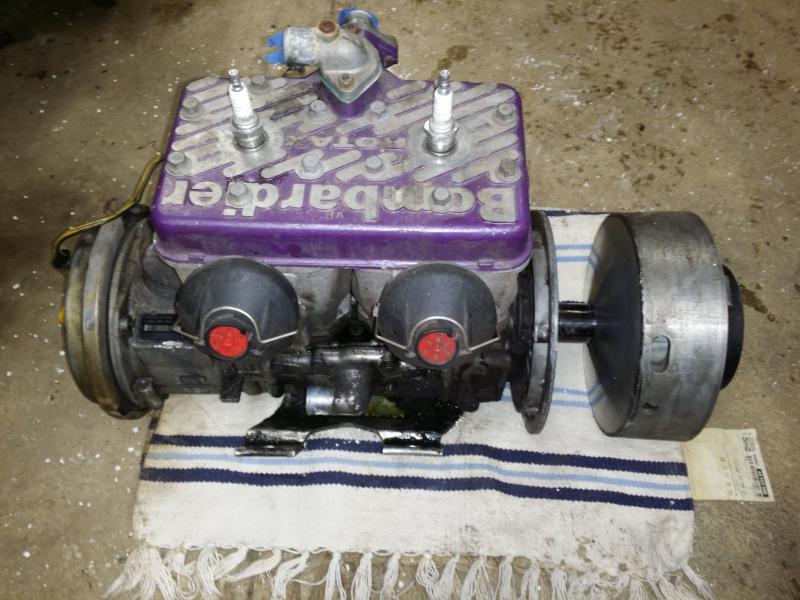

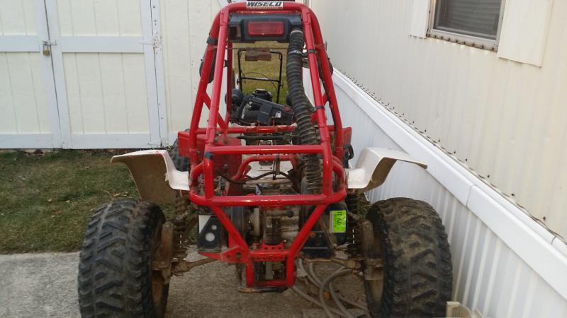

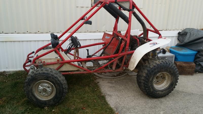

Thanks lol im in newport michigan I want to sell this Engine im going to put a rotax 670 in it has the art piston
PostPosted: Sun Dec 14, 2014 4:10 am
Looks like a good start! You will love the rotax but be itching for more suspention with you new found power. Remember the odyssey has no slipper clutch in the transmission, so if you land on power from a jump say bye bye to the trans lol. I have a 570 Yamaha in my fl350. It has about 85hp and it rips. I have the 670 rotax in my pilot. If you need any help just ask, I've done a couple swaps so I know a bit about em.

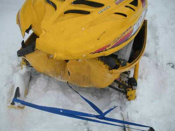

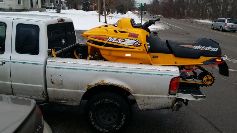

Ok guys here is where im at I picked this beautiful thing up for 600.00 they hit a dock pole dead center so only exaust was damaged so now I have my 670 with harness and gages already had a radiator Engine mount on its way good to go will post pics as I go along I literally just got the sled it had 2,300 miles on it and the Engine has 8hrs on the rebuild its a 1998

PostPosted: Mon Jan 19, 2015 4:16 am
nice buy! is it an HO? being a 98 it likely is?how many temp sensors are in the head? 1 or 2? part the rest of that thing out! the rest is still worth money!

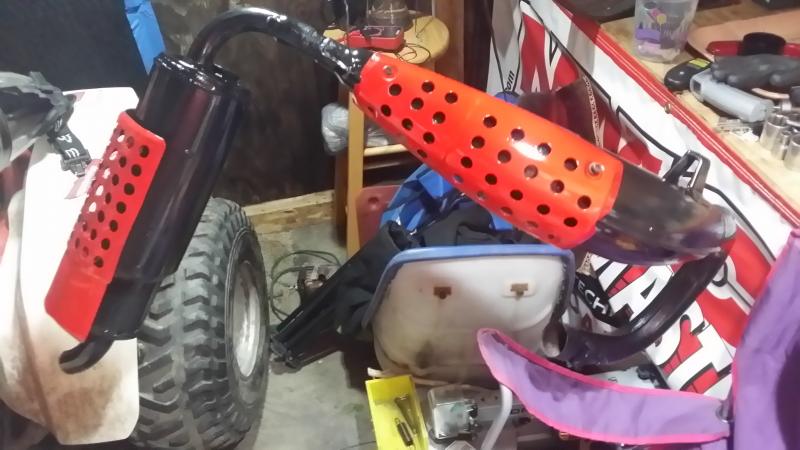

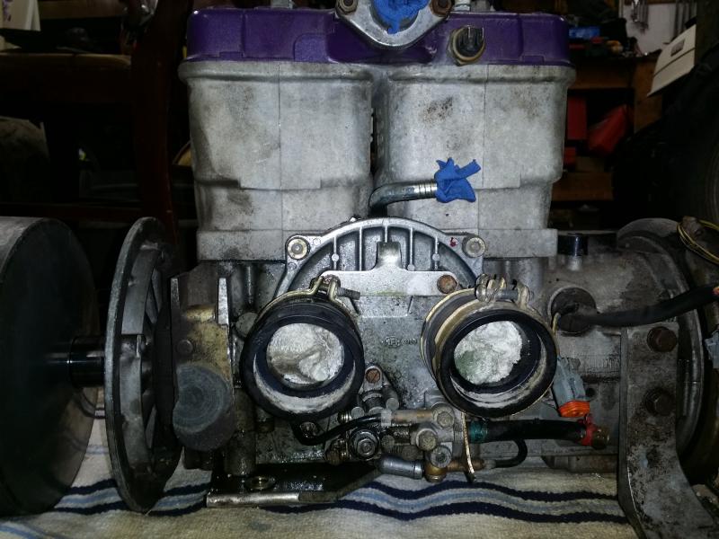

Ok Engine is out of the sled now waiting for the Engine mount and a lil bit of a warm day to wire everything up then all I need is the farr offroad exaust and ready to ride

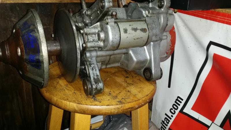

Got a old bsa motorcycle carb cable adapter to got from single carb cable to double, also had the stock sled secondary clutch bored out to 1" bought a 7/8 to 1" shaft adapter and last a dual core honda civic radiator with 12" red fan

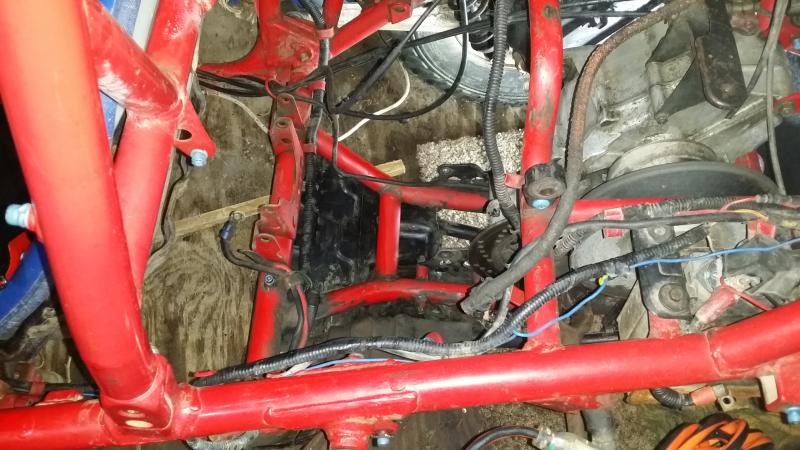

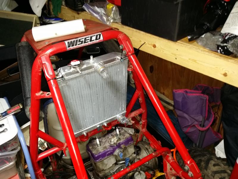

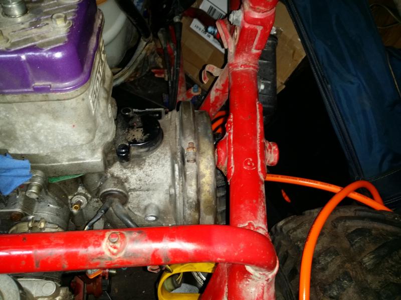

A little progress laid in to see what needs to be cut/grinded and mocked position of radiator.
Still lots of work.... any ideas for the clutches?

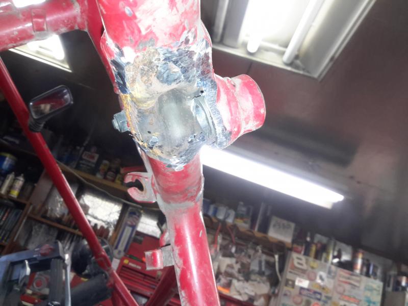

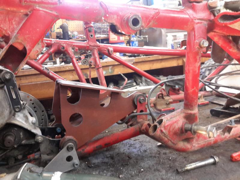

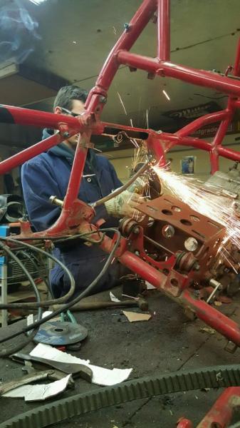

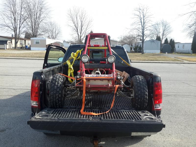

Yes lol today I took it to a buddy's I cleaned up the cutout spot, notched the frame to clear the recoil. Made up a bent steel reinforcement rod, and started on the side plates
File comment: Loaded up On it's way to dougs

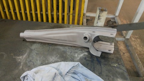

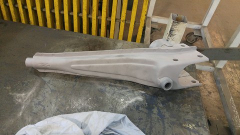

My buddy james did some media blasting for me today and saved me some time and work lol thanks james
File comment: Trailing arms ready and gettin powder coated right now :)
