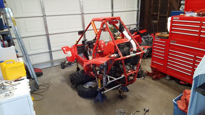

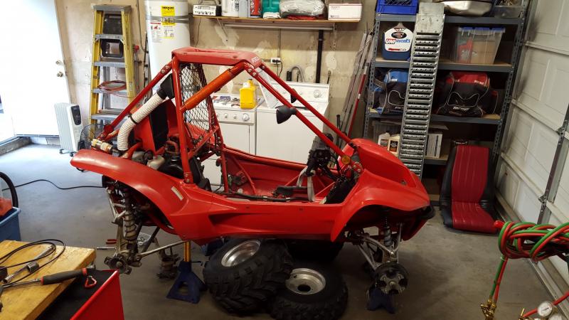

Some pix of the new toy.
I'm replacing all the CV boots and inspecting some other areas of concern. Otherwise it has an aftermarket pipe (cracks have been welded) a missing parking brake actuator screw, the choke cable needs to be adapted to the Keihin flat slide carb. The stock lights are going back on. Otherwise not in bad shape.

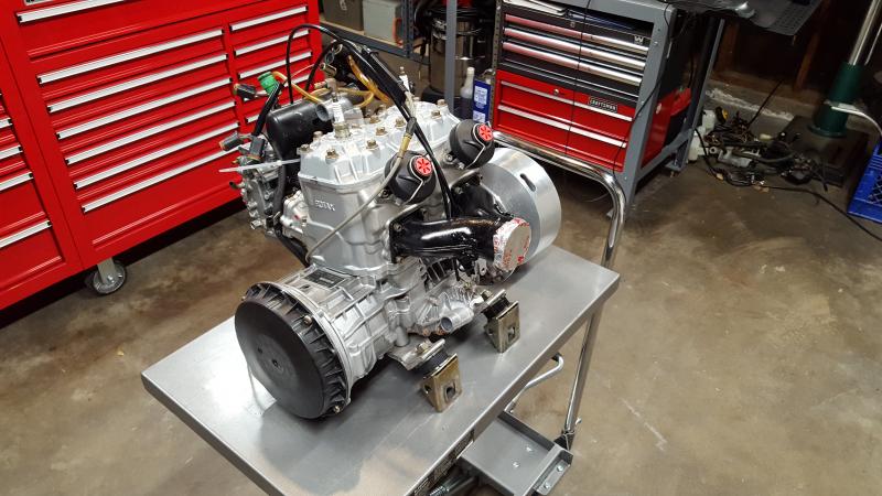

Forgive me, for doing this, but I have a Rotax 800cc power valve Engine from a Skidoo that's eventually going into the Pilot. I know the 670cc conversion is popular and the videos I've seen are just what the doctor ordered. There's a video of a bloke that stuffed a rotax 800 into his pilot and the performance is insane.
Okay, with 120 horsepower, what's gonna break first? The tranny, a CV joint or my neck?

CVs are stout, transmission has a slipper clutch and does a great job in protection.
I have burnt up a slipper with larger tires and asphalt launches though.
Build it... You won't look back, just make sure you remember that cage is 25+ years old.

Unfortunately, I may have to mod the frame to get the Rotax to fit, but if I can make an outrigger bearing support for the Skidoo driven pulley that mounts back to the transmission, then I can move the driven pulley out about 3 inches which will allow the rotax to fit without modifying the frame on the right side. I have access to CNC machines. Looks good on paper...

That Engine will easily get you in trouble with the stock suspension if you REALLY like to drive it. If you are going to put around and hit the gas once in a while on the straights you'll be fine.
Personally, I think the Engine has enough power to have fun. The suspension has tons of room for improvement which will make the overall package much more fun. (and less risk of killing you)
