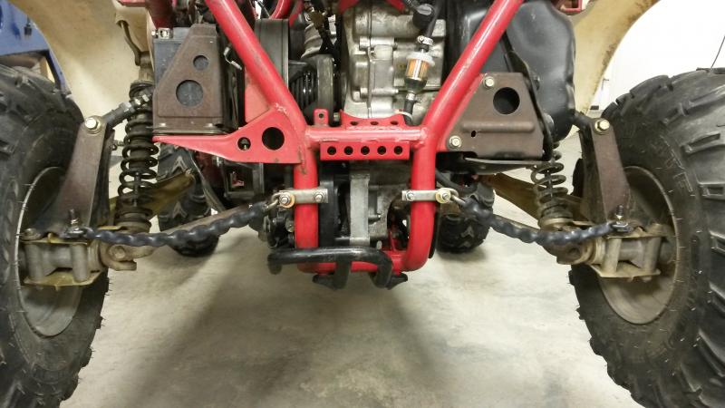

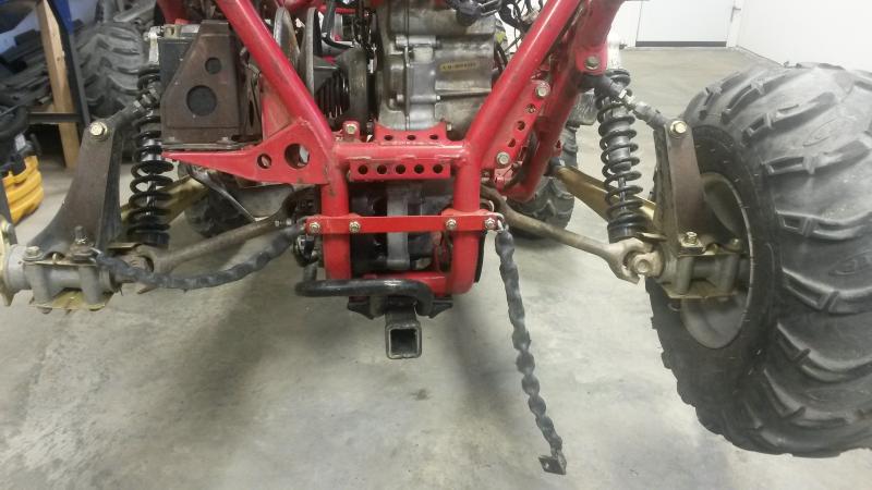

You will also need a 20mm reamer. You need to run the reamer through to get out any burrs or misalignment. If you don't install it right it will blow up again.
You will also need to make shock savers. If you don't build them you will end up bending the shock when the u-joint breaks. In the attachment below is a picture of my shock savers. The chain must be the correct length so that it does not bind up.
If you replace the shocks you can NOT be longer 15 1/4" or you will get u-joint bind. No one has found a cheap replacement for them yet. You must buy the expensive Works shocks.
