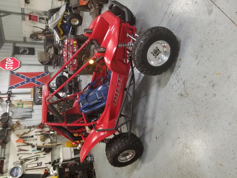

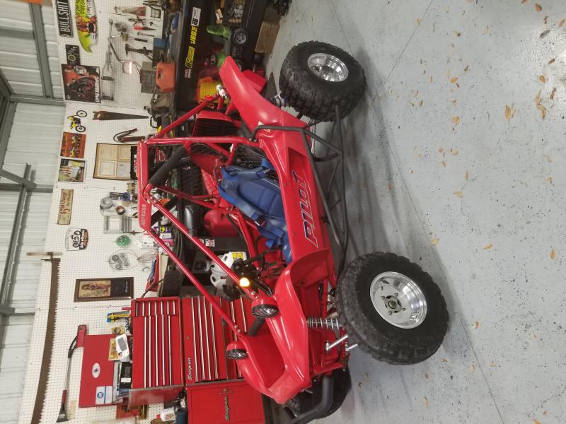

Hello all, im new to forum and new owner of a 1989 pilot , please chim in on what i need to do for a top end , explain like your talking to a 10 yr old, not new to 2 strokes ,but the amont of info on pilots is mind blowing, where you get plugs for leak down test? What should i check if replacing top end , any help is appreciated
