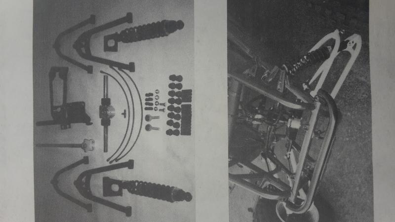

Not sure whats up with the sideways photo posting, this pic is how the steering rack was mounted clamp-on style.

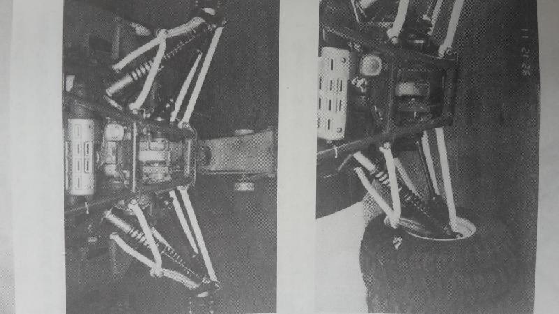

Better photo of the front view, we know the size of the tires and the kits +6" to overall width and 12.5" wheel travel this could be used to scale off the photo to get A-arm lengths. Date stamp on the photo is interesting.. 1992 and the dirt wheels article is August 1993.

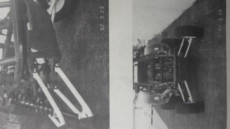

Rear suspension kit photos, adds 3.5" to a Pilots ground clearance.
