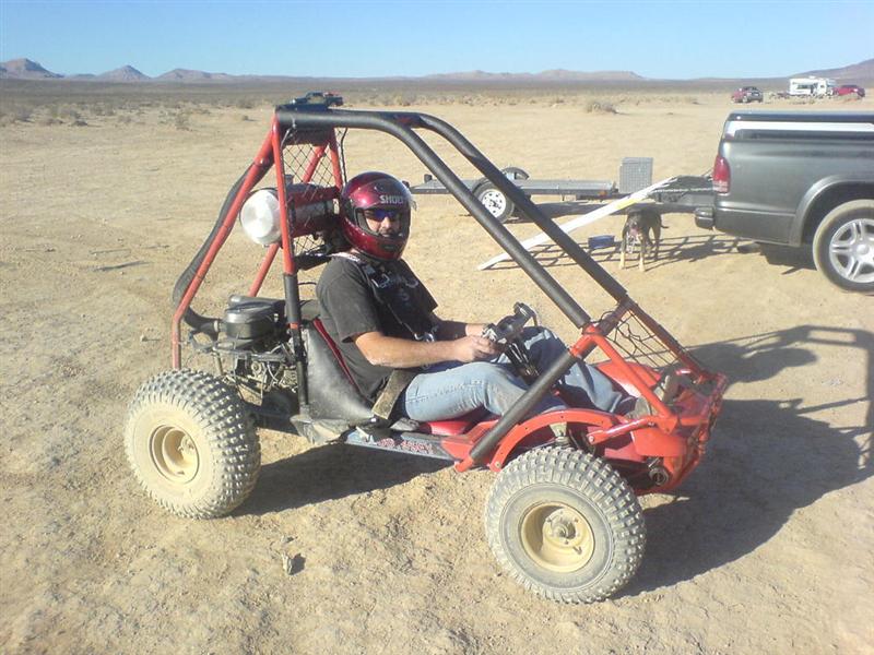

File comment: First ride! No fenders or skid plates yet.

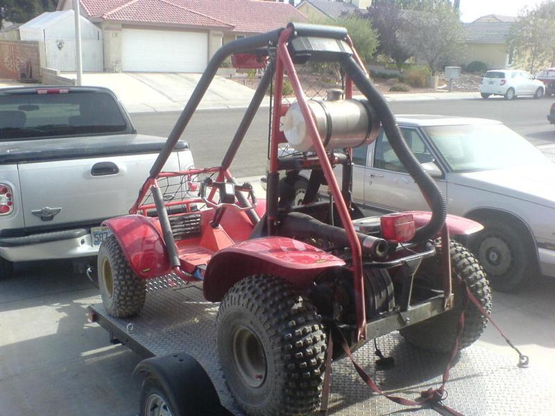

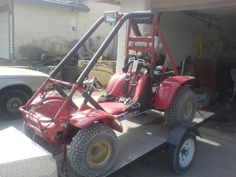

File comment: After the second ride

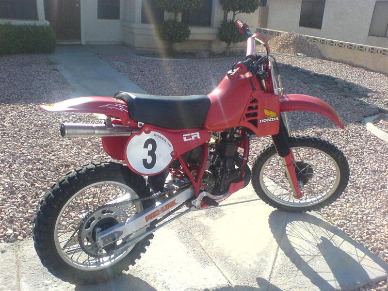

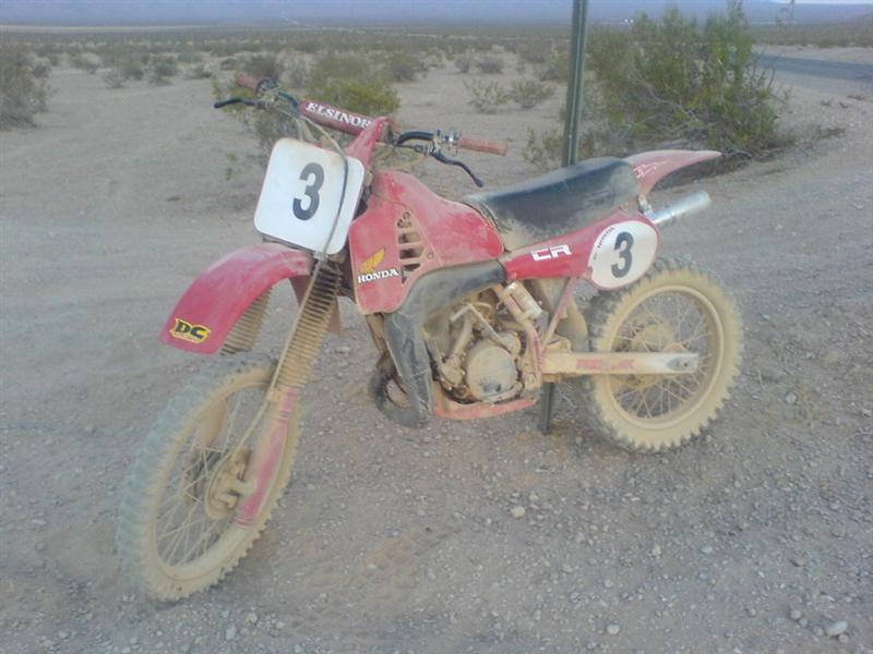

Here is a before and after of my CR250 R
File comment: Before
File comment: After
File comment: A couple hours after that. Broke the chain. Now has a new red O-ring chain.

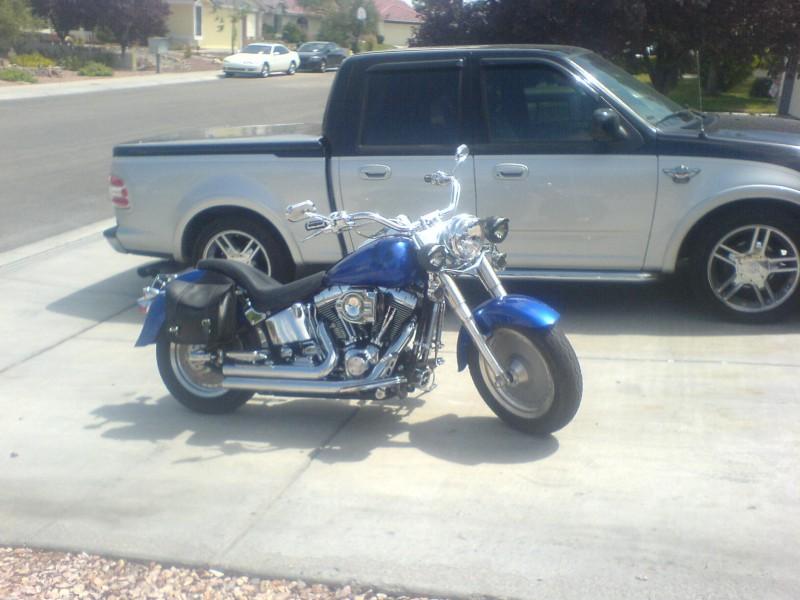

File comment: A couple more of my never ending projects.
