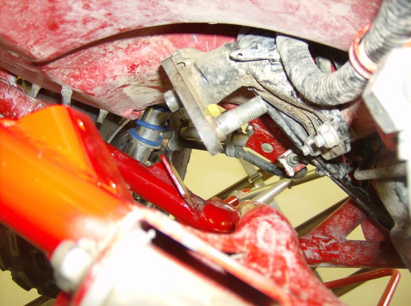

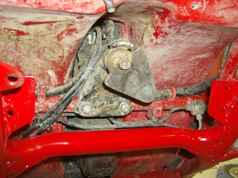

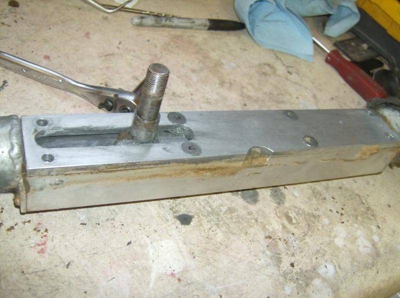

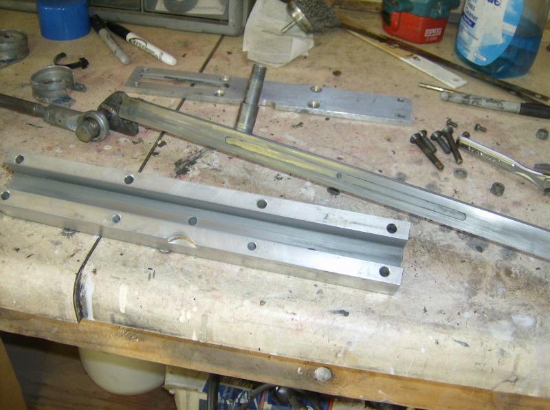

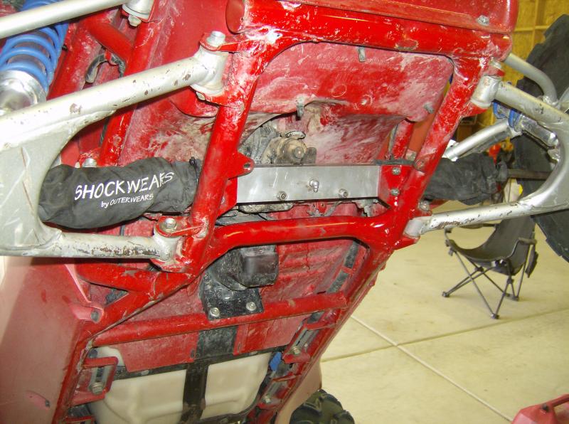

Personally,if I was designing a steering system,I would do something like this,except make it clamp the lower tubes,no welding at all.Benefit of a rack but with "go-kart" feel.

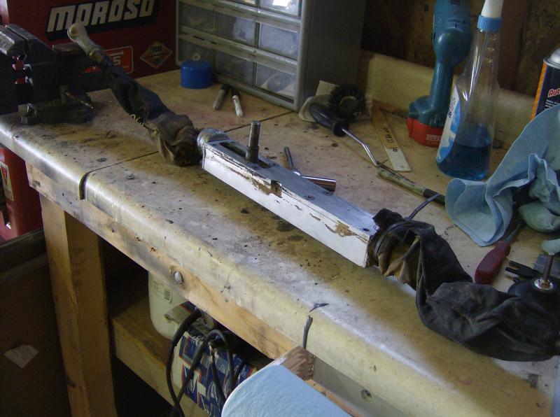

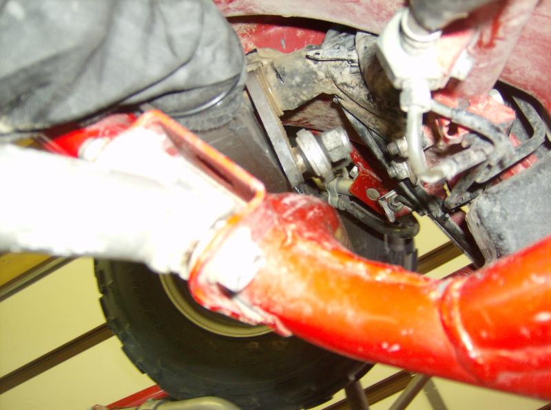

That rack was installed on my Pilot when I bought it. It takes a little more muscle to turn it compared to a tie rod set up, but I have never really noticed any jerk in steering wheel with it even with the off set after market wheels.

that's cool Rat,I didnt realise it was yours.
A UHMW liner would make slick instead of alu. on alu.
Cowboys is a work of art!
PostPosted: Fri Jul 27, 2012 9:41 am
I pulled it back out again last year and added some aluminum strips along the slots where it slides. The slot is worn a bit & they helped prevent the shaft from rocking and binding & made it so much much easier to turn especially toward the end of the day when you are tired. I'll bet when it was new it worked great, but I am guessing it was installed on my Pilot when it was it was fairly new and it didn't look like it had ever once been lubed. When I first bought the Pilot it was so dry you could not hardly turn the steering wheel unless you where moving.

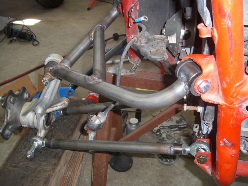

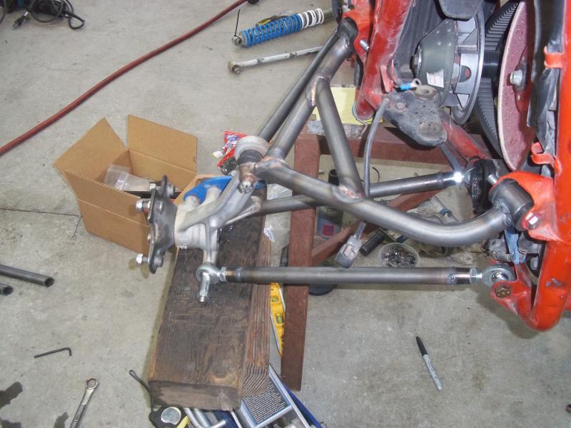

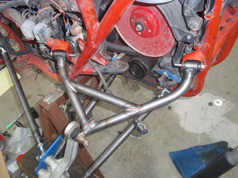

totally agree hoser, going to get my son to put some photos on tonight, wanted to yesterday but you know kids lol. I had mounted the tubing to hi on the top pivots and the tube was hitting the -pivot mount way to soon(brain fade) I think it is rite on now, the way the top arm is now I think is spot on and travels freely all the way beyond where the cv would let it go!

Refreshing to see someone that uses a tig also using filler metal for the weld and not just the base metal.
Details on the Baja suspension please.

The filler rod is 312 stainless, works very well on 4130 and welding 4130 to cast type metal like the ball joint piece is made out of. Cant get any strength with out filler rod. That is my 5/1600 baja that I have had for years and years. Won everywhere from the Mint 400 to Crandon Wisconson, Baja 1000 and 500 and countless short course wins, The rear is IRS Micro stub set up running my own make arms that runs 1 Fox 14 inch 2.5 4 tube bypass, the axle length is 19.5 with a 1 inch longer than stock arm producing almost 15 inches of wheel travel. The tire hitting the body is the limiting factor, I run a 300M 23mm torsion bar. The front has about 9 inches of travel with stock width front end with sway away(stay away) 5 leafs up top and 6 leafs in the bottom tube. Could go more but it willwipe out the torsion bars real fast if I do. has a big Nissan bump stop up front that you can drive this thing into the biggest holes with ease. I will post some suspension and inside shots tommorow after work, race ready it tips the Score scales at 1503 lbs. This same set up on my 1600 cars produces 20.5 inches of travel, I run a 21mm bar in my buggies. I know you have been to Crandon before hoser correct? I have won there 4 times over the years, infact I was the first souther cal racer to go there in 1988! I saw some shots you took of the Fridays EEE type car, Michelle Friday rode in this Baja bug to a 5/1600 win in Crandon with me in 1989(I think) maybe 90. I have raced 5/1600 since 1977 when the class first came about and started racing class 11 stock Vw sedans at 14 years old in 1975. I still have my original 1967 class 11 built in 75 and also have a newer class 11 that I race at Snores Battle at Primm every year
