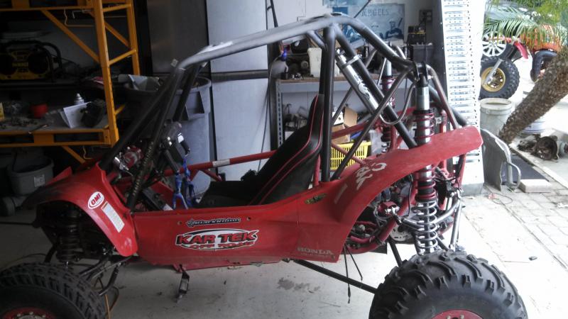

here's a couple pictures of the long travel

Dave-Co wrote:
No sweat, I tried to explane all as best I could, the best rear end mod for a fl 350 is adding a 10 inch travel fox 2.0 shock. easy to tune the rear to handle 5 times better than they handle now.
10" travel shock for approx. 4" of shock stroke?

It is what you do with that shock stroke that changes the ride considerable. Valving the shock to the travel is something works or any other can not come close t0
