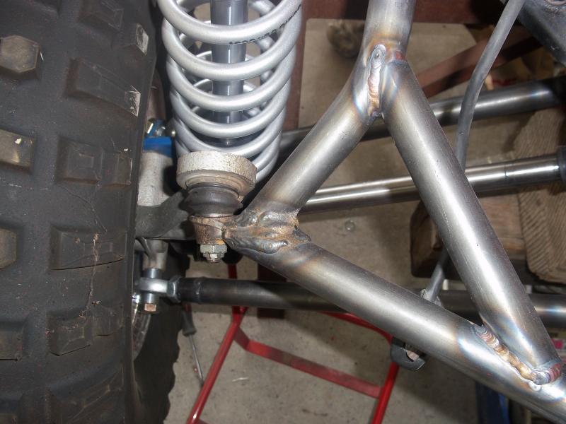

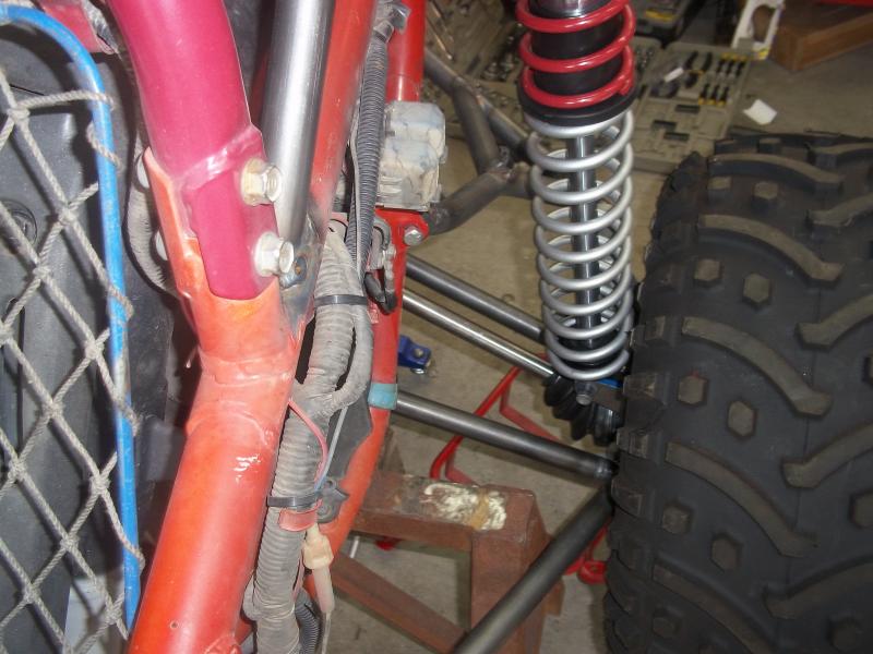

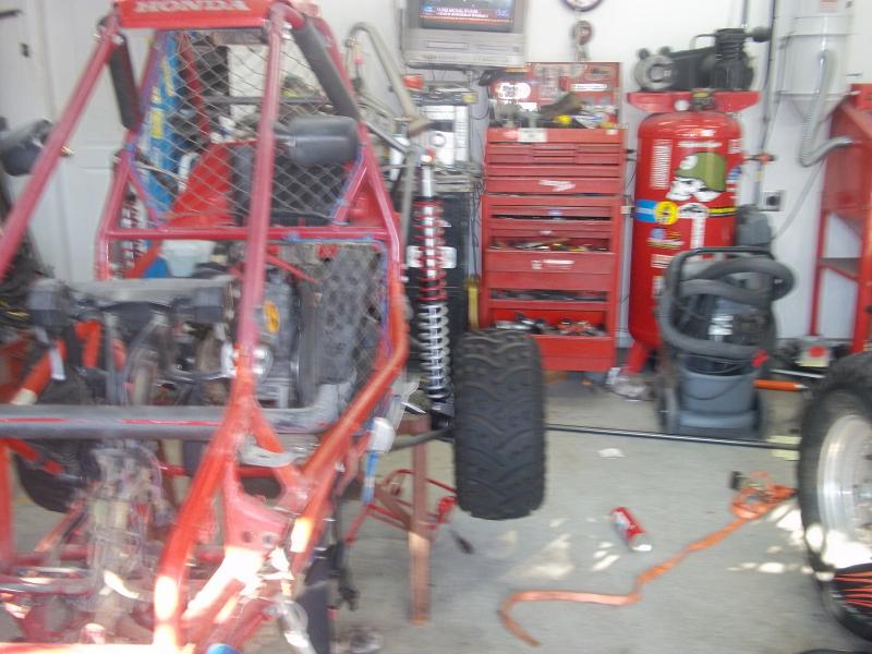

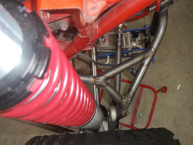

here is some new photos hoser, 12.5 inches rear wheel travel with a re desined arm up top,cv turns perfect at 30 degrees down but brought it up to 28, could get more but the inner cv wont let it go any higher. Only way is to change Cvs out which I am considering on this pilot, thinking about milling the inner cv housing and welding a cv cup onto it and doing basically the same to the outside... when I get time, but it has enough travel the way it is and my 12 year old son welded the arm supports, not me lol for 12 years I think he did great, it has been fun working with my boys on this---Dave

PostPosted: Wed Aug 22, 2012 10:07 am
Looks good any more on the front and the steering linkage thing?
Great to see you have the kids involved.
