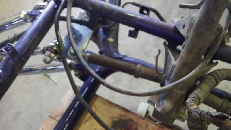

Yes going by memory ATVR used modified VW ball joints.
I can take all the pics you want of the ATVR steering but that is the last steering setup I would want to copy, first they force you to butcher up your plastic tube to make it fit, second its a weld on addition adnoh made a bolt on drag link for his Pilot I would look at and or copy it I also think his installs without modifications to the tub? I searched for adnoh's info and pics but cant find it and cant remember the name of the thread maybe someone else can or better yet contact him ? I will shoot him a PM with a link to this thread...

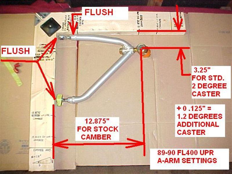

Here are prints for +3" arms http://www.pilotodyssey.com/PO/viewtopic.php?f=1&t=1756 :-)

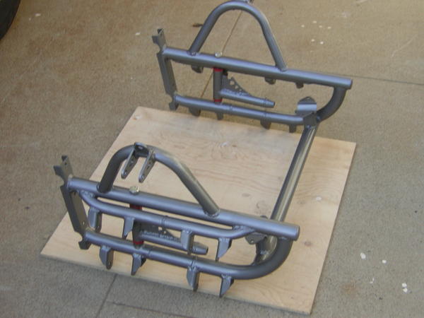

Check out the last pics in this post Dave Image

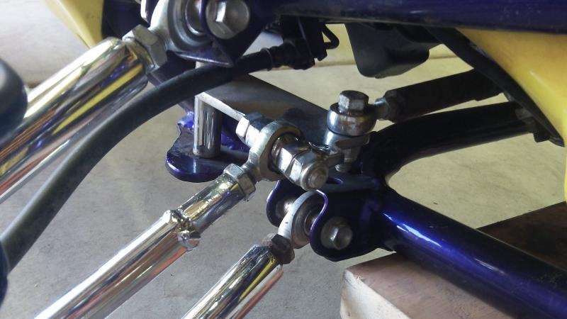

Here are a few pics of the TJ Pilot bump steer set up. It is a pretty simple design with no need to cut the foot tub, & IMO worked well.
I hope this helps...

I still have Mudbogger's LT Pilot here I can take all the pics you want of the ATVR bump steer kit but whats the point I rather see a bolt on design and a design that does not require modification of the tub, its just a basic drag link setup like found on many other machines nothing top secret or state of the art.
Rather see you look at others like adnoh's and or Hauss's
I like the Hauss steering setup because of the way he mounted the tie rods to the steering stem, they are closer to center and mount stacked like the FL350 the Pilot goes threw a arc with the side by side mounting arrangement, the rest I think is pretty much a copy of the ATVR setup.
If you need pics or measurements off the ATVR setup let me know.

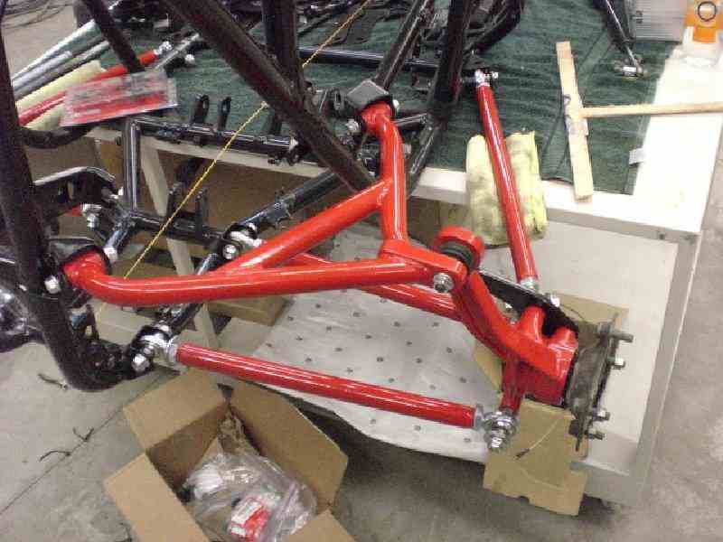

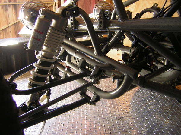

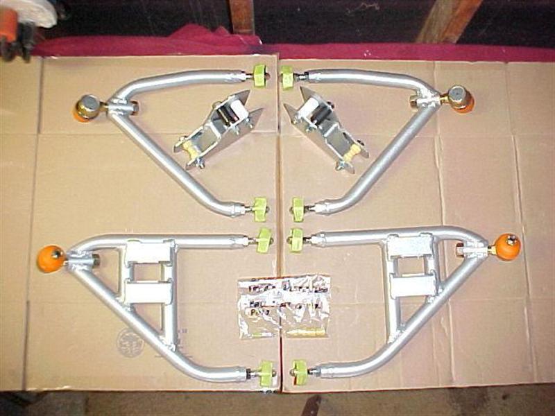

"H" not tested. armswere just mocked up. The axle angle was right around 30. no way to tell until one is stuck in and cycled. I did find some pics of cowboys to share and some info on yoda if not alredy here.
PostPosted: Thu Jul 26, 2012 9:34 pm

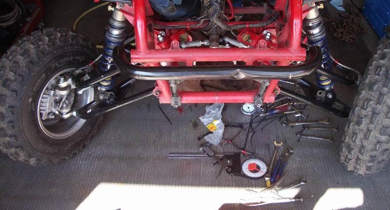

few more I found
PostPosted: Thu Jul 26, 2012 9:36 pm
few more of a board member
