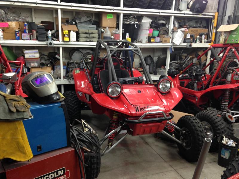

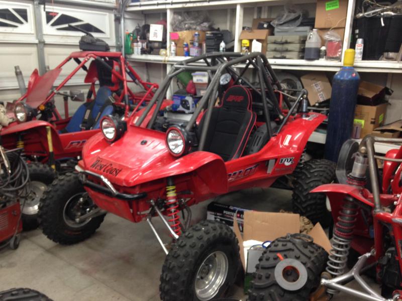

This is my sons finished LT pilot

No sag in the front shocks?

Where it is sitting up front is where it sits the wheels still drop about 4 inches farther down. When I say the front has 16 inches of travel I mean it. ATV racing limits the travel so much front and back it is beyond belief, those are ATV arms in front on that pilot that I did a bit of work on because the arms I had made for it went onto halorisings pilot, these came off his pilot bent with bent rod ends, I was lazy and did not want to build another set at the time. NO atv racing long? travel pilot comes close to sitting like that and are so stupidly oversprung it makes me cringe thinking about it. I have worked on 4 pilots made by them all had 250 springs up front TWO FIFTY! Mine has 90 pound springs up front my others have 110 in front. ATV made pilots use shorter shock up front and suck the front end up when mounting the shorter shock that amounts to at least 5 inches at the wheel losing 5 inches of travel right off the bat, but with a 250 spring AND a shorter shock it really doesnt matter I guess. If you own one and don't believe me or what I am saying take your front ahock off and see how far the wheel drops after you do. I cannot understand that, they put a big Vw ball joint on front and suck the front end up to mount the shock, why bother putting a ball joint like that on if your going to do that. We raced class 11 vws with no limiters on the ball joints for years with over a half inch rotation on the front tubes and did not brake ball joints running 700 15 tires, all this has to support is a 23-7-10 atv tire. The rear on the ATV pilots I have worked on are done the same way, taking a limited travel desing by there making and limiting it even more then sticking a spring the size of my leg on the back that cant let the rear use the little travel it has, unless you drop it off a house. As far as fl 350s, I have a few mods that can make a 350 perform twice as well as it does now, don't waste money on stupid works shocks, they are a giant waste of money buying them new

I have followed many ATV Racing Pilots over the years and watched their suspensions I have been saying the same thing for years people spent 7k for suspension then don't use any more travel than a stock Pilot except for when jumping about 15' in the air, you can follow one and see how much the rear articulates over the bump.
Can never understand why they use such stiff shocks they are suppose to be suspension gurus and do suspensions for a living.
