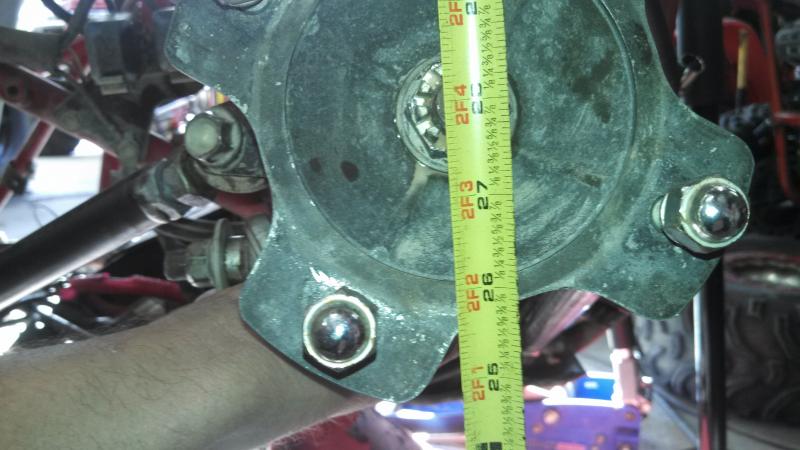

Check out the new cage and suspension travel
 Post subject: Re: Dave-co LT
PostPosted: Mon Jan 20, 2014 1:50 am
Posts: 835
Location: corona
Were getting 17" of travel on the rear with 19" axles. SWEET!!
Is that with shocks attached or just what you could get if you ran it without shocks on the Pilot?
Whats 19" axles mean whats stock, what does everybody else use?
