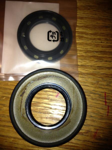

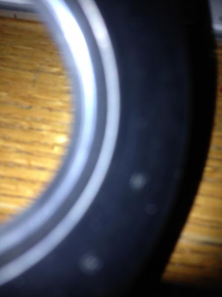

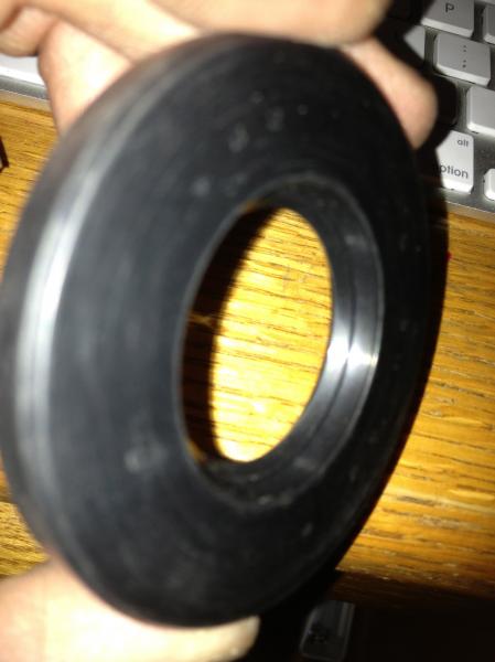

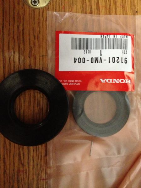

this must be the wrong part????
Dealer sent me these and they don't look like the other wyeeody posted??
These are single lip....

Maybe they sent you seal 18? The outer case seal

I don't think so... These are #18 next to the #20 they sent me. The #20 seals werent in oem pkging they have to be wrong?
Im waiting for a return phone call from the dealer...

Nope, that doesn't look right.

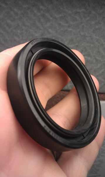

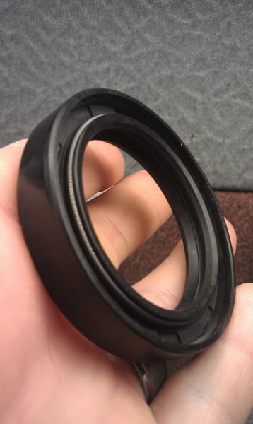

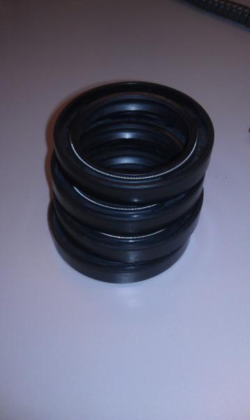

The 45x62x11 DC-type seals from BBS in the UK finally arrived (first order got lost).
Yes, they are 3mm (.120") fatter than stock. But they look great. Cost ~$9.00 each, shipped.

Nope, these are on evilBay sold by seller name "bearingseller", and sold as "fork seals". But the seal type and materials are a match.
http://www.ebay.com/itm/Fork-Seals-45x62x11-DC-Style-PAIR-/160890504493?pt=UK_Motorcycle_Parts&hash=item2575d2452d&ssPageName=RSS:B:STORE:US:101
They took 5-weeks to get here, but that's only b/c the first order got lost (small wallet-sized envelope). Should've only taken 2-3wks.
And when ordering 2 pair (4 seals), price was exactly $8.55 each, shipped.

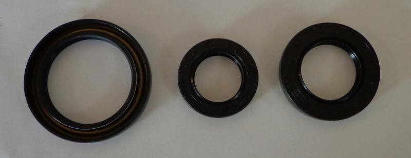

Evilbay seller "Oddatv1" has picked up the torch and is offering the correct seal in a kit with the other two seals for $37.99 shipped. Looks like he's selling them in 5-qty auctions. Why 5?? Seems like a pain.
I bought a couple sets and they are legit and correct. The 45x62x8 seal is right. The two regular seals are made-in-Taiwan nitrile seals, and can be had on evilBay for ~$2.50. So cost from a seal mfg'er is prob like $1 ballpark.
He told me he's paying $14 cost for the TC-type seal alone. Which sounds REALLY high especially since I got this part quoted locally at $3.49/ea if I bought 200-qty and then a one-time tool charge of $450 ($2.25/ea) and I'd own the tool, so, $5.74 cost. However, if they bought less qty, and charged more for tooling, the price would shoot up fast.
So let's break this down...
TC seal is costing $14/ea
Seal #2 is costing $2.40 (pretend he's buying them at evilBay's best price)
Seal #3 is costing $2.50 (pretend he's buying them at evilBay's best price)
USPS Small Flat Rate is ~$6.00 .
Total cost is $24.90
Less the sell price of $37.99
Margin is around $13 per kit, not including listing fees, paypal fees, and labor.
And IMHO, that's respectable. The investor deserves some cheddar for outlaying some cash on an endeavor.

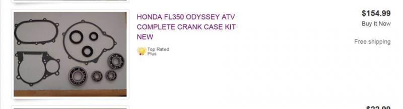

Here's some fun math...
0ddatv1 has also got a complete FL350 bottom end rebuild kit listed for $154.99, shipped: http://www.ebay.com/itm/HONDA-FL350-ODYSSEY-ATV-COMPLETE-CRANK-CASE-KIT-NEW/370892499639?rt=nc&_trksid=p2047675.m1851&_trkparms=aid%3D222002%26algo%3DSIC.FIT%26ao%3D1%26asc%3D261%26meid%3D1351874999474690009%26pid%3D100005%26prg%3D1088%26rk%3D2%26rkt%3D5%26sd%3D370896645403%26
BUT WAIT A MINUTE.......
Say you bought their crank seal kit separate...$37.99
Their balancer gasket...$9.49
Their crankcase gasket...$9.99
Their recoil gasket...$10.99
Their pair of crank bearings...$45.99
Their pair of balancer bearings...$28.99
USPS Medium Flat Rate shipping...$12 .
Total of $155.44....so you get a 45-cent discount buying all that? C'mon....they can do better than that!!! :shock:
With doing some homework and searching good ol' evilBay, this same setup can be had for around $125 shipped, and this is with brand name bearings (i.e. FAG, NTN, TOYO, etc) and their correct 45x62x8 seal. Or save yourself ~$20 more and make your own gaskets with gasket material from Autozone.
