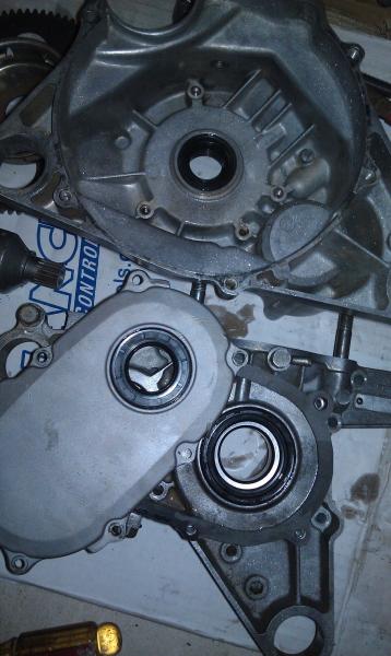

Not trying to rain on Joe's parade whatsoever. Just very, very glad someone had the balls to make it happen.
I installed the OddATV1 Engine oil seal kit in my Engine today, and they install & fit great.
