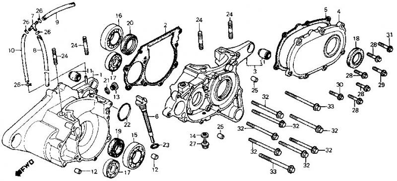

91203-VM0-004 OIL SEAL, 45X62X8 Number 20 in the picture this is the seal that seals the crank case, its located behind the balancer gears.
A search returns all kinds of 45X62X8 seals on the web anybody tried any of these ?

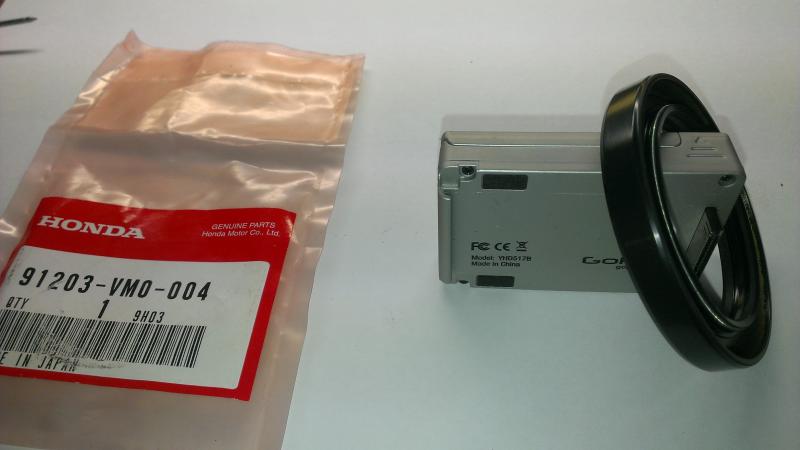

just received and update to this thread
I have brand new seal out of the pack
they are a double lipped seal with 2 springs one either side
they are getting hard to find
see att pics
someone is not doing there homework and it will cost someone a Engine rebuild

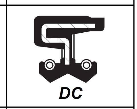

Ouch...that was like $59.95 + shipping for the seal kit, right? I guess they tell you the seals are aftermarket, just not that the 91203 is the wrong type. And they're charging FIFTY-NINE NINETY-FIVE + shipping for the same aftermarket stuff you, me, and Dick Trickle can buy on eBay for $14.50 + shipping???????? That ain't right, especially for the WRONG parts that will NOT work!! >=(
Needs to be a 45x62x8mm "DC" type seal. Same style as some fork seals...like this one that's preeeeeetty dang close in size...http://www.ebay.com/itm/Fork-Seals-45x6 ... 2575d2452d" .".." .".." .".." .".." .".." .".." .".. Who is making these? Why can't they make one in the size we need?? I emailed them, so we'll see.
If you can find them, make them available. Somewhere in some shop's basement in Japan, sits the mold set for this part.
I have some sales contacts at Goshen Rubber and Parker Seals in Indiana. Wonder if they can make any of this stuff even if its without the springs?? Even if the 1-off single cavity tool will cost like $1000 and then each part will be $5.00...if someone could make 100 of them, break-even price would only be $15.00 each. That's not all that bad, even if they came without springs. But...that's all hypothetical.
File comment: Parker Seal Design Guide

Very true! But one has to assume Honda did what they did for a reason. Crank case pressure + fluid on the gear-side and fuel mix other other side, per textbook, would require the DC type and typically in hard Nitrile/NBR.
Not sure why the 45x62x11DC fork seals in the ebay link about wouldn't work. 3mm is only .110". Is there anything that mates right to the outside of the seal? There's a collar and the balancer gear, right? Is there room on the bearing-side to bury the seal that much more? I wonder if it could work?
PostPosted: Tue Feb 12, 2013 11:42 am
This seal would be Parker Seal part number 45-62-08MDCN11, which translates to 45x62x8mm size, metric, DC-type, NBR material, carbon steel insert, and carbon steel springs. I sent them an email asking if its available via special order.

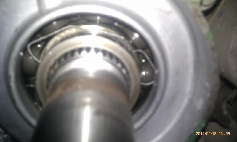

PostPosted: Wed Feb 13, 2013 3:31 am
Well that's good to know
the fork seal your talking about might be ok as there is no inner lip to tap up to but if your tap the seal in to far
the seal will rub on the crank bearing
as you can see by the pics the i taped it in to far
the new one is now flush with the case
that 2mm might have to hang out
File comment: tapped in to far
File comment: and the inner lip rolled and the spring got eaten be the main bearing
