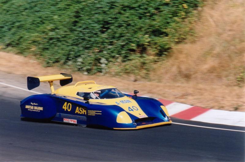

I used to race a rotary powered formula atlantic car. The rotary is a two stroke and incredibly loud. The most effective mufflers were either very restrictive (HP loss) or a straight through design that was very long and had lots of packing. It was about 6" dia and 3' long (would not fit on my race car). I experimented making mufflers for my race car to make the noise limit. I was successful but had to run two restrictive mufflers one behind the other. The straight through design (like the DG) ain't gona work well. High frequency does not go around corners well. Maybe two glass pack style with elbows MAY work. Experimentation is required here.
