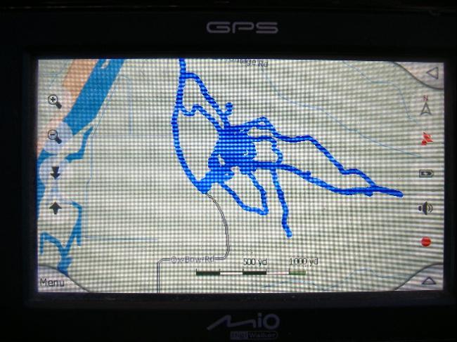

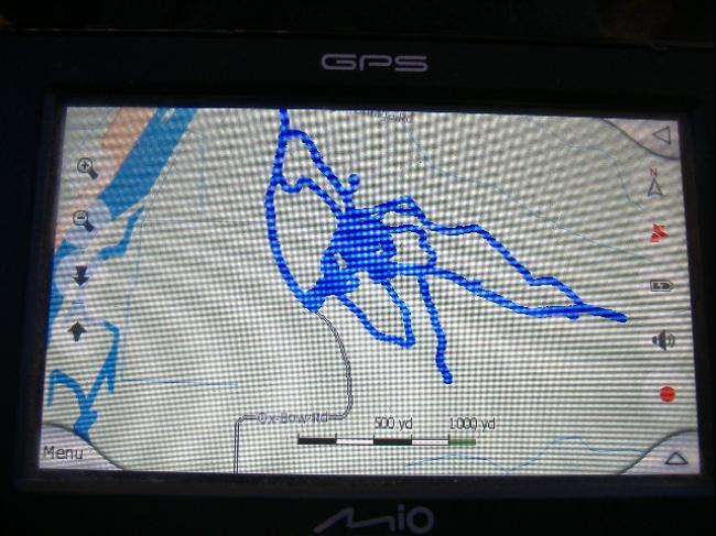

PostPosted: Fri Nov 23, 2007 11:41 am
Here are some shots off of GPS... I have an arrow on first shot where you bought your fuel... And yes the place can be a MADHOUSE!!! Yesterday when I arrived they were 10 deep on the street to buy GAS. I do not use this place to buy fuel because of the long lines and slow service!!!

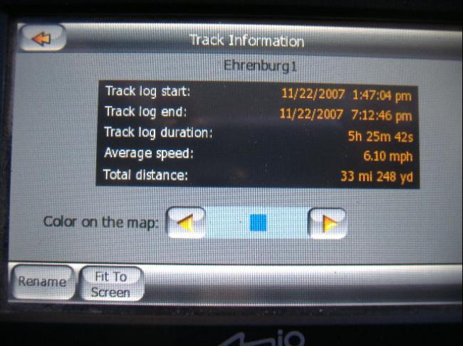

PostPosted: Fri Nov 23, 2007 1:57 pm
6.10 miles an hour. Need bigger carb. just kidding. just gelloues.

PostPosted: Fri Nov 23, 2007 3:49 pm
I thought I was keeping a good average speed once until we stopped to take a break, on mine it factors in the stop time with your average...

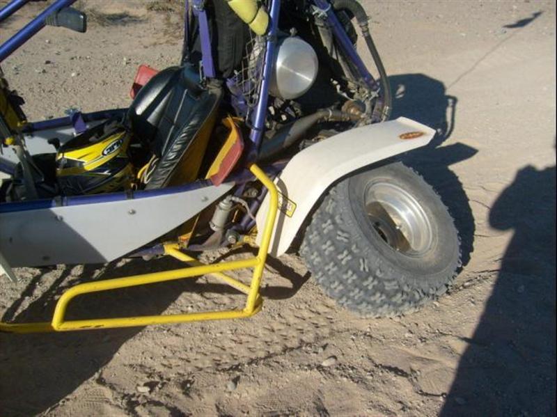

The cable broke at the stress riser created by the clamp.
I would look into fabricating a steel link.
Pivot points need to be dead center of each U joint unlike you see in the pic...

PostPosted: Sat Nov 24, 2007 4:44 am
Something like that would be great!!! I wonder if there is a need to make that where it expands a hair in the travel up and down??? Have a pin hold it from full extension...

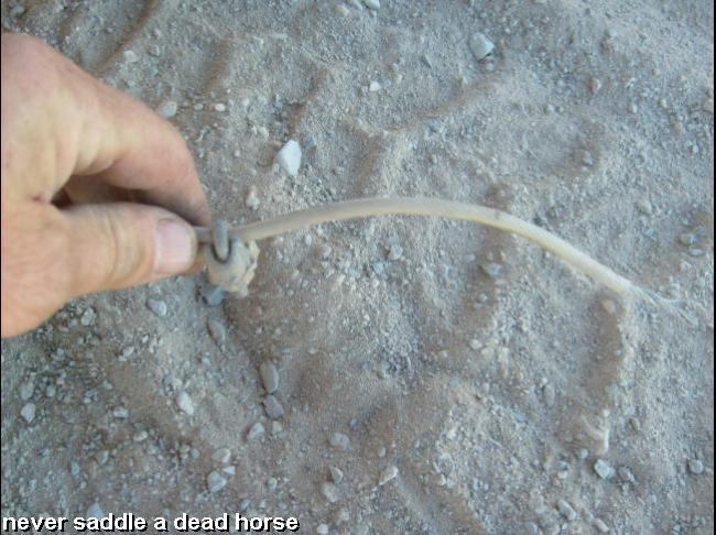

PostPosted: Sat Nov 24, 2007 4:49 am
the wire that broke... DID I have it mounted wrong... The clamp? Never saddle a dead horse, but I never made this type of saddle???LOL

PostPosted: Sat Nov 24, 2007 9:23 am
You didnt loop the ends just over lapped them?
I assume the plastic coating didnt help either...
I say make the solid links like in the pic above its adjustable so you can set the extension tension?

PostPosted: Sat Nov 24, 2007 12:07 pm
How did you get it back on the trailer?[/quote]
I had made a stake from some channel and mounted a winch on this so I could winc up on top deck, or in this case lower deck while at home last week... I am glad I did it went rite up!! I ain't sure how I'll get it down, and rolled into small shed. I want to do that Sunday at home, drag off my shocks and send off to works to see what that will set me back...
Looks like I am buying myself some parts for Christmas!!! HO HO GO!!!
