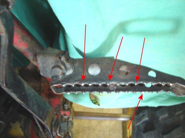

The pegs on my 83 ATC250R are well worn so I did a little tune up on them whilst I was tuning up the skid plate.
The pegs are spring loaded so if you his something they can flex back, in this pic the tabs marked by yellow arrows wear into the body of the pegs so I gave them a little zap with the mig welder blue arrows to build up the area where they are worn.

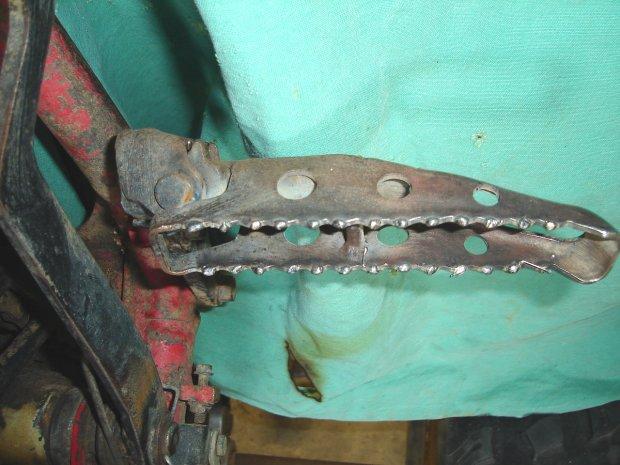

Also the teeth on the pegs is well worn so I gave them all a little build up with the welder, gave my kid a file so he can bring them back to a point.

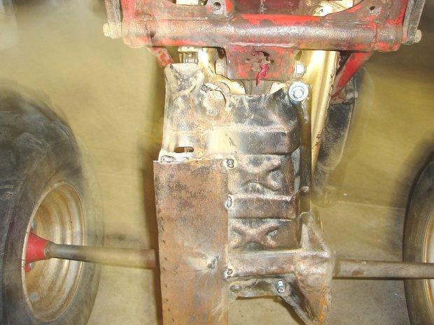

Poor skid plate has been removed and beat back with a hammer countless times, I had to add a piece of metal on one side because it was in so bad of shape heh.
