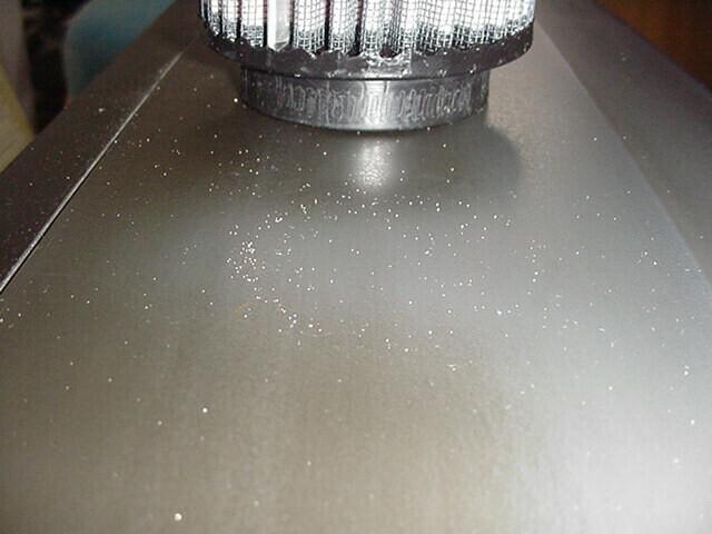

PostPosted: Tue Feb 17, 2004 5:03 pm
Ok now they have been washed I give them the "bam" test and smack them on a hard dark surface to see what amount of dust was inside...
File comment: They will get washed and dried one more time before use, don't really matter since they are prefilters and the fresh K&N oil should hold what ever dirt left behind in the filter?
http://12.215.127.130/prefilter2001.htm

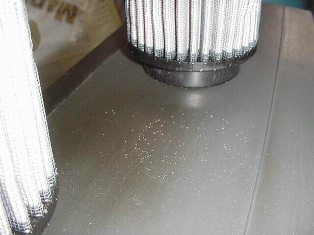

File comment: Other filter is not as bad.

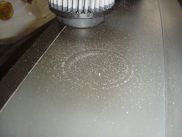

File comment: Yes that on the inside of the ring came from the inside of the filter hehe
