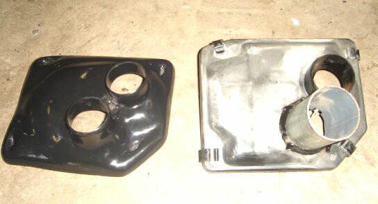

Since I introduced the dual intake mod and pre filter mod for the Pilot to the Pilot Odyssey world many have put their own little twist on it and their are plenty of variations out their. http://pilotodyssey.com/intake-mod.htm
I had seen pics of the after market lid the Aussie guy (aussiduner?) was making but I never seen one in person so Mudbogger sent me one for evaluation at first glance I don't see it sealing very well where it connects to the bottom half of the air box, the stock lid leaks a little but this one looks like it will leak alot more (haven't tested it yet just looks that way) I think that could be helped by adding a little foam where it meets to seal.
The second thing I noticed is the top is sunken down into the air box, I am sure anybody that has one of these has noticed the same thing, even with the stock is modified for a dual intake the Pilots air box is too small, when you rev the Pilots Engine on a modified Pilot you can see the sides of the air box suck in momentarily ("amazing powers of observation") so reducing the volume of the air box is troublesome to me, I been putting off fabricating a new air box lid for years I was going to make use of all the extra clearance Honda left around the stock lid to increase the volume.

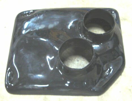

All is not lost with this lid, being the type of guy to always have to fiddle with things I broke out the propane torch and started heating the plastic, after carefully, slowly heating both sides and in the right spot I got the plastic to droop to the outside where it belongs.
PostPosted: Sun Jul 09, 2006 5:58 pm
Before and after cc measurments indicate that I increased the air box volume by 125cc without even really trying if I had a smaller tip torch and took my time I bet I could squeeze this lid to +200cc increase in volume.
PostPosted: Sun Jul 09, 2006 6:11 pm
I wish someone would have consulted me before they went to the time and trouble to make a after market air box lid its a shame to spend the time and make it reduce the volume, I already had run the calcs on the air box volume long ago I could have used my lid for a mock up for the first mold, built up layers of bondo on the lid until the lid would just barely squeak by the interferences on the Pilot but still fit, I would also have raised the inlet openings by 2" I estimated years ago I could increase the volume by 630cc I already modified my bottom half of my air box by 145cc just by filling it with boiling water and letting the water stretch out the bottom some, you cant really tell by looking but by cc-ing the volume of the box before and after its their.
I remember someone commenting they made the air box lid because mine looked "crappy" maybe so but it also performs.
