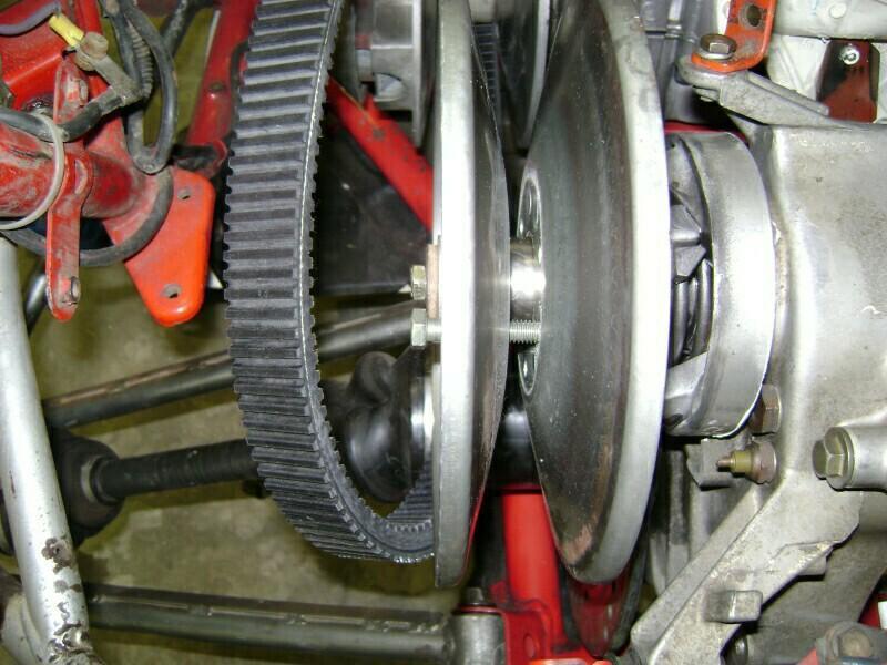

I use a Comet 90D driven on my Pilot I am told its the same as the stock FL350 driven.
I tapped one of the holes so you can run a bolt in and spread the driven and change the belt easier just like the Pilot driven.
Maybe you have seen this before?

what size??? tap....and bolt...
PostPosted: Sat Oct 02, 2010 11:41 am
5/16 bolt.

Common on snowmobiles. My Polaris has a threaded bent rod that you spin into the hole without needing a wrench. Pretty slick.
