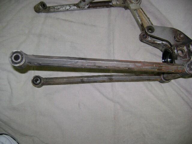

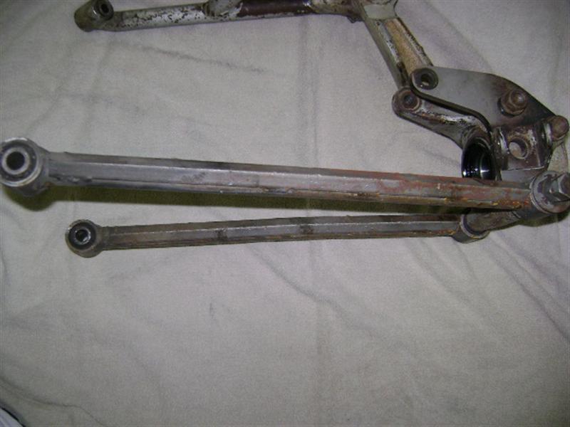

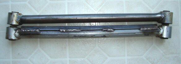

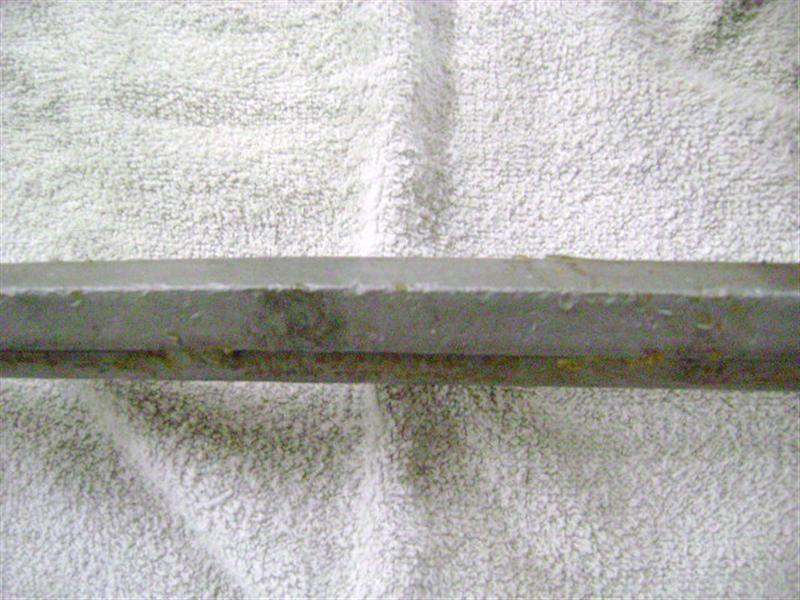

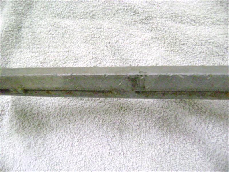

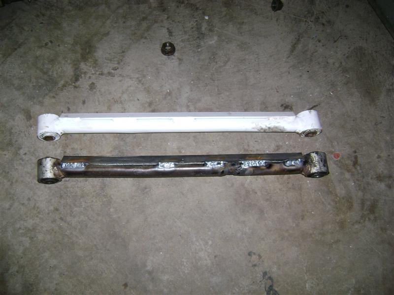

Its no secret the trailing arms on the Pilot are a weak link first rock you hit and they are bent,
what I do is straighten them out then weld on a piece of angle iron to add strength and to
provide a skid plate to deflect rocks and such just like my Tie Rod fix http://pilotodyssey.com/tierod.htm
NOW most of your arm chair experts that hang out in the POOA comunity will tell you
the arms are the weak link and are meant to bend, probably so but my 9 years of hard testing
http://pilotodyssey.com/hosertrip.htm has shown no ill affects from either the trailing arm
mod or the tie rod mod like the arm chair experts ASSume, when these guys boast
their claims even if it sounds good or plausible please ask them to show their math
like I have done because their is all kinds of things out there that look good on paper.
Two more TESTED hoser innovations brought to you FREE by PilotOdyssey.com

Thought so, the two in the pics are the only ones I could find I will dig around some more
to see if I have more, the other 2 might be in the RV, I will weld an angle on the
other one in the pic.
You need all 4 if your going to ride in the rocks like you guys have out East heh
20 bux each you pay the shipping, this is exchange I need your old arms for a core so
I can straighten and modify for the next guy...

The angle iron is a great way to prevent the rocks from denting up the control arms which would further weaken them. You still have a weak section near the bushing that would allow for give and breakage in the event you wack a tree. When Brooks post his pics you will see that I welded angle iron on all the sides that face the front of the machine even the inside of the rear part of the A arm. Definatley a good investment for real New England rock garden riding.
For $20 that is a heck of a deal. Do you have a bunch of illegals working for you? :-)
PostPosted: Wed Nov 30, 2005 10:09 pm
Can you post pics of the a arms not sure I follow you, I was thinking of making mini
skid plates like the quads have for the front arms this would give you a lifting effect when
you hit them on the larger rocks heh
No illegals working here I just do them in my spare time and only wish to recover a little
of my shop cost in return, Pnuts brother is a Iron Worker he can probably find scrap
or drop offs of the angle on job sites and do them for him for free?

Mudbogger your arms have been straighten and hoserized I will be shipping them back tomorrow.
I didnt do anyhting to the forward control arms other than give them a quick ride on the wire wheel to knock off 6 layers of paint...

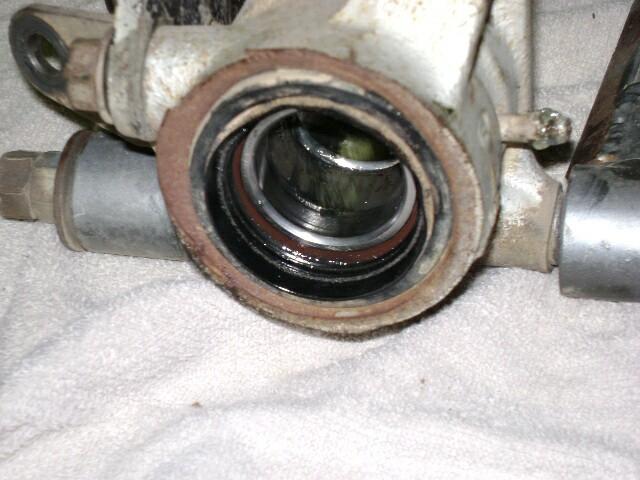

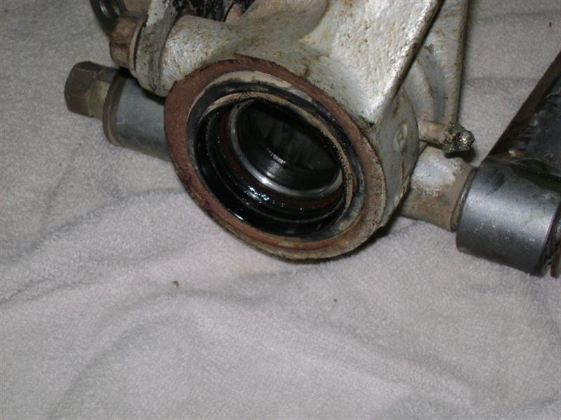

I see some grease fittings on those rear hubs. They're not factory, correct? I didn't notice any on mine, but they could be smashed off and filled with crud and paint.
PostPosted: Thu Feb 28, 2008 3:56 am
Good eye, almost looks factory huh, the grease fitting is By hoser.. I installed it about 10+ years ago... No water or dust gets in when its full of grease, you gotta be careful when filling it will push the seals out it almost needs a bleed hole too.

hey hoser - those hubs have a grease fitting? Was that added? i don't remember seeing those on my pilot. Did you remove the seals from the new bearings you installed so the grease can flow?
