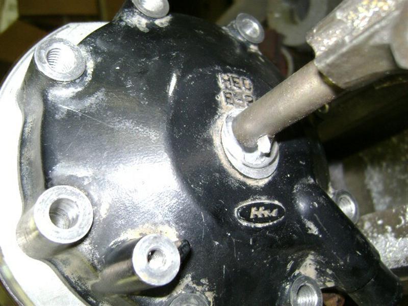

Now I attack the hole with a large drill bit, its still not center so I had to abuse the bit a little :shock: that's ok its one that came in a coffee can full of other bits I bought at a garage sale for 2 bux..

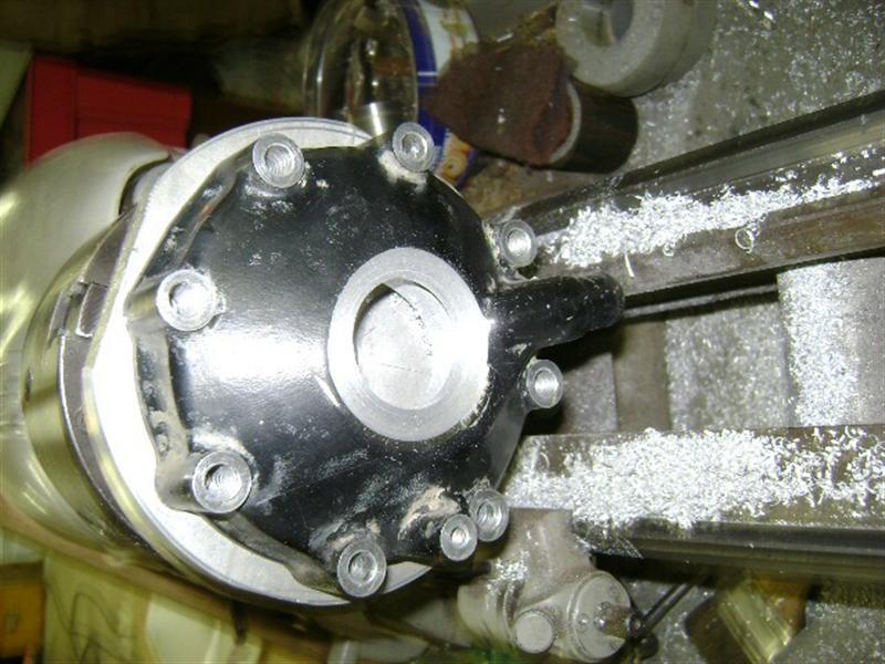

Now the hole is large enough I can use the boring bar..

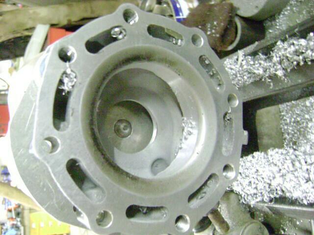

Hole, time to flip it over and enlarge the other side
