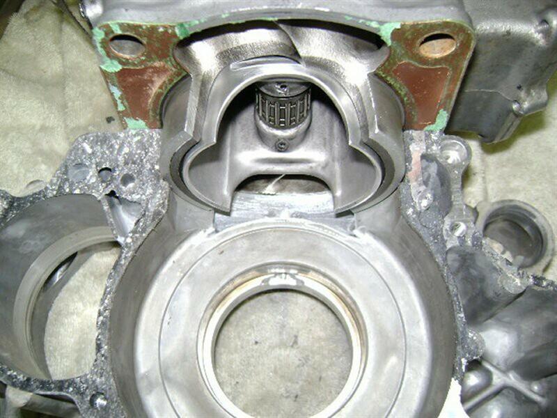

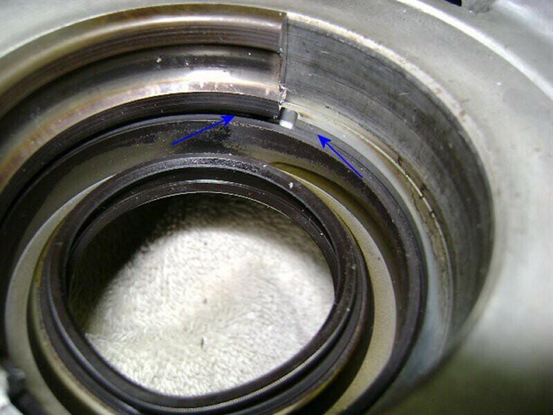

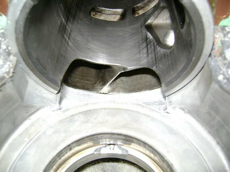

Look at this pic, with the old seal installed and the cut away bearing race you can see the opening is almost blocked off completly
PostPosted: Sun Jul 01, 2007 3:11 pm

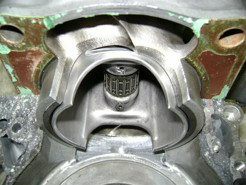

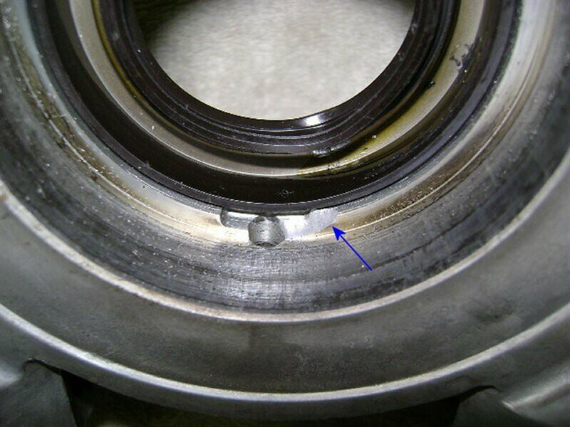

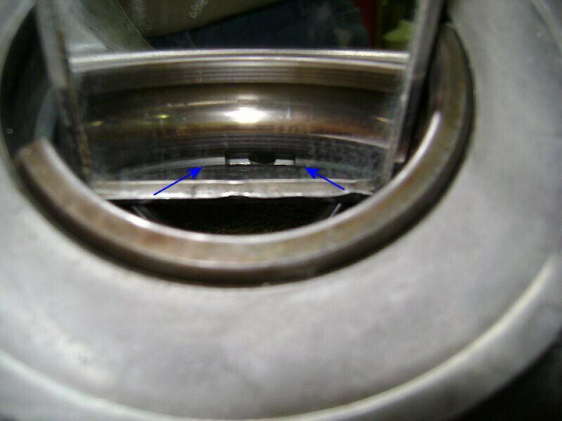

Now with the bearing race installed and using a mirror to see the opening the arrows point to the areas it will be slotted for more flow
PostPosted: Sun Jul 01, 2007 3:12 pm
Some material removed increasing the distribution area.
PostPosted: Sun Jul 01, 2007 3:13 pm
A little more hoserized crank case mods
PostPosted: Sun Jul 01, 2007 3:14 pm
I will sped a few more hours "hoserizing" or enhancing the crank cases.

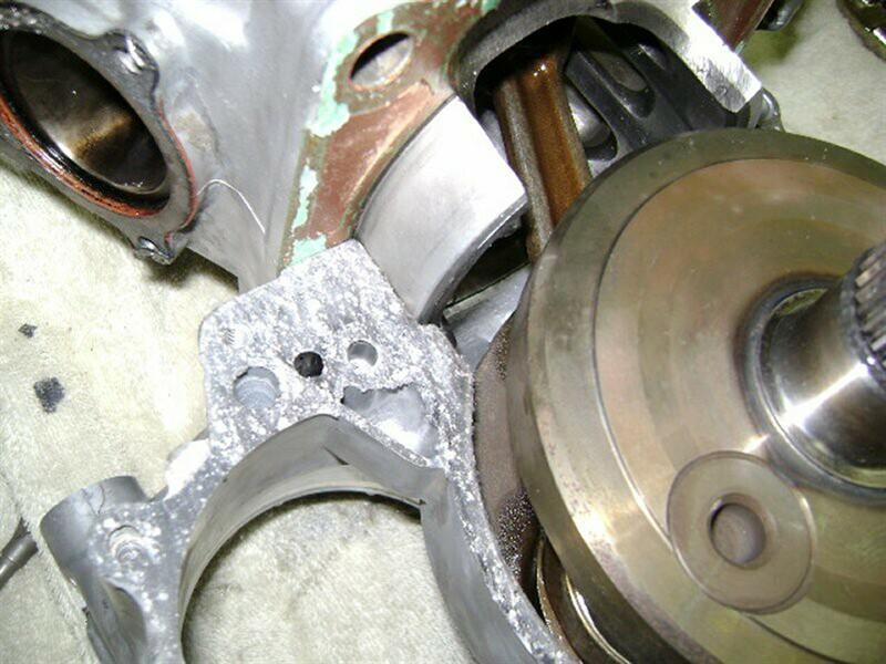

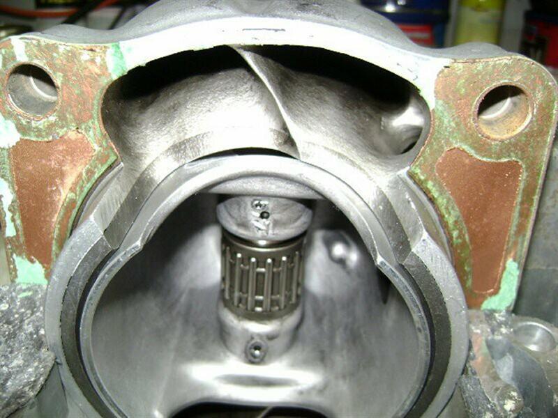

Here is the cylinder bolted to 1/2 the crank case to give you an idea what it looks like inside, not much I can do here until I have the new cylinder, plenty of miss match, casting flaws etc.

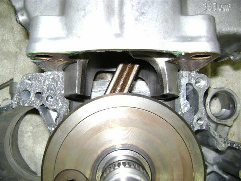

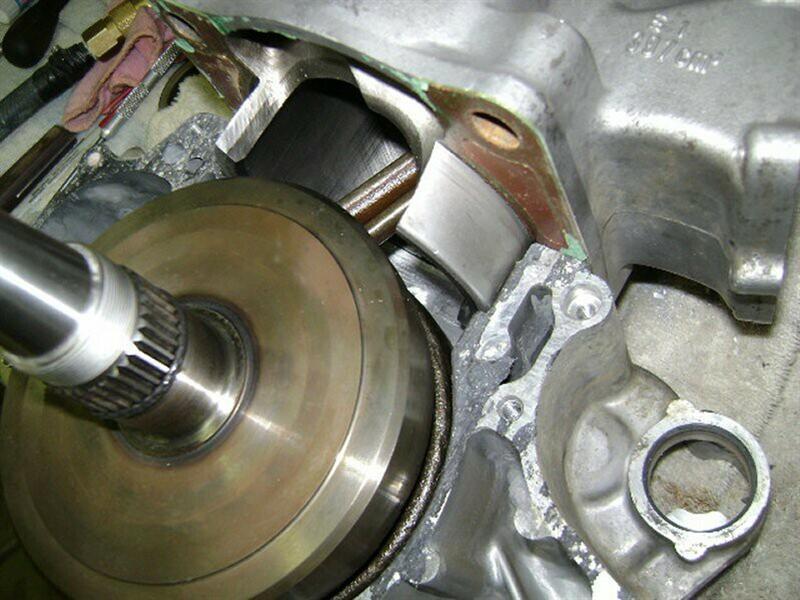

Ok lets add the crankshaft, case matching
removing casting flaws
hoserized cases

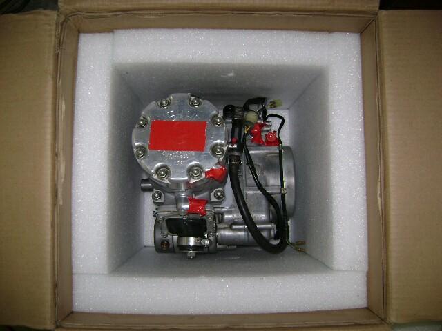

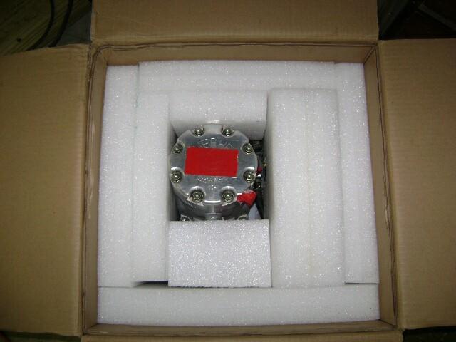

Best packing job I seen to date.
PostPosted: Fri Aug 31, 2007 8:25 pm
Pilot Engine fits perfectly
Each piece is notched and custom fit to lock the Engine in place.
PostPosted: Fri Aug 31, 2007 8:26 pm
Even the top piece is well thought out it has notches to ease removal, not sure what kind of foam this is, its great stuff, maybe TD can fill us in.

The Foam is 2" Thick 1.7 Lb Density Polyethelyne. It's made by either Sealed Air or Pactiv.There may be other manufactures in other parts of the country. Any Packaging or Crating company usually stocks it.

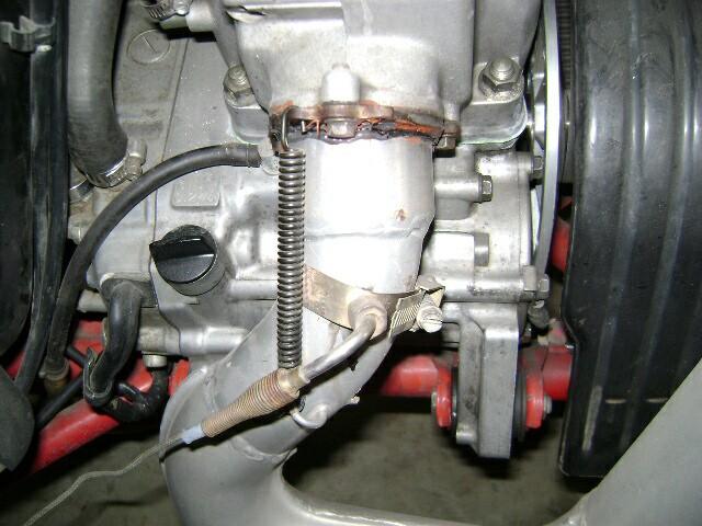

Seen this? viewtopic.php?t=1932
I locate mine about 3" from the end of the pipe or about 6" from the face of the piston, you need to be out of the 'wet line', you need to take into consideration the springs location when you locate the probe, I have seen others locate them on the bottom side of the pipe too, my rev pipe came with the hole already drilled so that's what I went with and where I located the hole on my torque pipe too.
Please remove the pipe ( I know its a pain in the ass) to drill the hole, look at the animated gif in the link I gave above see the returning pulse wave I hate to see a metal shaving sucked back into the Engine.
