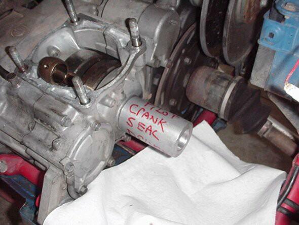

Pilot clutch side crank seal intall tool

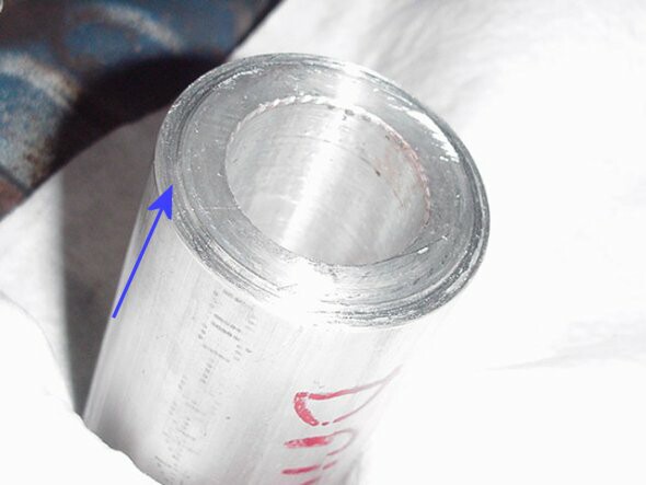

This end limits the depth you can push the seal in and lets you install
the seal square and flush with the cases.
