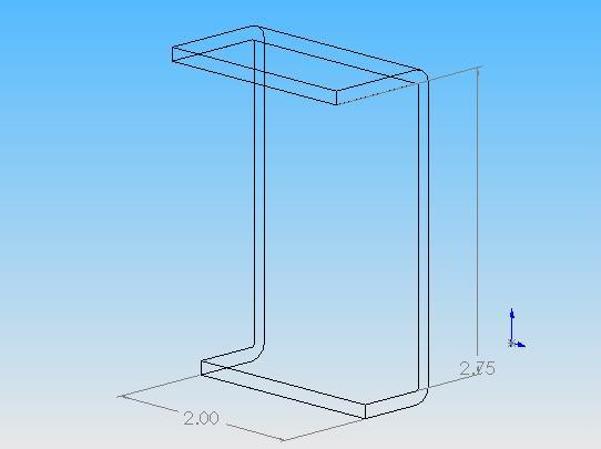

On this past trip I forgot all my clutch tools on the bench so had to borrow from others that were smart enough to remember theirs (thanks Dennis and Fed) but I also noticed they still are using the THREE HANDS "billet" homo over priced POS clutch holder tool they bought form someone else.
I have brought this up before and post pics before in the past but feel the need to post it again after being reminded just how poorly design and worthless the 'other' holder tool is.
The holder tool I made and you can make is 1/8" steel about 1.5 " wide the width is established by the actual width of your PB clutch when installed on the Engine and torque ready to use, once you tune your holding tool to fit your clutch it becomes a one handed no eye tool, you can reach in and by feel install the holding tool in 2 seconds then LET GO the friction of the snug fit you tune into your personal holding tool by carefully bending the metal ends allows you to put 100% of your focus on removing your clutch not having your buddy hold your "billet" POS whilst your trying to loosen up your clutch bolt.
Trust me after you use my style clutch holding tool you will want to send your "billet" holder tool back to the guy you bought it from and tell him to stick it in his arse, now I know why people are so reluctant to make changes to their PB clutch tuning.
