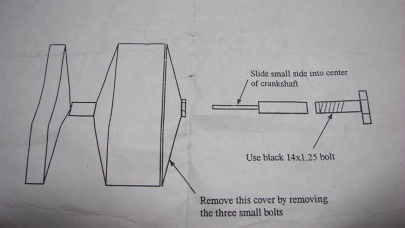

Anyone ever notice the error in the ATV Racing kit sheet diagram?
They state 14 x 1.25. :shock:
PostPosted: Wed Jul 18, 2007 10:23 pm
I just looked at the die I used to chase the bolt and it says 1.5 you think the die might be labeled wrong? It would be nice if we could double verify this so we know what is right...
PostPosted: Wed Jul 18, 2007 10:29 pm
Posts: 1419
Location: San Diego
The threads in their diagram are reversed too.
PostPosted: Wed Jul 18, 2007 10:30 pm
I went out and bought a thread gauge and that was when I discovered my reading to be diff to the ATV Kit.
Mine came out at 1.5

It came warped- although I didn't notice it at first. It was a brand new powerbloc from ATVR that had to be machined on the inner face to clear the starter/cases.
I talked to Neil and he told me that I can take off the outer part of the stock clutch (cover) and use the powerbloc pusher and a 14mm 1.5pitch bolt to pull the stock clutch. I'll see if it fits
Even here it states from Neil "1.5 pitch."
