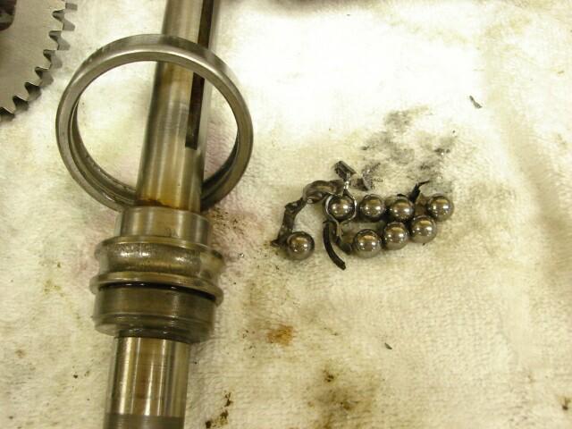

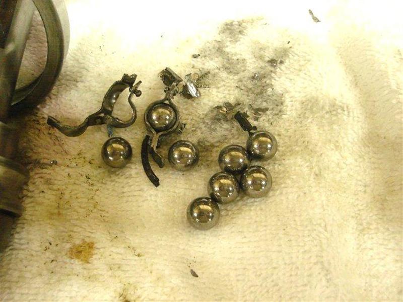

Lee here is the bearing separator and all the stuff I found behind the lower big gear you seen in other pics.

hoser - is that the same trans that you waited so long for the new final shaft for? if so didn't you replace the bearings then?
 Post subject: Re: bearing
PostPosted: Wed Apr 18, 2007 9:12 pm
YES it is the same trans, NO I didnt change the bearings they are factory original.

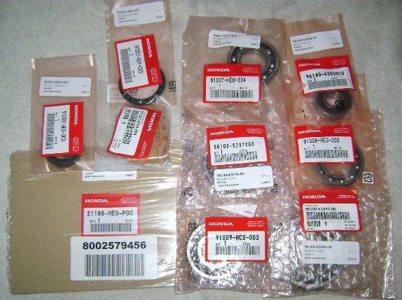

My trans bearings (6) and seals (3) came yesterday today was yard work day so hopefully tomorrow I will put my trans back together :-)
Thanks Service Honda for another parts order getting here ASAP I will find out if they sent the right stuff when I put it back together hehe
PostPosted: Sun Apr 22, 2007 3:24 pm
Yup Service Honda sent all the right parts and my trans is assembled with all new bearings and seals.

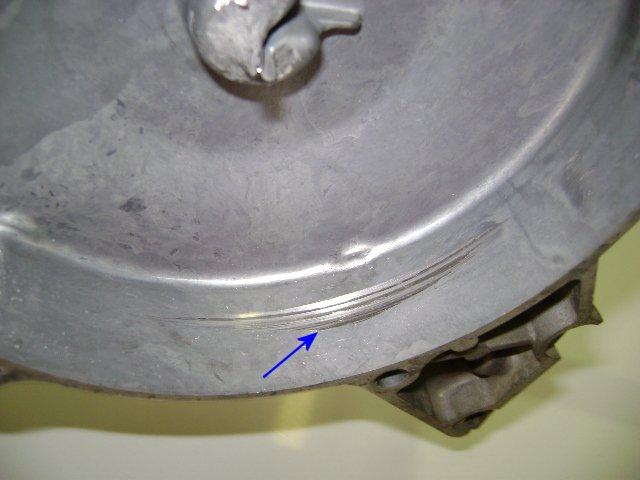

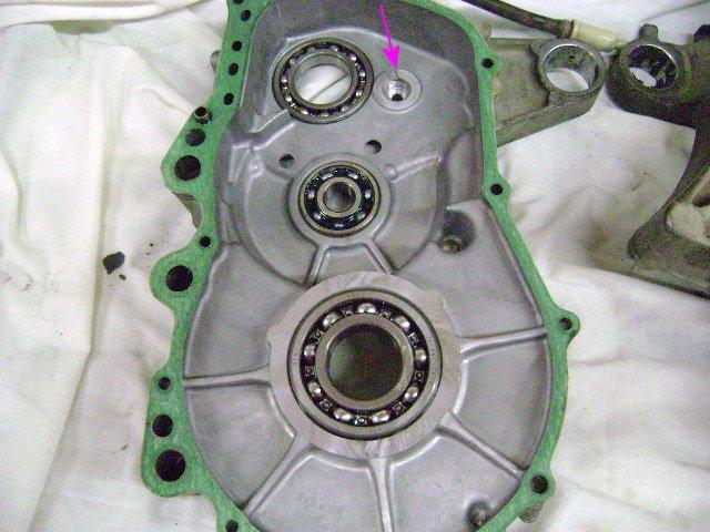

I noticed damage to the torque clutch cover, the funnel that channels oil into the input shaft to supply oil, lube, cooling to the bushing on the primary drive gear, it appears when the input shaft bearing was bad (all balls gone) this allowed the shaft to angle enough where the outside of the torque clutch could rub the cover I assume this is when the tail end of the input shaft broke off the tip of the oil funnel.
PostPosted: Sun Apr 22, 2007 3:25 pm
The oil flow path is the blue arrows the pink arrows is the JB weld repair I did.
Oil that is splashed and flung off the torque clutch (normal oil circulation) and runs down the outside of the torque clutch cover runs down and is channeled into the input shaft.
Missing the tip broke off the oil funnel might have created a oil starvation problem to the bushings causing a premature failure this is why its so important to study parts closely when doing a CSI.

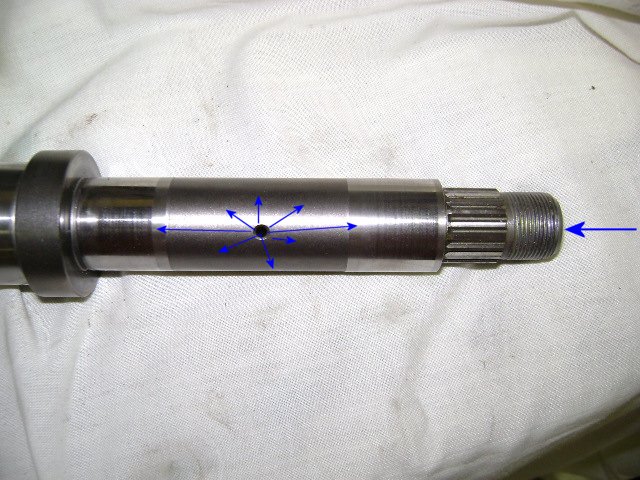

PostPosted: Sun Apr 22, 2007 3:28 pm
The oil flows into the right end of the shaft and is distributed out a hole in the shaft where it lubricates the bushings.

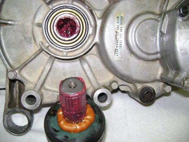

PostPosted: Sun Apr 22, 2007 5:12 pm

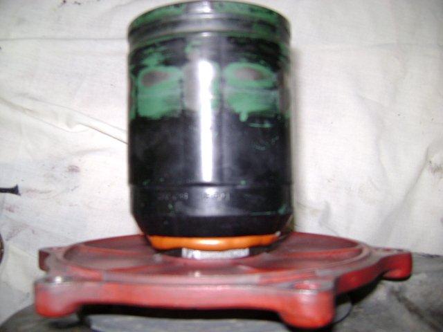

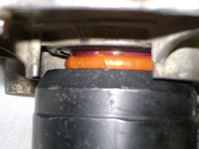

More assembly stuff, another hoser orignal.... grease up the inside of the final shaft good, apply a big bead of silicone caulk to the stub shaft then grease the splines on the stub shaft, apply some grease on the trans where the silicone will contact so you can get it apart in the future then tap in the stub shafts, this forms a water tight seal keeping your stub shafts from rusting.

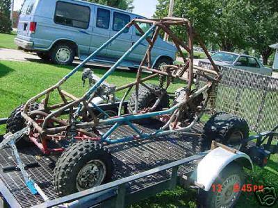

Any pics of the basket case Pilots?
Well you've seen one first hand since you delivered it...
The second one makes most basketcase machines look like a jewel...
Here are a couple picts of it....
Later
Dennis

Yeah I remember the first one, where did you find the second one, it come with anything other than whats shown in the pics?
PostPosted: Sun May 13, 2007 2:40 am
Online
Posts: 539
Location: Nebraska
Somewhere in Western Iowa
Don't remember the little town's name right now.
It only came with what ya see and a stock honda line front bumber...
It appears it was in a shed that caught fire...
All the plastic melted off of it, he still had the motor (( Internal Combustion Engine ? )) but wanted more than I would consider reasonable for it...
I got it mostly for the four good stock rims, drive train, and tranny...
It was dirt cheap...
