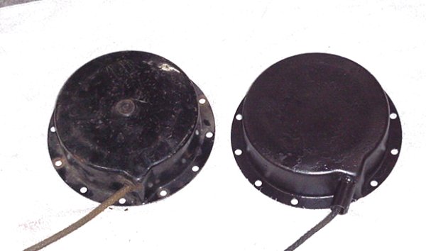

The recoil that came with my 440 Engine is from a snowmobile Engine for the
most part under the hood of a sled is pretty clean, keeping sand mud and dirt
out is not a issue, I welded on a short stub of pipe onto the recoil housing so
I could slide a heater hose over it to seal it up some.

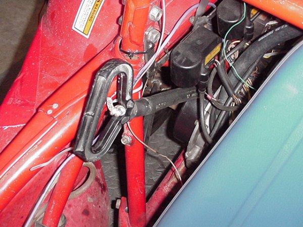

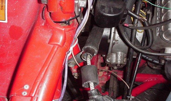

I took another piece of pipe and welded it to flat stock and
bolted it to the frame, another short piece of heater hose
goes between the tube and the recoil handel
PostPosted: Sun Sep 05, 2004 5:47 pm
Finish product, pretty well sealed now...
