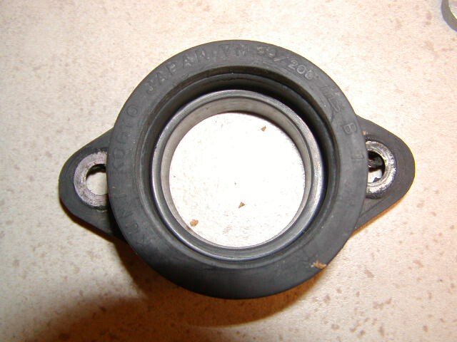

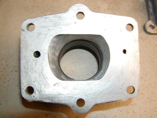

Seen this before?
Rocky
Rocky manifold
Rocky cycle

I put a 38mm carb in, and the machine came with V-Force-2 reed cage and an aluminum Intake, don't know where previous owner got these from however.
Any pics?
PostPosted: Sun Jun 28, 2009 8:41 pm
lutrev wrote:
Blackberry shots, machine is running fine, but will need to replace boot soon, and may as well upgrade reedcage at the same time.
Looks like a aftermutt billet manifold like seen in the ebay link above, once you remove it you can tell better, I would be interested to see how well it matches the reed cage..
If you just replace the rubber buy only something name brand like Mikuni or the rubber will fail soon again, I think the last rubber manifolds I bought like that I got right from the skidoo dealer, before you pay for them ask for proof they are genuine Mikuni their are a ton of knockoffs out their.
