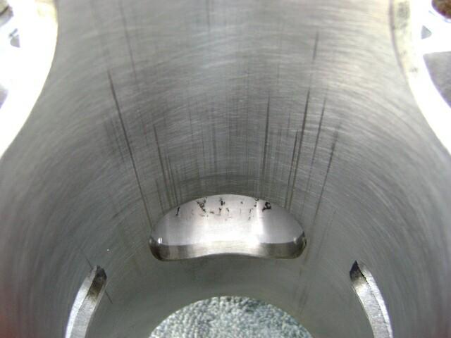

I put a light hone on the cylinder so you could see better the damage to the bore.

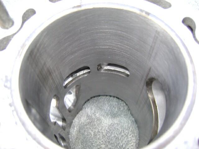

PostPosted: Fri Aug 17, 2007 12:57 pm
I doubt the groove in this pic could be removed by going to a 82.5mm piston if wiseco did make them I bet it would have to be 83mm to clean it up.

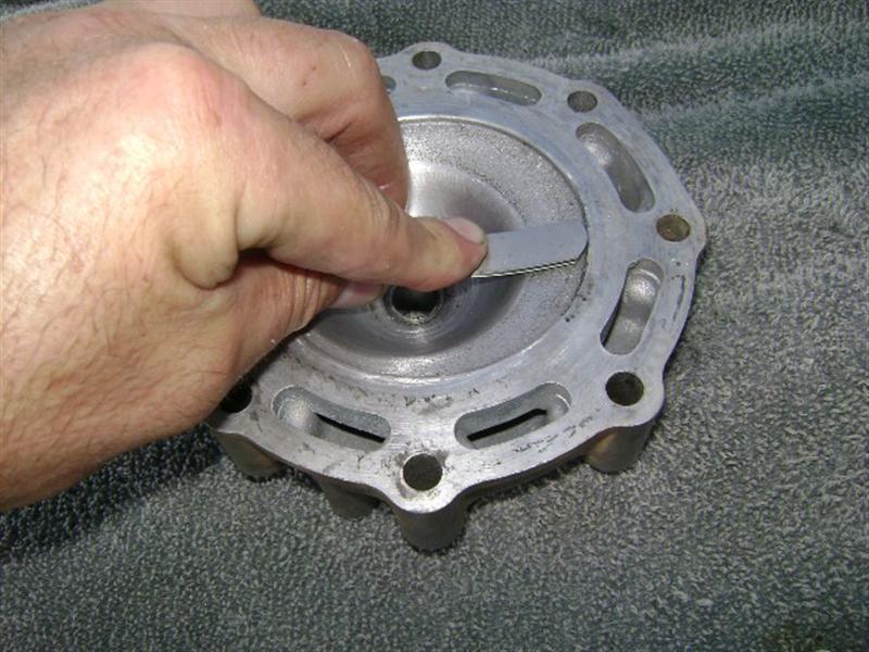

I can tell by looking the squish clearance is way off on this head but I have seen dozens of different heads over the years and have an eye for that kind of a thing, if your ever in doubt you can simply use a feeler gauge to see what it is, I strongly suggest checking the squish with solder through the spark plug hole.

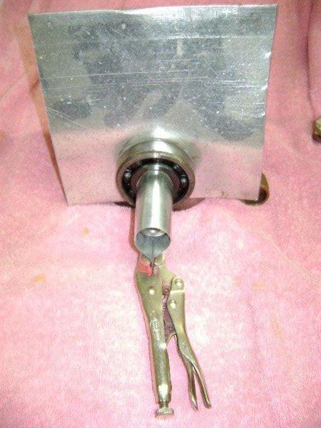

Back to the crankshaft....
Its not unusual for the bearing or bearings to get stuck on the crank, sometimes you can use a clam shell puller and pull them more often than not you have to grind them off, I have ground off many its a pain in the ass, as you seen in the other pics the crank was damaged by grinding you can avoid this by protecting it.
SO hoser tip #? sorry I lost count....
Protection is fast dirty and simple, I just cut a notch in metal then tap tap tap it down behind the bearing, then cut another piece of metal and wrap it around the end of the crank so that surface is protected.
No matter how good you are with a grinder you always seem to bounce off the bearing while grinding now when you bounce off the parts your trying to SAVE the sacrificial metal I installed will be damaged not the crank.

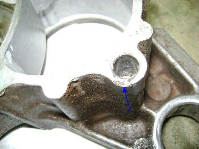

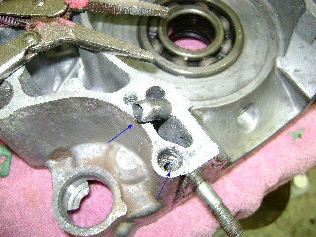

I removed the one and only dowel pin that was in the crank case, I see why its bent, its the WRONG dowel pin.
Hole is buggered up the threads are buggered up I will have to chase them with a tap to see if they are still good.

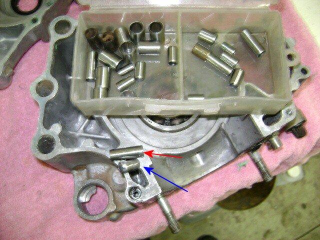

PostPosted: Fri Aug 17, 2007 10:06 pm
The red arrow is pointing to the correct length dowel the blue is pointing to the installed dowel.
In the box is my spare dowels I spent about 35 bux on them to ensure I had plenty of spares.

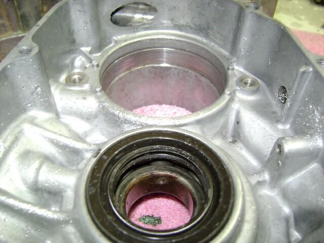

PostPosted: Fri Aug 17, 2007 10:19 pm

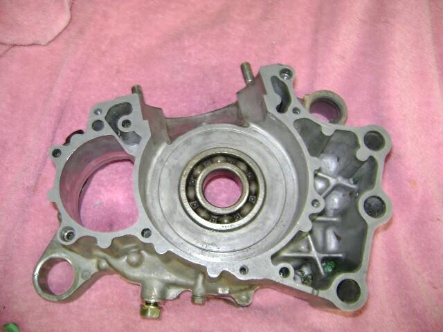

Some of the metal from the gears got between the balancer bearing and the case, their is quite a bit of wear, I installed a used but good balancer bearing into the bearing pocket you can feel slight movement from side to side, this is NOT good because if the force of my fingers an move it I wonder what the force of the balancer turning 8000k rpm will do?

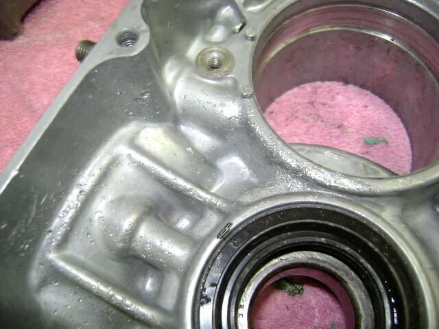

PostPosted: Fri Aug 17, 2007 10:20 pm
More close ups

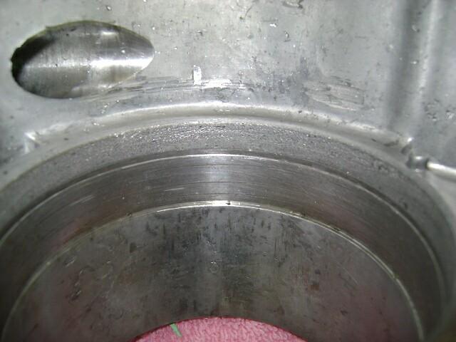

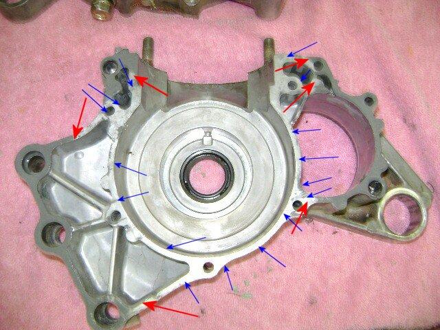

PostPosted: Fri Aug 17, 2007 10:22 pm
The rest of the inside of the cases all beat up, they will need to be smoothed out and all the sharp edges knocked down.
It hard to believe you could not hear all this noise going on or feel the extra vibration.
