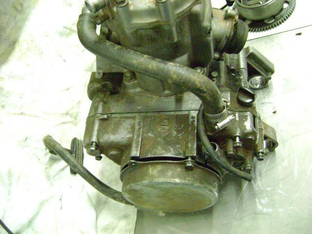

Here is a Engine afastcar bought off ebay from www-45thparallel-net Ludedude
It really starts here http://pilotodyssey.com/PO/viewtopic.php?t=2832
The Engine was suppose to only had about 20 hrs use on a complete rebuild, looking at the oil and grime covering the outside it looks more like 200 hrs.

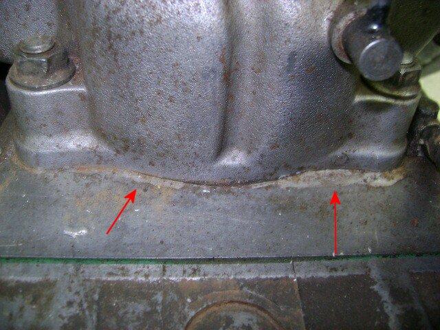

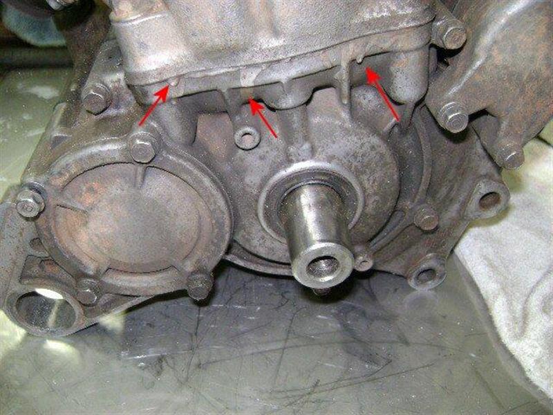

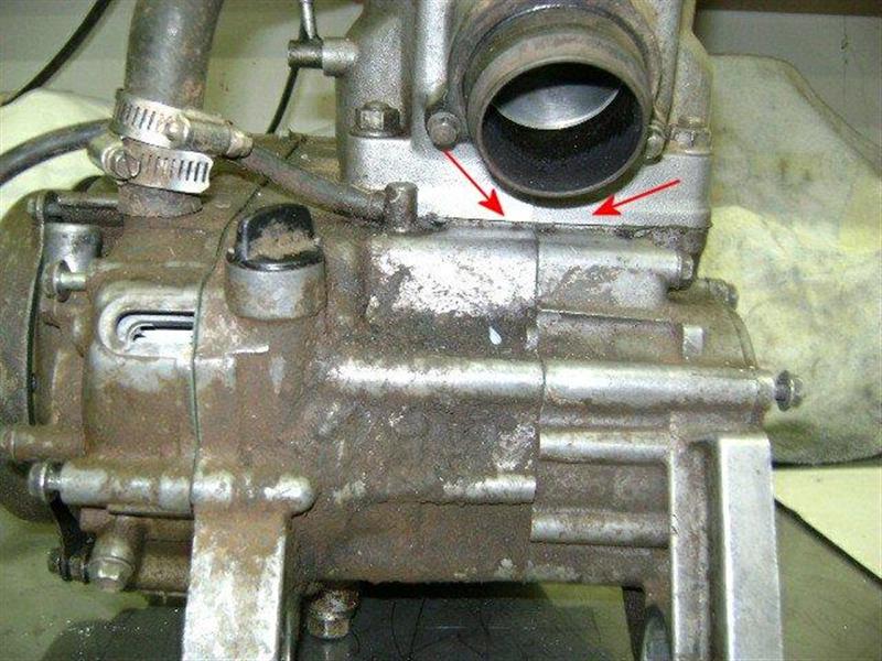

Gasket sealer running out all around the base of the cylinder.

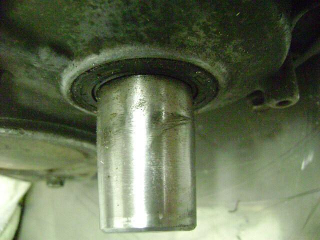

Its hard to see in the pictures but the end of the crank shaft where the clutch goes on is all buggered up it looks like someone took a sanding disc and tried to sand down the tapered area of the crankshaft.

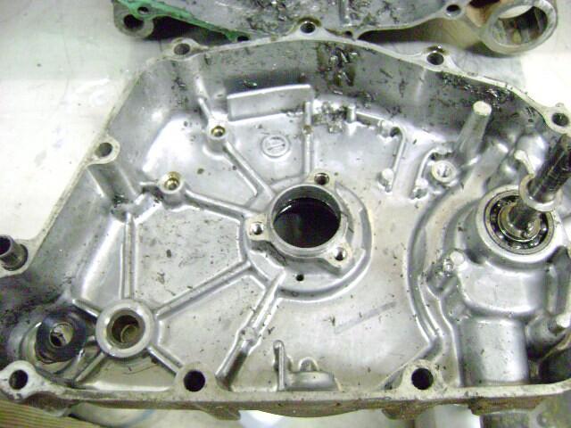

First thing you see when you remove the side case is METAL everywhere

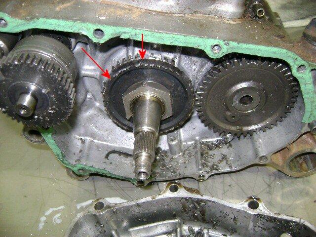

ALL the teeth are missing from the gear on the crankshaft that drives the balancer.

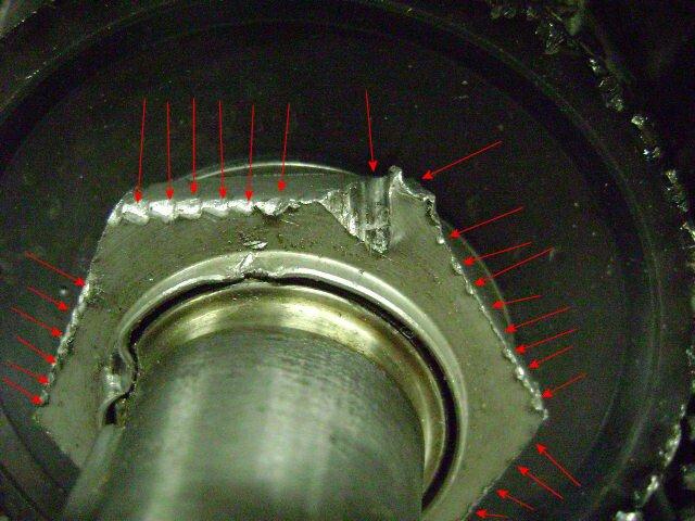

PostPosted: Wed Aug 15, 2007 2:01 pm

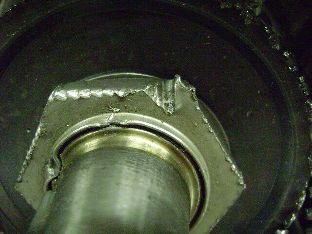

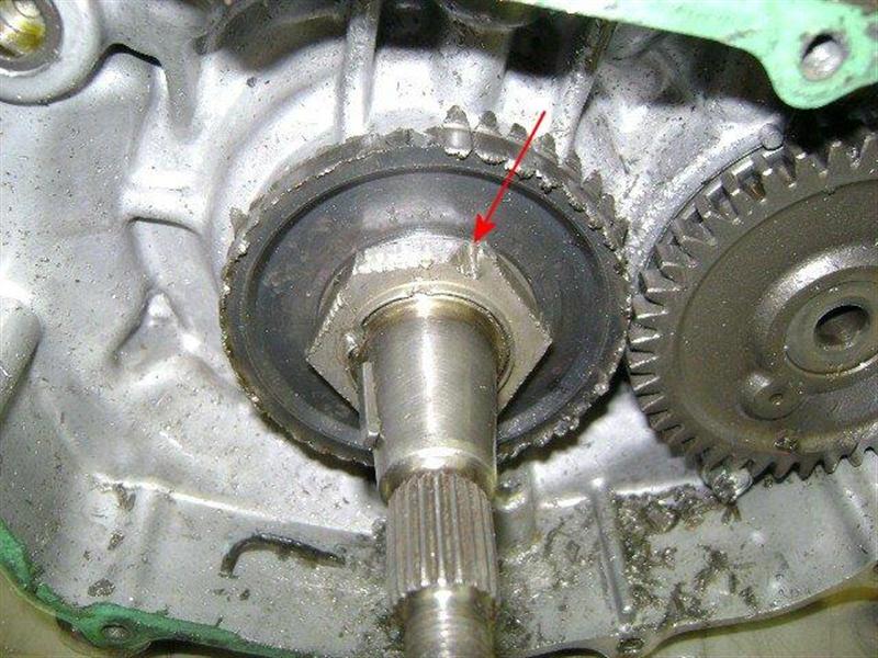

Looks like someone tried to remove the nut that holds the gear on with a chisel or some other type of CAVEMAN tools, this really has stupid written all over it, I bet if the socket required to remove this nut was "Billet" or made from "Carbon Fiber" the guy trying to remove that nut would own one...
You have to ask yourself when your beating on bearings that hard "is this good for the bearings?"

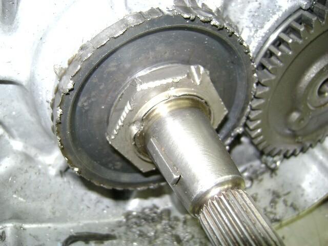

PostPosted: Wed Aug 15, 2007 2:03 pm
Busy little moron he was all the arrows are pointing to chisel marks on the nut

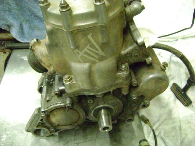

Looks like someone beat on the end of the crankshaft for some reason, this was no accident it was hit hard several times.

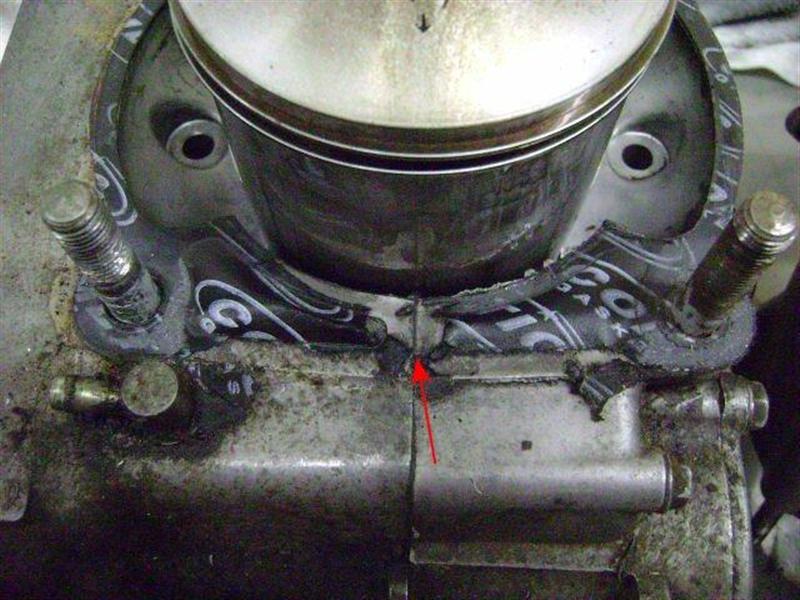

Next I removed the cylinder, the cylinder nuts were WAY over torqued I suggest the guy that torqued them go buy a new torque wrench!
The gasket is blown out right behind the exhaust this might account for the whole Engine with "20 hrs since a rebuild" being covered with oil, one would think with this much GAS and OIL leaking out the Engine and no doubt spraying on the pipe if the guy driving the Pilot didnt see the oil on the Engine he would smell something when he shut off the Engine.
If the Engine only has 20 hs on it the gasket was leaking since it was first started.

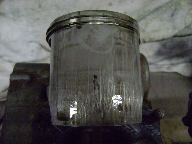

The piston as found, plenty of oil...

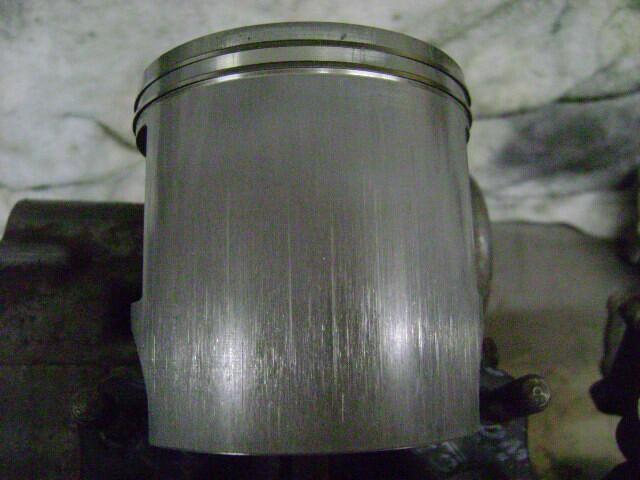

PostPosted: Wed Aug 15, 2007 2:35 pm
Oil removed.

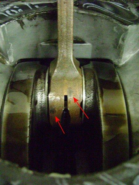

PostPosted: Wed Aug 15, 2007 2:39 pm
Their is some marks on the rod I am not sure what they are at this point.

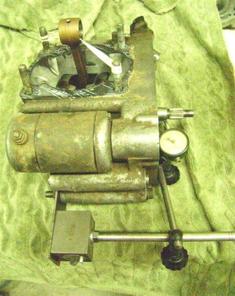

Before splitting the cases I checked the crank run out, on the clutch side the crank shaft is so buggered up where someone touched it up with a power sander or grinder I could not find a place smooth enough to take a accurate reading so I went to the mag side and setup the indicator where the flywheel rides it was .023 run out, you can see the crank wobble by eye!
Chicken before the egg?
Was the crankshaft bent or twisted before it was assembled in the Engine and the wobble is what tore up the gears then the flywheel and stator?
OR
Did something on the flywheel fail then the metal got between the balancer gears and twisted or bent the crankshaft?

The balancer is toast!
See the missing tooth? Green arrow.

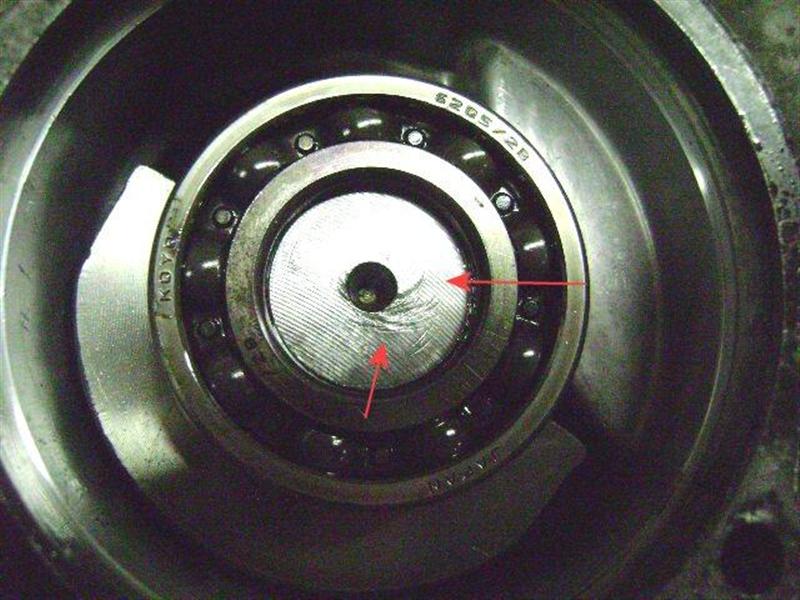

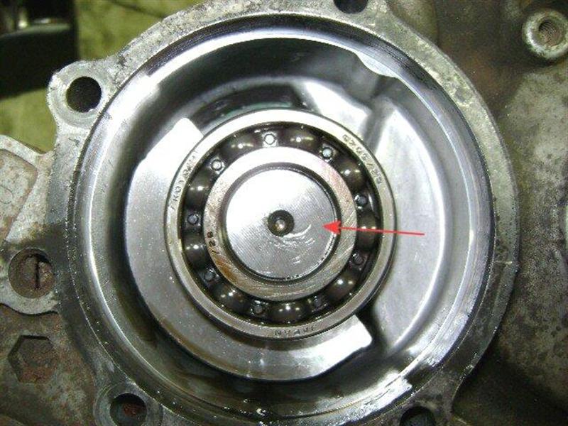

Usually once you remove the retainers that hold the balancer in place you can just slide the balancer out, this one wont come out so I went to the other side of the cases and removed the bearing holder cover and discovered the bearing is stuck on the end of the shaft so the balancer wont clear the cases.
Look at the end of the shaft someone has been beating on it in the past, is their any part of this Engine they have not used a hammer on? They should change their nickname to "hammer" or "BFH" it seems to be their favorite tool, FYI if you need a hammer to assemble or disassemble a Pilot Engine your doing something WRONG!!!!!!
I counted at least 9 blows with the hammer, think that's hard on the bearings? Maybe that's why both bearings are BAD ...

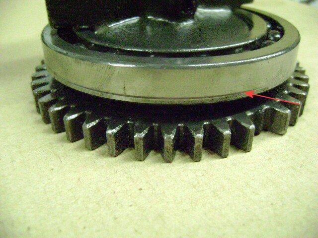

The bearing on the balancer has been spinning in the cases, see the red arrow above it the bearing is smaller than below it, I will have to measure the case to see if its worn out to much to be reused again.
