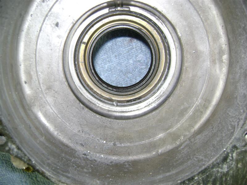

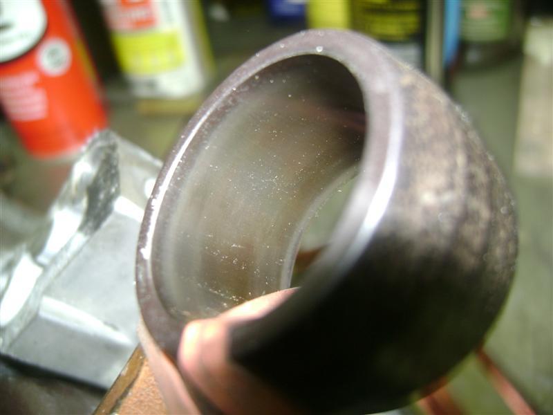

Twilight you notice the reeds?
PostPosted: Mon Aug 03, 2009 10:01 pm

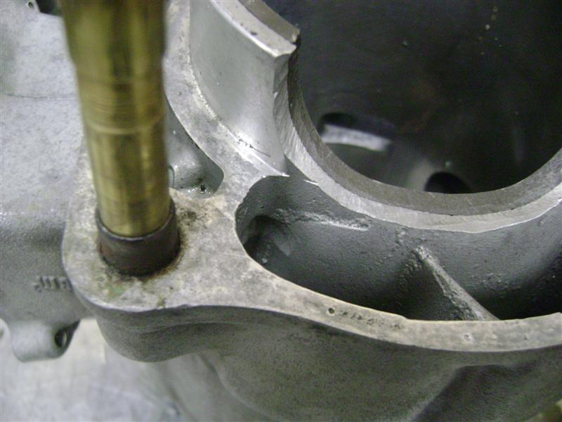

Cylinder dowel rusted in I finally got it out after messing with it for over an hour thanks to good ole PB BLaster, the dowel is junk so a new one will be used, taking my time paid off no damage to the cylinder the hole is not damaged or oversized.

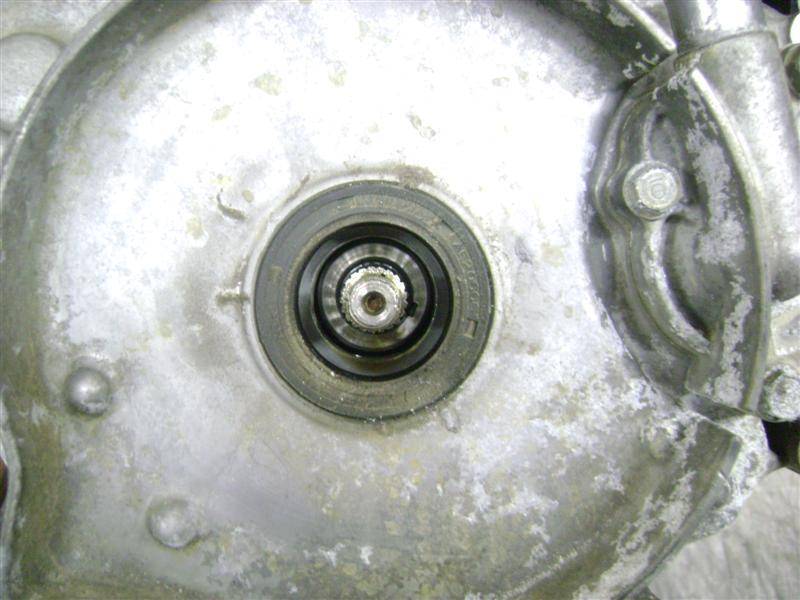

The seal behind the recoil was not leaking, strange they usually do heh.

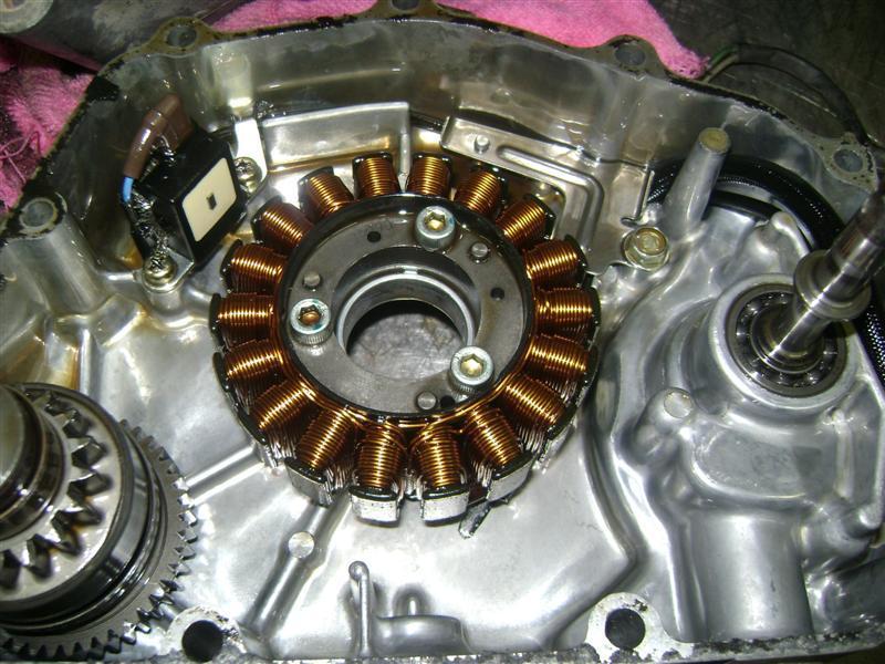

Stator cover off nice and clean inside, notice the remaining gasket material on the cases it will take a good 1/2 hr to scrape that all off and to ensure none of the fragments got on the inside most the time is spent trying to be methodical.

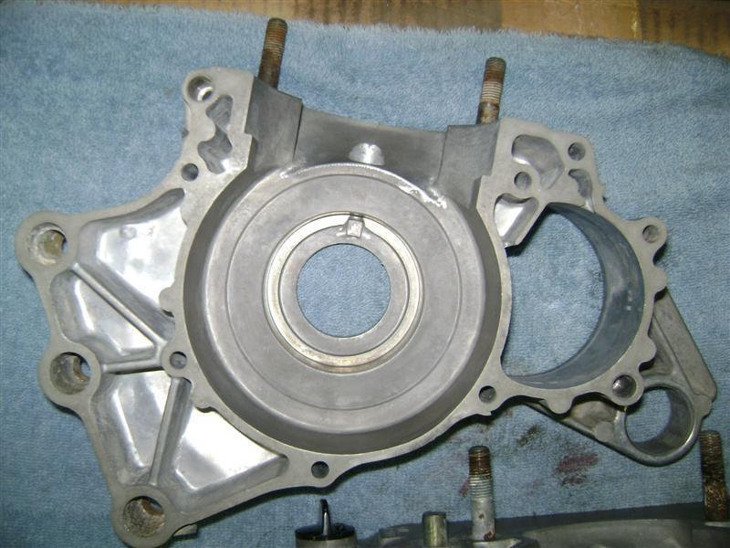

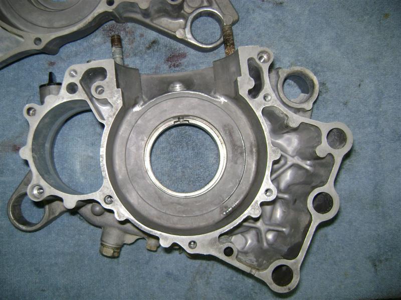

Crank cases split, no surprise to see all the aluminum bits and pieces .

Whew well after several hours of patiently cleaning your cases, your cases are cleaned hoserized (oil mods this is a hoser exclusive no other shop performs this task to ensure better oiling for your crank bearings and your balancer assembly), all the work was performed by hand using non destructive tools unlike most modern shops that will media blast everything, its time consuming but as other have said its worth the extra effort ,I put both cases on the surfacing plate and lapped something else your local re-builder will never do, the extra time spent lapping pays off their nice and flat, ready for new bearings.
I see the parts you ordered and supplied came today so I will assemble the bottom end tomorrow night, refreshing supplying your own parts Cha-Ching X2 you pick the supplier so YOU get the best price and don't have to pay any middle man mark ups.
