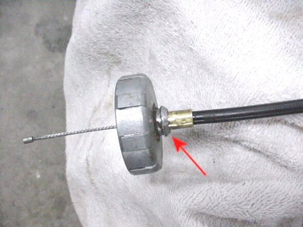

Once you get the old carburetor off you will probably notice that you can not remove the
throttle cable without taking a file and and gently file the top off the old carburetor or drill
two small holes in the side of the cap where the snap ring is, press from both sides while
pulling the cable out. Two, cut the cable flush with the brass, then drill straight down when
it hits the ring it will typically pop out (you will need to buy a new cable).
I think its a 5/16 bit but don't quote me on that, you can start small and work up till it
comes out.
I don't really know why Honda made it so if you need to destroy the top of the carburetor
or have to destroy the throttle cable.
When you file the old one off make sure you do not nick the cable or you will be buying
a new one.

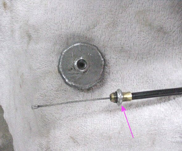

You will need to further modify the throttle cable using a file remove the brass ferrule on
the end of the cable and using a razor blade or knife trim back the black plastic outer
covering doing this will allow the cable to fit into the new carb.
