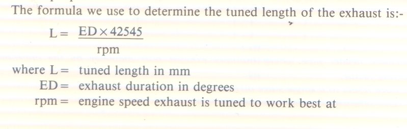

The Formula We Use To Determine The Tuned Length Of The Exhaust Is...

Ok today I dug this out because I wanted to see how much the exhaust duration affected the pipe length, this subject came up because of the burn back all the way to the bottom end of TD's Pilot Engine.

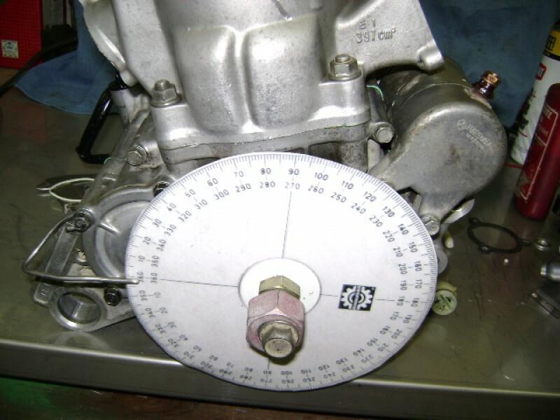

First I put the old piston and the PCP ported cylinder back on TD's bottom end then rotate the crank until the piston is just starting to uncover the exhaust port and start the blow down phase then I Zero the degree wheel, then I continue to rotate the crank until the piston goes all the way to BDC then comes up and recovers the exhaust port.
I found the exhaust duration to be 194 degrees of crank shaft rotation...
Then I installed his new cylinder that is hoserized and repeated the above and found 178 degrees.
Using the formula above I came up with a pipe lengths as follows.
PCP needs a pipe 1058.58mm or 41.66" long
Hoserized cylinder needs a pipe 976.89mm or 38.22 " long
The PCP ported cylinder needs a pipe that is 3.4" longer than my cylinder.
I used 7800 RPM in the formula because that is what ATV Racing told me the REV pipe RPM target was.
I am no Engine builder or pipe designer but I think 3.4" difference is alot!! I think the extra PCP exhaust duration with a pipe that was 3.4" too short is why we seen the exhaust burn back into the bottom end of TD's Engine?

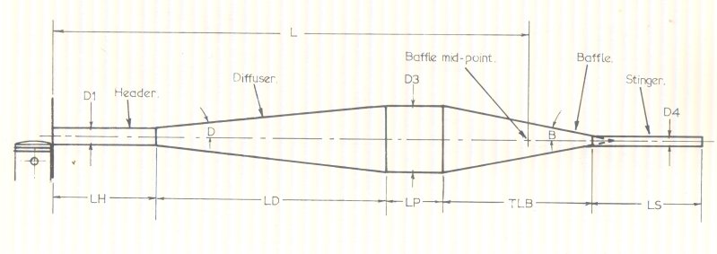

Some are probably wondering what "L" is its the length from the face of the piston to the mid point of the rear cone or baffle ...
