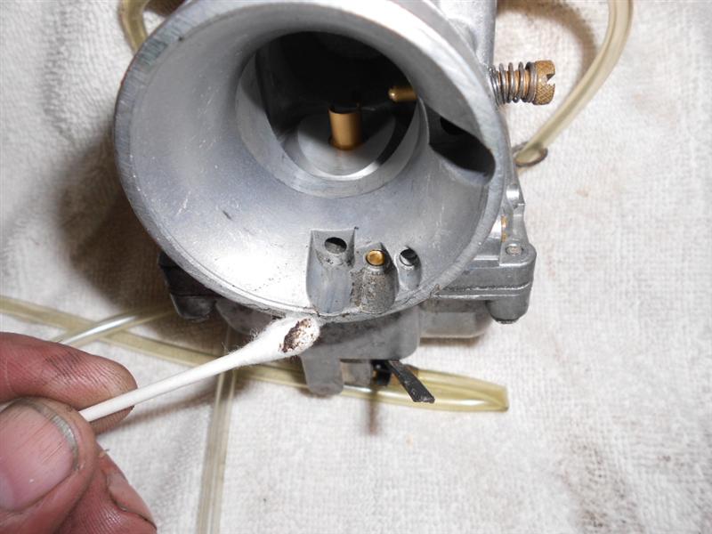

more pics...
File comment: this is what I rubbed out of the boot... I am hopeful the fact that the rubber carb boot flows up hill and this crap didn't get to my motor (( Internal Combustion Engine ? ))???

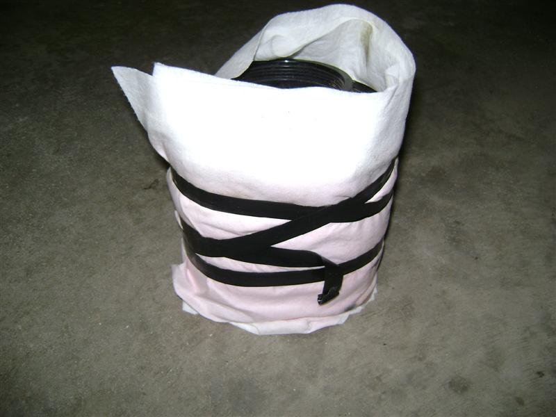

Here is a cleaning tip for you wrap your filter in paper towels for a few days before you wash them the paper towel will suck out most the K&N oil making cleaning much easier.

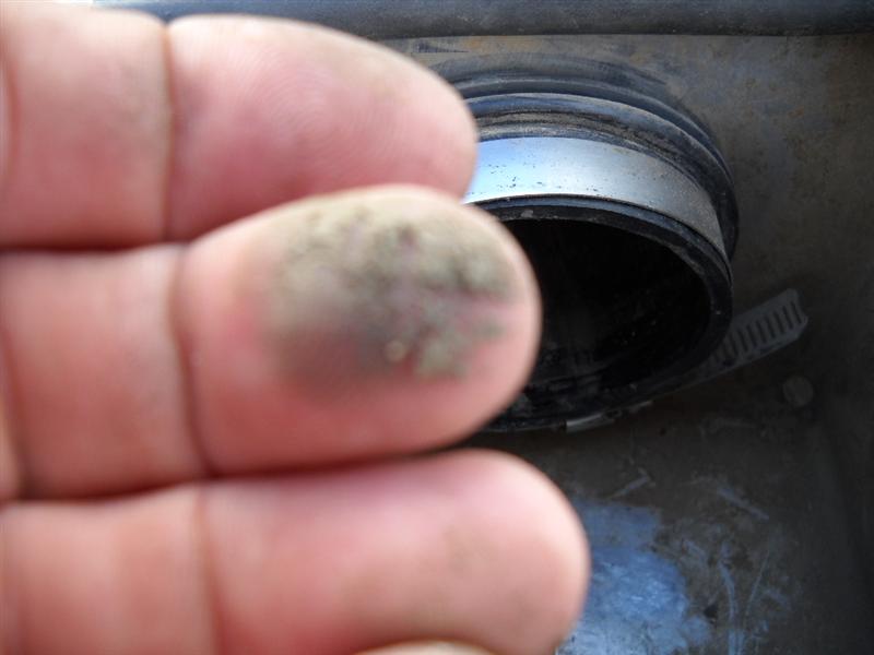

PostPosted: Mon Oct 22, 2012 8:05 am
my K&N after 45min-1hr use
cleaned and oiled like K&N recommends
inside the intake boot between the filter and the carb
PostPosted: Mon Oct 22, 2012 5:48 pm
Posts: 22616
Guy selling that open element filter kit thing is creating a bunch of victims I wonder if he has a clue what his profiteering is doing to engines, that filter setup might look appealing but its a POS a show item at best.
Insult to injury is when anything passes that filter its sucked and shaken right into the Engine by the funnel he created, even the Honda stock airbox has this flaw built into the deign, Honda corrected this design flaw on the Pilot air box by mounting the filter horizontally, this helps reduce the amount of dirt or WATER that can fall directly into the Engine by gravity, of course running a prefilter setups reduces the ability for contaminates to reach the inside of the air box by about 99% :-) viewtopic.php?f=1&t=8929&p=79765#p79765
PostPosted: Mon Oct 22, 2012 9:48 pm
And that's why I bought an air box
He needs to make a new one that will take a foam filter with an dust cover on it
