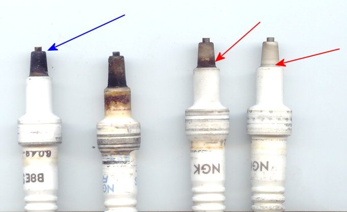

Here are some old plugs I cut the metal off of to expose the porcelain
The plug on the left is way too fat you see black on the tip your jetting is
way off you need to lean out your air/fuel mixture the second plug is
also too fat but you notice the black only goes up about 1/2 way then
it is dark brown the 3rd plug is what I call normal but the smoke ring at
the bottom is still about 2 x wider than it should be the tip is almost tan,
if this was my plug I would lean it out some more, the far right plug was
not run long enough to really read but you can see the smoke ring at the
bottom starting to form (tip or red arrow) depending on the old plug I
would not panic and continue to run this plug with the current jetting to
see if it turned black or tan closer to the tip , when your jetting is right
that smoke ring at the bottom will be about 2x wider than you see in the
picture, the rest will be real light tan, this is safe, during race conditions
all white with the smoke ring at the bottom is ok, I have run this way
many times.

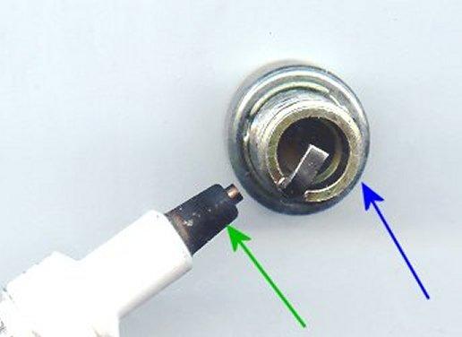

Here is another view of the plug on the left, you can see that area the blue area
is pointing to has no color, looks new it is running so cold from a rich mixture
it wont change color, green arrow is pointing to the black unburned oil that sticks
to what is hot, the porcelain is hotter than the bottom of the threads.

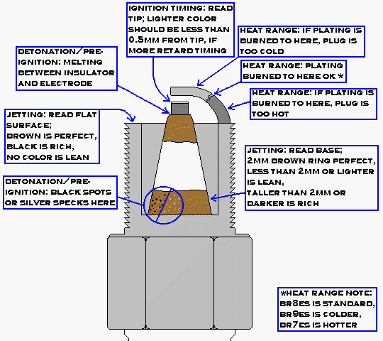

More info on reading the plugs

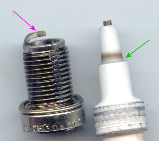

Here is a new plug run for about 1 mile at high speeds, see the smoke ring but
nothing on the tip, pink arrow shows where the coating on the reach is burning
back . Jetting is a little on the rich side.
