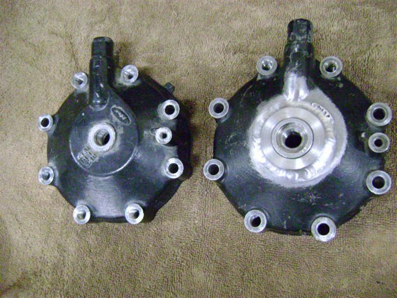

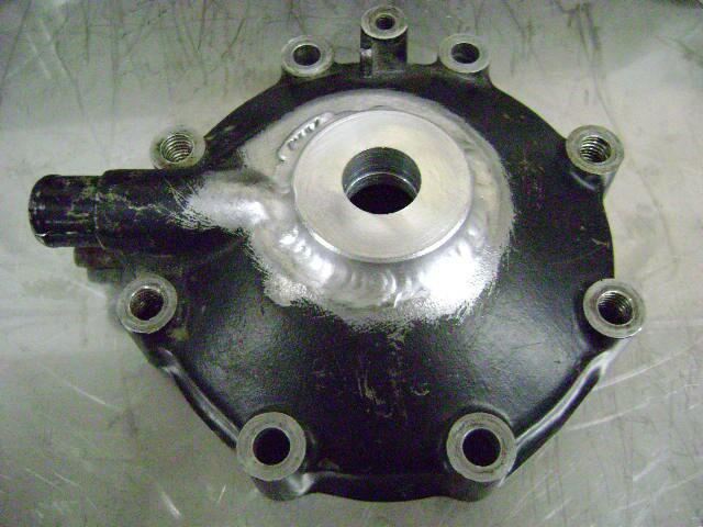

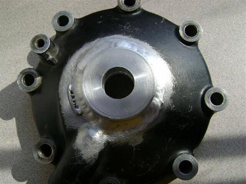

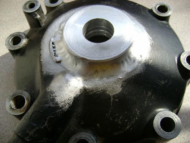

PostPosted: Tue Aug 28, 2007 5:02 pm
Update, Just got the one head back from my buddy Pete he took it to work and welded it up, I will try to machine it up tomorrow.

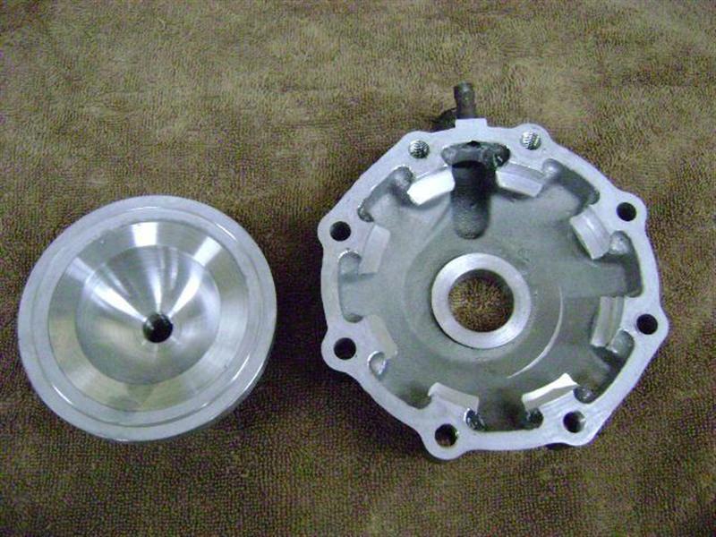

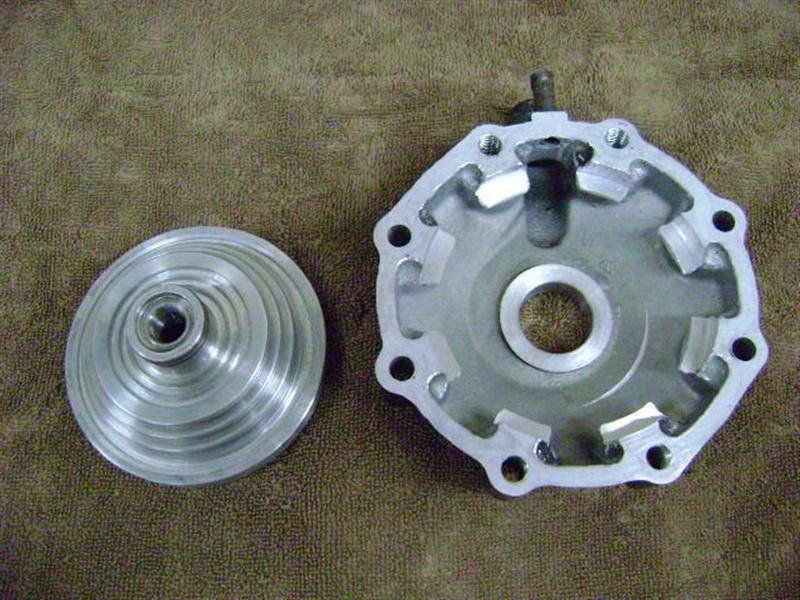

PostPosted: Fri Aug 31, 2007 9:29 am
I finished the machining and its ready to install.

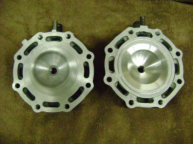

PostPosted: Fri Aug 31, 2007 9:31 am
Next to stock head.

PostPosted: Fri Aug 31, 2007 9:32 am
Using a modified 47cc dome and a stock head gasket it yields 170 psi static compression on the wifes Pilot.

Yes it is one of my old experimental domes, I had to modify it to work with this head, I reduced its thickness so it cant be reused in a cool head.. I think I have a way to avoid this for most stock heads, this one was cut way down on its gasket surface when I received it, much further than I think you will see most stock heads that have been modified.
I still need to install it on my wifes Pilot with a fresh head gasket then I will pressure test the coolant loop for the head and cylinder to make sure no leaks then fill with coolant and test run, heat cycle a bunch of times etc.
