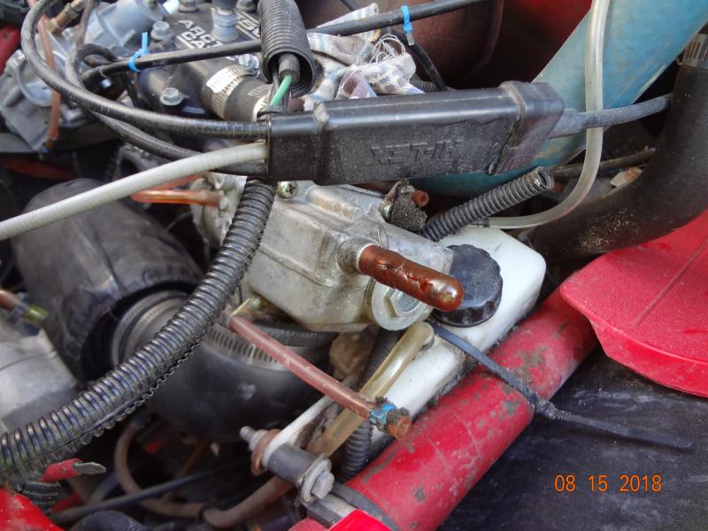

Spent the weekend sorting out an idleing issue,that is would'nt idle cept for manually increasing throttle.
Something not right and initially thought ASSumed was the main cable mighta slipped back a bit.
The idle was like a real lumpy cam. :shock: Then after a bit,a splurge of fuel rained down from under the carb.
Checking showed that the OEM ACcarb drain tube had let go,all cracked up and split.
So ASSumed that was my prob? Lucky it let go here home instead of on the race track or beach wherever.
Made up some std fuel hose and plugs from cutdown SS allen key bolts,for longevity reliability sake.
BUT still had the idle prob!
Noticed the mag side carb idle screw would up the tach readings but not the PTO carb idle screw...WTF!
Then took off the fuel supply hose to veryfy fuel to carb spigot,and was OK.
Then pulled carb off and bowl to check,and no fuel in bowl...Eureka! Must be stuck float,and it was.

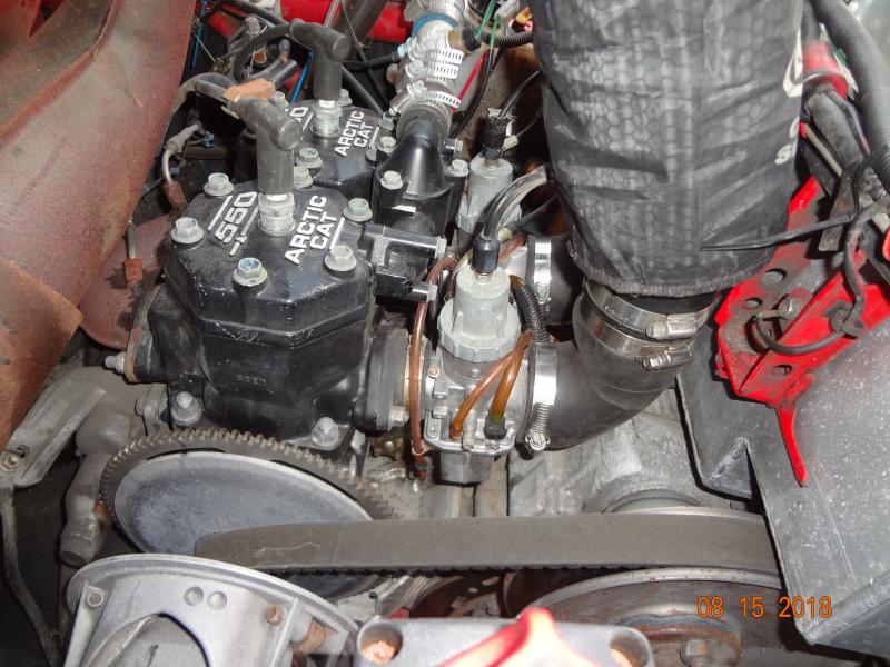

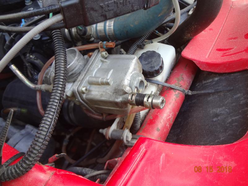

So serviced the carb,blew all the carb holes etc. Had to make a locking plate for the choke main screw as it had none.
Manual shows a D shaped plate under main choke screw down.Had some scrap polished S/S kitchen flue to make one from.
Assembled all back on,hit the key and idled straight away,as my custom fuel tank being above the carbs primes the carbs instantly.
File comment: OEM drain tubes deteriorated.

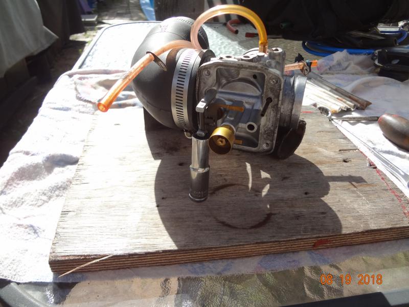

PostPosted: Tue Aug 21, 2018 3:28 am
So the motor (( Internal Combustion Engine ? )) was actually running/idling just from 1 cylinder.
Care needs to be taken when knocking out the float plate pin.
Used a long socket to support the carb pin structure from pin strike extraction.
PS...ASSumptions are STILL the Mother of all stuffups!
File comment: Supporting the tower.
File comment: New SS choke locking plate
File comment: Choke installed with new locking plate underneath.
