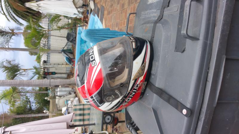

Yes I know it's a MX helmet, open face with overcap visor and why I'm changing back to the streamlined closed face.
No bobblehead here,just the ramair forcing the helmet backwards trying to rip off my head.
Was considering a small upper polycarbonate windscreen to front bars but I know that would upset the radiator cooling.
But I might as well trial that idea and see what the temp sensor sits at.

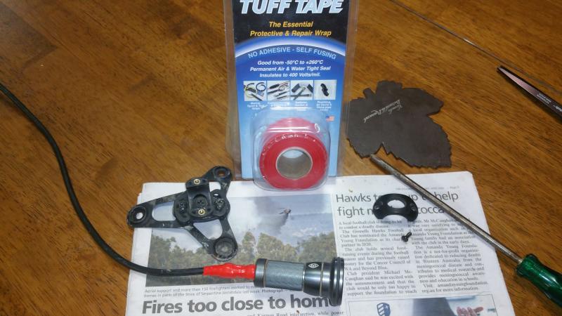

I just tried this new Silicone tape I bought for my 4wd camping kit.
Seems to have worked fine...next trip will tell.

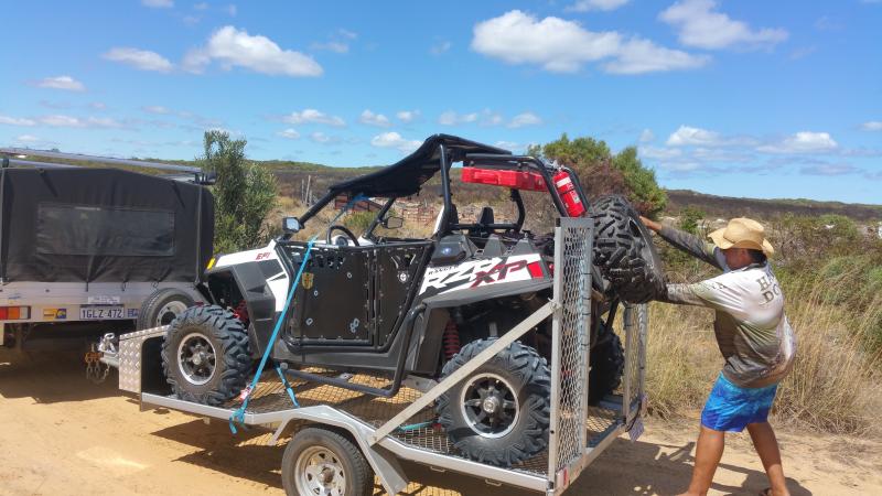

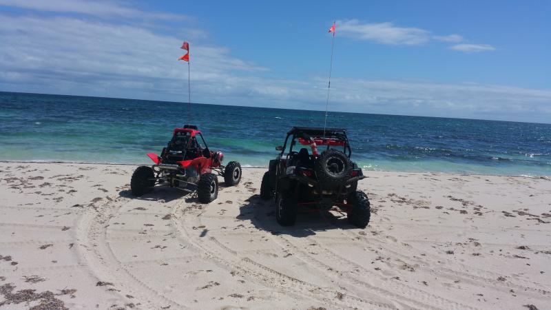

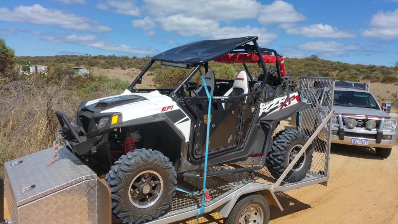

Had a balltearer time again at the sandpit on weekend.
But not my HellCam and RZRuss
After these pics taken we headed back up the beach N towards camp.
We were at speed and ride was bumpy from 4wd ruts crisscrossing everywhere plus the downward beach camber.I was behind Russ and to the LHS and he flipped it pretty bad.He was ok but not the rzr.Drove it back and the roll bar mounts from hoody area all outa whack.Doors don't shut etc.
Now we were looking forward to my HellCam vid but nada content at all...FK
Of all the times for it to shititself why now!!!!!!
Time for new HellCam...thinkin the new GoPro Max 360

PostPosted: Sun Mar 01, 2020 9:14 pm
Damn on footage and crash, what a beautiful place. Now that the nytro is your baby.. does the 800 ever see daylight? Glad he is alright, surprised tires stayed on rims. Picture of the RZR post roll?

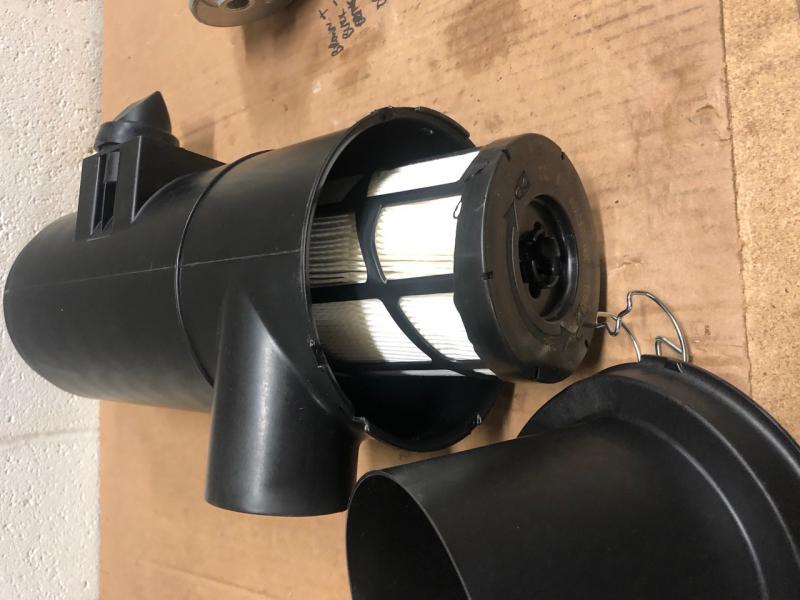

Swapping out the pod filters to a Donaldson setup today.
I'm sure it will be quieter too...but I do like the gutteral air inhalation. Like having a T Rex up ya clacker! :shock:

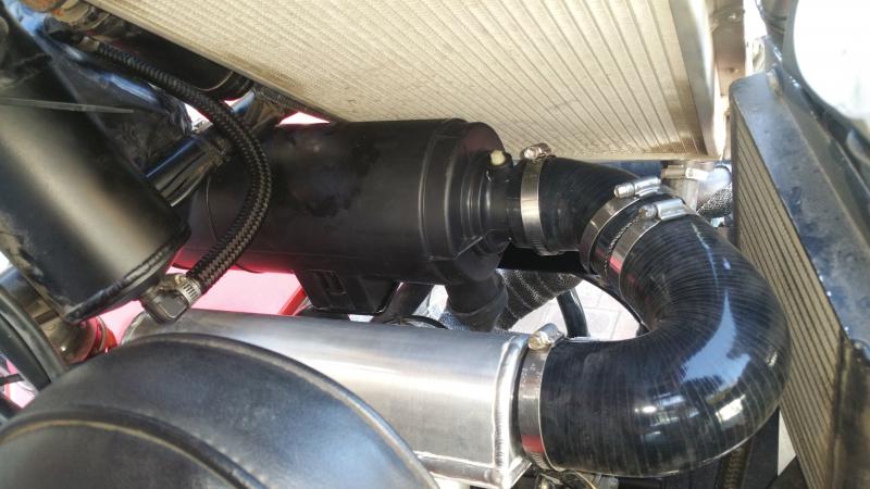

PostPosted: Mon Mar 09, 2020 7:39 am
Finally all done,the filter mount goes across the rear sideways and made from stuff I drag home and keep for 20-30 yrs just in case! :shock: Painted black to match and all looks better than it should? :-)
It all comes out as 1 unit / Donaldson and bracket housing by only removing the OEM 2 x T25 screws that hold the fender tops.

PostPosted: Mon Mar 09, 2020 7:42 am
Big filter system large outer with smaller inner plus the centrifugal effect.

PostPosted: Mon Mar 09, 2020 3:18 pm
very nice, and now you have the intake manifold to adapt to a turbo :-)
PostPosted: Mon Mar 09, 2020 4:58 pm
Have you tried it yet, does it breathe?
PostPosted: Mon Mar 09, 2020 9:28 pm
Persistent bugger...what took ya so long? :-)
I have same concerns Steve,the intake air now starts with a cyclonic then into a 45deg then a tight 225 into the manifold and finally down the banana runners.
The pods are the least restrictive but worst on filtering the crap that offroad and beach can dish up.
But my main priority is on the Nytro longevity.
I'm going back twe so hopefully will notice no seat ArseDyno difference? :-)

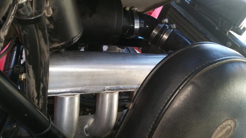

PostPosted: Fri Mar 13, 2020 7:48 am

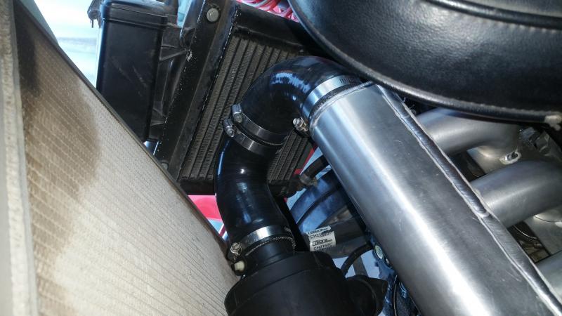

Well I decided to rejigger my 2 odd bend inlet hoses into 2 x 90deg.Should be more easier on flow.
All be known and tested this weekend...weather permitting.

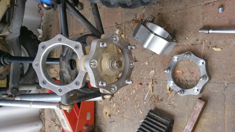

In the meantime I made up some 1"-25mm alu spacers.Used the 2 1/2" spacers that came with the Revolt as patterns.
Lots of drilling with an old Bosch drill press that uses a std drill clamped in as the power source.Very wobbly and like trying to do brain surgery with an axe! But tests your patience and techniques. :-)
Hardest were the 21mm hole clearance for the 20mm sockets.

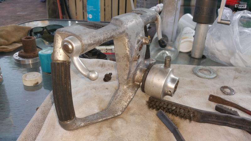

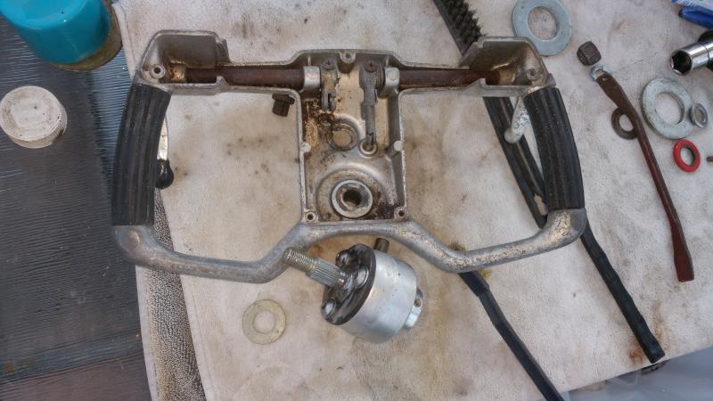

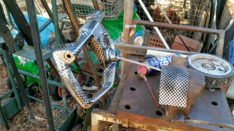

Made up the adapter for the FL250 yoke to Revolts quick disconnect.Tomorrow prep for some silver paint.Then onto the cable mod.More room in the cockpit plus easier leg access/dismount.Depending on later trials I might also install a steering quickener Howe 2:1 like I did in the Drakart
PostPosted: Tue Oct 27, 2020 1:27 am

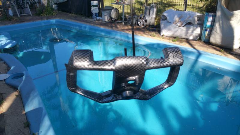

:-) Just an update on the steering yoke.
Tried out a new technique of CFibre painting.
Start with black gloss base coat.
Then lay an anti skid rubber mat with silver paint over.
Then finish with clear coat.Not easy with the varying shape of the yoke.
Now onto a Howe 2:1 steering quickener mod.
