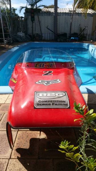

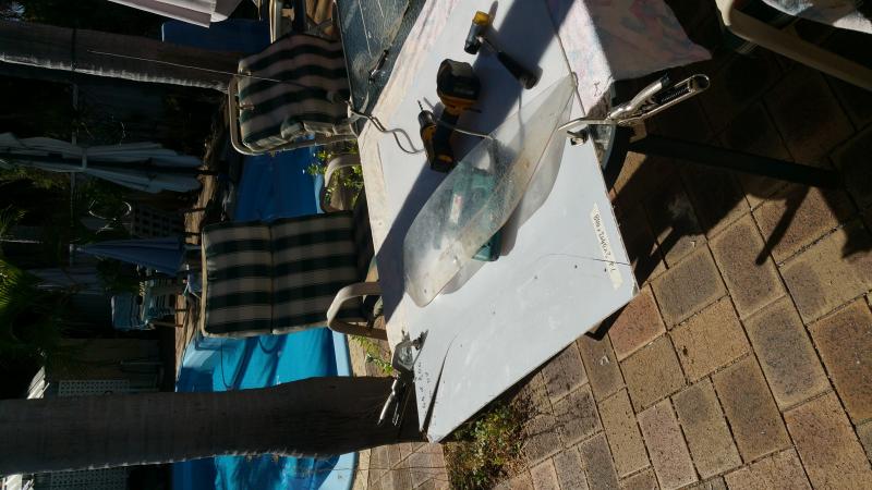

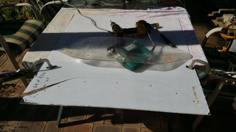

Been having windscreen bind :shock: so time for a new windscreen.
Bit hard to explain...but my arse is telling my eyes that it's not all comfortable down there with my driving. :-)
The old Polycarb screen I made for racing yonks ago has seen lots of roost from 200HP BarraCudas,Piranhas,homebuilts etc racing at speedway and knockout events.
So replacing the ol 4mm thick with 3mm thick polycarb,easier to bend and fix.
If any of you guys ever do similar,don't use plexi,or acrylic clear etc.It's not as high impact as polycarb.
Polycarb is used for police riot shields,ice hockey protective spectator screens,fighter cockpits,bulletproof glass etc
Easy to bend and does'nt shard crack.

PostPosted: Sun Apr 15, 2018 10:30 am
Still best to use some heat on the bends.Would'nt recomend a heat gun as gets too hot too quickly.
I just use a mullet dryer.

PostPosted: Sun Apr 15, 2018 10:43 am
Cuts easy with fine tooth jiggysaw blade,and std metal file the edges.

PostPosted: Sun Apr 15, 2018 1:56 pm
I used that stuff for my formula race car window. But over here it's called Lexan MR5 or MR5000 I think it was called. The MR stands for mar resistance. The standard plexi glass scratches real easy, even if you wipe it with a clean rag. One wipe and you got scratches right across. The Lexan MR5 don't do that.

If you use a very high grit wet and dry say 800 then 1200
that will take the saw cuts out.

PostPosted: Sat Apr 21, 2018 11:25 pm
Udo that sheet you use is great stuff,BUT only in flat applications,won't take the bends due to it's protective coatings.
Stixy course I do...don't you? :-)
Ed thanks,use the std type polycarbonate sheet so it takes the bends,the MAR won't,only used in flat applications.
