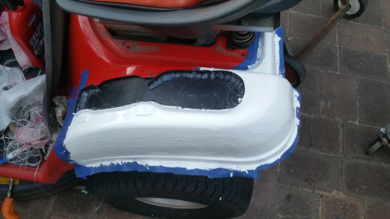

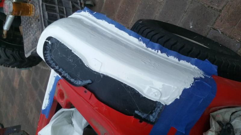

Well for the sake of forum content here's what I did over the weekend.Made a FG mould from my good Cox for the others repair.All went well and came off free of trouble.Used only Canauba wax for release agent.

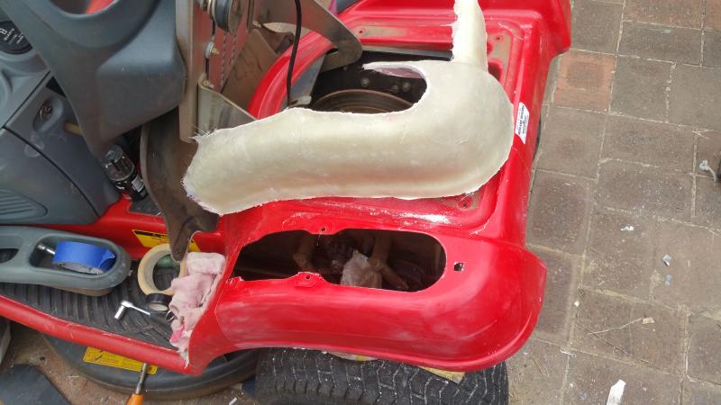

I popped out the cast fender bit this morning.All went well and came out a lot easier than anticipated.Mainly due to some added insurance in PVA release agent over the canauba wax.
It's not perfect but good enough for this ol mulletman!

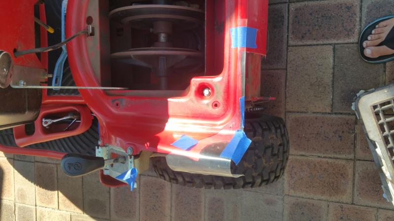

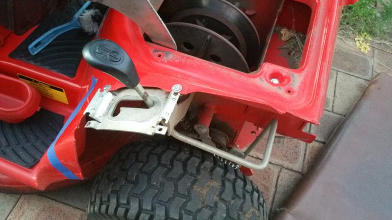

Then had to figure a way of mating the 2 as best as possible.
So I used my ol vinyl trick.VAD.Vinyl Aided Design.
Better than CAD-cardboard aided design.
The see through vinyl template is way bettererrrr especially when you have all the curves and profiles to mate up.
The vinyl being flexible contours to the shape and easier to mark unlike cardboard.

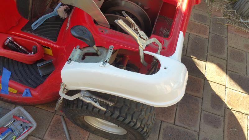

Fitted it up and hit it with some primer just on dark ready for paint tomorrow arvo.
