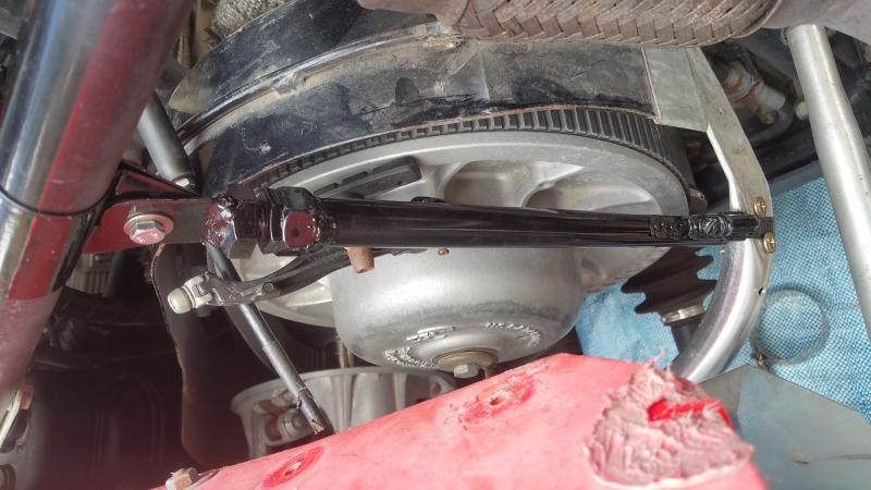

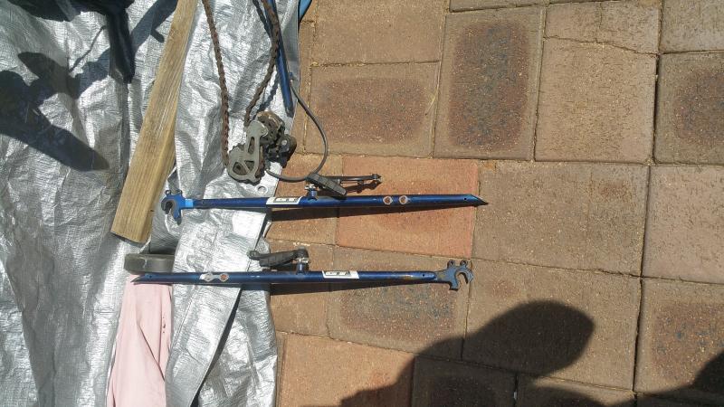

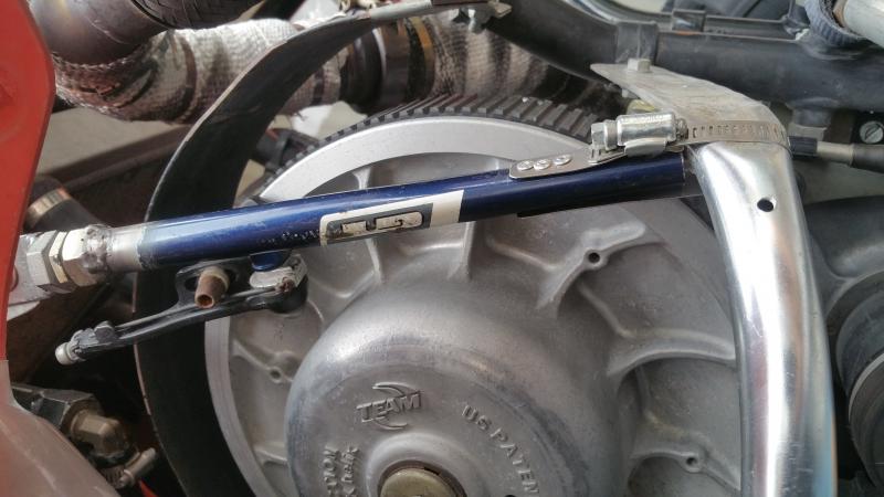

Hey Thrillseekers...yep another one.
This time cutting off the whole rear brake caliper with wheel fork.
Must easier and quicker way and utilising the multi spring adjusters for the lever.
Just cut to length,make an upper tube wrap around clam bracket.Weld in a nut for bolt length adjustable with locknut.Bottom used a cut SS hoseclamp fixed to fork tube.
Then had to drill out 7/8 hand brake mount to 1" hole to fit gear stick tube.
Works great just need to buy and mod new cable tomorrow when shops open.
PostPosted: Tue Dec 14, 2021 1:02 am
Bought a new inner wire for my used outer cable yesterday then fitted it all up and did the necessary adjustments and all works great.Only $7.My main cable has an inline screw adjuster long screw as well as the std ones at each end.
Now it stops with only 10mm 3/8 of lever pull off the FNR gear stick hand brake.Zero grinding.woohoo result!
