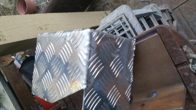

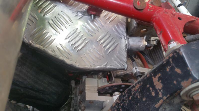

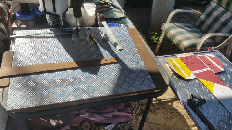

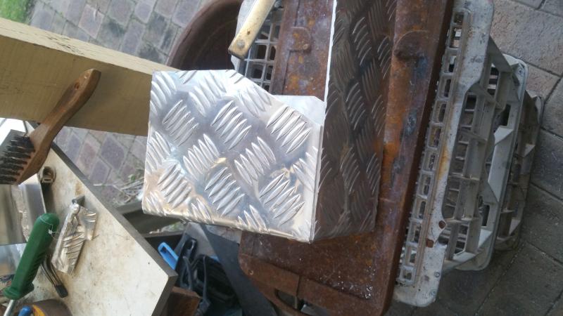

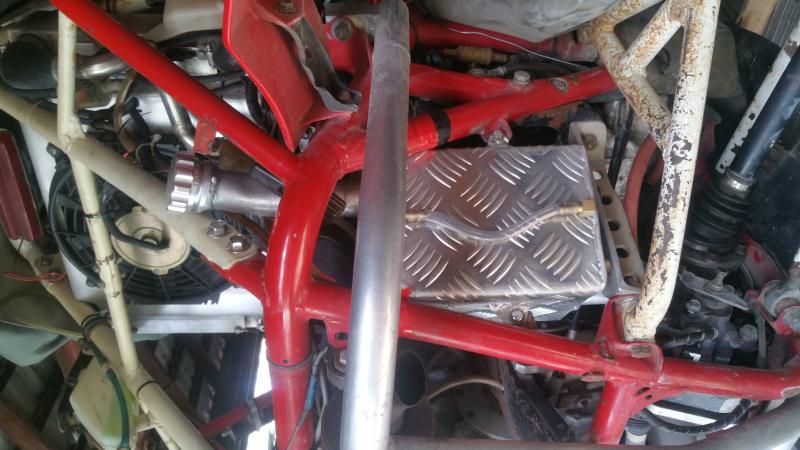

Burnin n learnin...needed another alu mig project so it's a reserve fuel tank to fit in where Ak had his battery mount.Last time out camping mate TaxiTrev run outa fuel on the upslope of dune sand only 250m from campsite.
I relocated the battery to the f,ront for racing,so that vacant area now can be the reserve tank.Also I've utulised the 2 rubber grommet mounts still there and 2 threaded chassis brackets.Made 2 alu locater pins from 13mm alu rod turned down to 10mm on my pedistal drill and large metal file.My mig alu is still rough but doesn't leak so that's a win yeah. :-)
