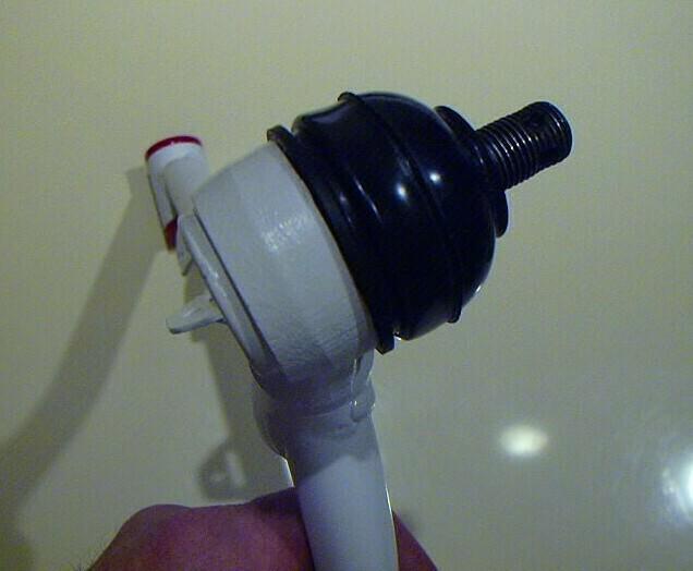

I tried installing the replacment boots (Honda number 53546-611-310 ) using saftey wire, zip ties and the spring clamp ideas previously brought up with no success, the boot would just slip of the narrow seating lip when the joint was swiveled around. I tried it with the spindle attached and it still didnt work.
I had just about given up when my wife walk into the garage and asked what I was doing. I explained it to her, like she would really understand. As she walked away she said "why don't you just super glue it on".....of course, I laughed and thanked her for the great idea....I think I got a "fine, if you don't want my help, don't ask any more from her.
Well after two or three more attempts mu way I figured what do I have to lose....beleive it or not I used a little Loc tite quick tite glue and I cant pull this thing off.....
Of course this hasnt been field tested but the boot is on there very well and I don't think it will come loose.
Now the big question, should I tell my wife she was right???? I hate it when she does crap like this....

I packed greased in the joint before I installed the boot. I also put grease up in the top of the boot away fromt the joint. Then I cleaned the seating area of the boot and the joint.
I don't think you could grease these after you attached the boot, it is sealed air tight around the stud.
If you do this don't forget to "burp" the boot while attaching the boot. I think it would burst the boot if you leave any air in there.
I think I will add a samll zip tie around the boot before installing jus tto give it a little extra support.
The other idea I had was to cut a thin slot around the outer diameter of the sealing lip with a dremel. I have some small cut off bits about a 32nd thick. I though with this groove you could use the zip tie and the boot would grip the slot. If the super glue doesnt work that will be my next option.
I couldnt find a radiator clamp thin enough, but I don't think that will work, the boot just doesnt have anything to grip to. The sealing area is machined smooth.

The base of the original boot is sort of like a grease seal, it presses on a machined rim around the base of the ball joint. The top part seals air tight around the stud ( a good thing,if air cant get in or out neither can water)
The replacement boots that Hoser mentioned are the same as the original on the top around the stud but the base is not set up to press on, they are held in place with a clip or ring of some sort. This is where the problem was, there was way for the base of the boot to seal on the joint, thus the attepms of the zip ties, saftey wire etc.
I have since installed all 6 (4 front 2 rear) boots and everything look good. For the rears there are actually 2 seating areas, these boots fit the larger one.

Scratch the energy suspension replacement boot. only way to secure it to the arm is to glue it and I don't think it will hold long if at all.
I have concluded you will have to get a replacement boot the comes with a groove in the boot & the wire spring/clip that secures it.
Only way any thing will stay on the stock arm is to cut a small groove around the base of the shoulder of the stock arm. this will give the spring/wire clip a place to rest. The smooth stock shoulder wont hold anything on.
No groove,no work.
Someone prove me wrong ,please.
