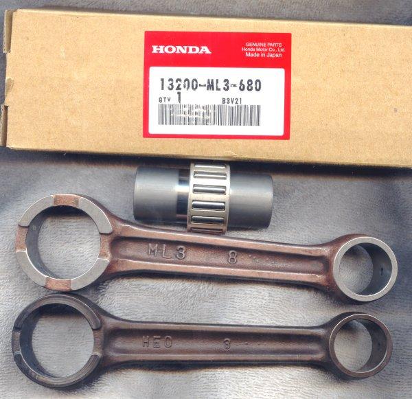

For years I have been told that there is no CR 500 rod available from Honda
you have to buy the whole crank to get one, once again I find out those that
think they know what they are talking about actually don't know what they
are talking about, once agian their flamboyant writing style cant cover up
their error, here is the Honda CR500 Rod kit part number.
I bought this rod as a Pilot replacement, rather than just blindly sending my crank
out and have the CR500 rod installed as others have advised me I decided to
just order the rod and see what all the hoopla is about, rumors about there
being one more or bigger bearings on the big end of the rod are just not
true, I found this out by laying the parts in my hands not by taking someone
elses word for it then spreading it all over the internet.
Here is what I found.
First I took the old 400 rod and the new 500 rod to the post office and had them
weigh them on their scale, the 500 rod weighs 10.6 ounces the 400 rod weighs
9.0 oz the 400 rod is a full 1.6 oz less than the 500 rod.
The 500 rod is 4mm wider on the small end.
You cant use the 500 bearing in the 500 rod when using the 400 piston.
Distributor Part Number(s):
Western Powersports #: 421-8139
Parts Unlimited #: CR166
Tucker Rocky #: 162280
Marshall #: Nov-58
Southern #: HR008139
Advantage Performance #: 19400-07
OE Part Number(s):
HONDA: 13200-ML3-305
HONDA: 13200-ML3-680
HONDA: 13300-MAC-680
HONDA: 13300-ML3-910
HONDA: 13300-ML3-911
For Models:1987 - 2001 Honda CR 500R
Technical Specifications:
Big End Bearing (mm):26x34x20
Big End Bore (mm):34.00
Big End Width (mm):19.75
Center To Center (mm):144.00
Pin Diameter (mm):26.00
Pin Length (mm):67.50
Small End Bearing (mm):20x25x28
Small End Bore (mm):25.00
Small End Width (mm):23.98
Washer Thickness (mm):1.5

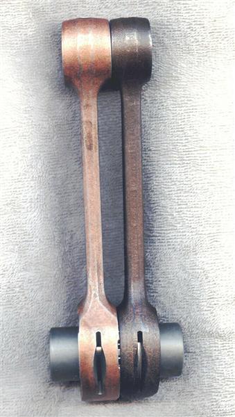

PostPosted: Sat Oct 16, 2004 6:22 pm
In this picture you can see the width difference.

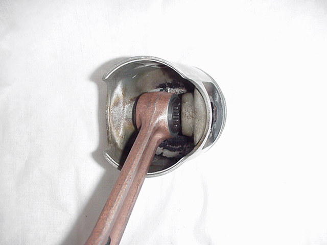

PostPosted: Sat Oct 16, 2004 6:25 pm
The 500 rod with the 500 bearing will just not fit the 400 piston.

PostPosted: Sat Oct 16, 2004 6:43 pm
IMO if you don't have the CR500 modification or are running a CR500 big bore kit when you
replace the rod on the crank you should be installing the 400 rod as a replacement, there is
no doubt that the 500 rod is a stronger and heaver rod but I see no need or advantage in
using the 500 rod (adding weight) I have never seen a 400 rod break I am sure they have
it just does not seem to be something that happens enough to seek out a stronger rod,
I have never seen a small end of the rod break or even have a bearing failure, I am
sure they have failed but I bet it was due to someone reusing the old bearing during a
top end rebuild, when I remove mine they look new and have no measurable wear,
they are tempting to reuse but I install new, there is less side clearance with the small
end of the 500 rod in the piston this might even limit or reduce the ability for the small
end bearing to receive lubrication and actually shorten the small end bearing life because
of the extra rod width shrouding the wrist pin and bearing.
1.6 ounces of weight don't sound like much weight but try moving 1.6 ounces up and down
80mm 133 times a second, I bet after a few minutes you would not want to carry the extra
weight, I see NO advantage only disadvantages in installing one in the 400 Engine, I would
say if you had a 500 conversion you need to run it, a common mod is to reduce the reciprocating
weight of a Engine, Engine builders will lighten the rod and remove excess weight (grams)
from the piston to increase performance and extend it life (piston speed VS mass) so I might
install a 400 rod in my CR500 conversion and see how long it lasted, what I have seen fail the
most on the 400 rod is the bearing, I have never seen the big end of the rod break not to
say it has not happen I just see the weak part as the bearing and the bearing is the same
the 400 uses.

I think Bigtom has a 500 piston perhaps he could snap some pictures with the 400 and 500 bearings
and measure the width between the pin boss?
